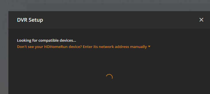

            johnpoz LAYER 8 Global Moderator @wyzard
            @wyzard said in Plex and HD Homerun:
            Plex doesn't see it when trying to add automatically or manually.
            Well whats the discovery protocol - prob uses some multicast/broadcast BS... They try and make things simple for your typical user that has 1 flat network.. While breaking shit for more complex networks..
            I just told my plex to look for a dvr, and its sending out broadcasts on port 65001 UDP..
            And then if I put in a manual IP... It does the same thing, and not seeing the directed traffic to 65001 still only broadcast to the .255 address..
            https://forum.silicondust.com/forum/viewtopic.php?t=21009
            Not sure why it would not just send directed traffic to the IP you put in on UDP 65001? All I was seeing was broadcast trafffic.
              Ah, well that's fun. 🙄
              At least they allow you to enter an IP which is more then many. Not much help if it ignores it though!
