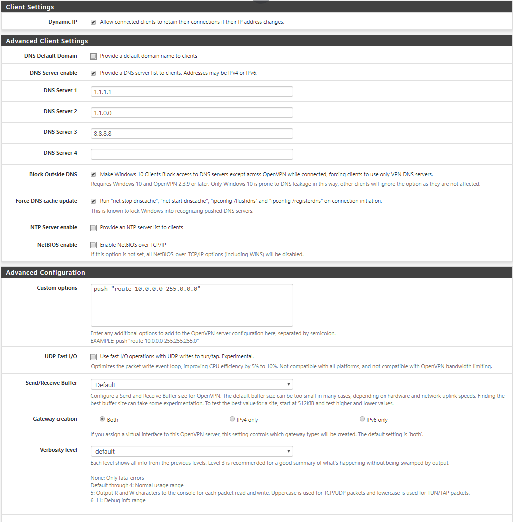

      hi everyone, I have successfully created a ovpn tunnel (tap) to my managament lan. I can ping, ssh and web admin all devices except for pfsense itself.
      when connected pfsense can be pinged but the web gui doesn't want to cooperate. neighter via port 80 nor port 443.
      The openvpn client gets the correct ip from the dhcp server on the mgmt interface and as far as i can tell routing works correctly. The only difference between beeing on the mgmt lan and connecting via openvpn is access to pfsense's web gui.... I'm sooo out of ideas.
      My config is as followed:
      According to a tutorial I assigned an interface to the openvpn "network port" and bridged it with the mgmt interface.
      I do have a tun ovpn server configured on the standard port for testing reasons, which is able to connect to pfsense.

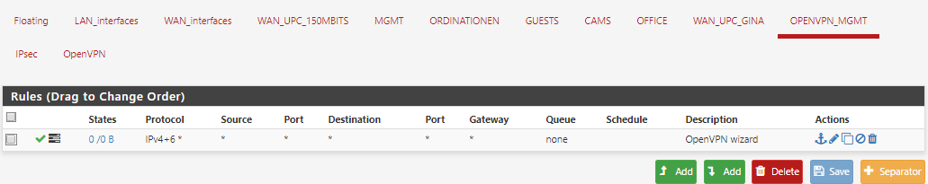

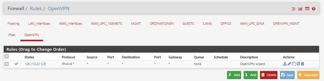

      FW rules are as followed:
      In regards to the fw rules: I do not understand why the openvpn_mgmt interface (which i assigned) doesn't see any traffic. Might this be the issue?

        Your assigned Interface doesn't see any traffic in Rules because the OpenVPN Group Tab is processed first and hits your any-any Rule.

          Shouldn't the (one of the) any-any Rule(s) you mentioned make sure that traffic comming from ovpn can do pretty much anything it wants?

            Disable the Rule in your OpenVPN tab to make your Interface Rule active (which should not make any difference for this problem tho).
