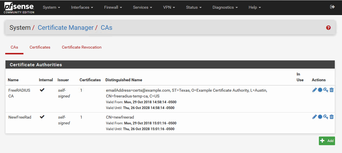

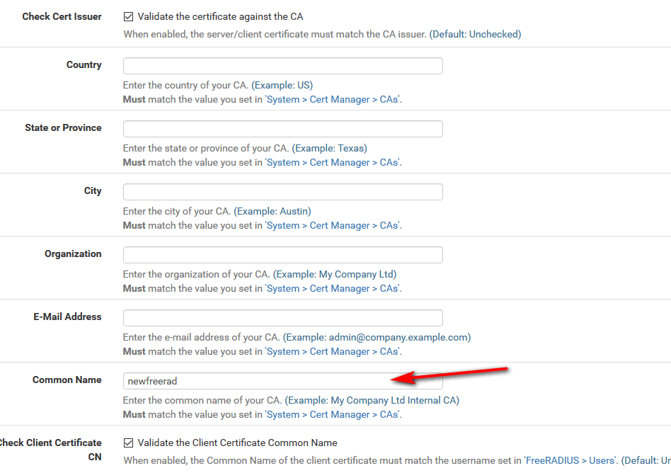

      Ok so when installed freerad it put in its own CA and server cert.. I just created a new one.. And free let me just leave the stuff not using blank.. And didn't throw any errors
      • johnpozJ Online
        so far dude not having any issues. Just installed cert signed by CA in my phone without any problems - nothing has any emails on it.

            I won't be able to test it until get home.. But can install the cert, and freerad didn't complain about the CA with only putting in the CN.. Left all the other fields blank.

                  Have no idea why you say it doesn't are you saying freerad throws error when you enable it - or that you can not auth?? I can not actually test until get home... But freerad doesn't have any problem with me turning on the CA and just putting in its CN.

                            edit: Ok yeah this seems to be something with the freerad package.. .Its pulling info that is not there
                            Oct 30 03:10:28 	radiusd 	28048 	tls: Certificate issuer (/CN=newfreerad) does not match specified value (/C=US/ST=Texas/L=Austin/O=My Company Ltd/emailAddress=admin@mycompany.com/CN=newfreerad)!
