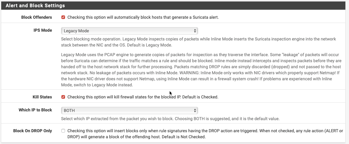

We have a pfSense 2.4.4 server running Suricata 4.0.13_9 (updated to this version today) which we have an ongoing problem with. We have set up Suricata in Legacy Mode, Block Offenders is enabled, and we have set up an Alias containing only IP addresses and subnets which is allocated in the Pass List parameter.
My understanding from the documentation and pinned posts on this forum is that in Legacy mode, this should be sufficient to prevent certain IP addresses from being blocked even if they cause an alert. However, the reality is that IP's that are in the Pass List are being blocked.

Once a Pass List is created, it must be manually assigned to a given interface on the INTERFACE SETTINGS tab. From the looks of your screenshot it appears you have done that already.
