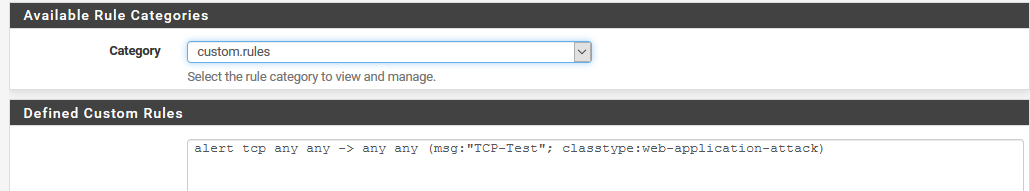

    I tried two different protocols as follows:
    alert tcp any any -> any any (msg:"TCP-Test"; classtype:web-application-attack)
    and same wit ICMP instead of TCP.
    I used the ping from Ubuntu VM to pfSense VM with the rule for ICMP set in the "Custom rules" in the WebConfigurator. The ping worked fine but no alert showed up in the WebConfigurator.
    Same thing, when I used telnet to open a TCP connection.
    I allowed all TCP/ICMP connections in the firewall.
    Im running out of ideas. Im totally new to IDS and haven't much experience with networks in general either, but really want to figure out, where the problem is.
    Maybe I've got a wrong syntax or similar in my rule? Or need to enable the custom rules to alert? Also some standard rules are enabled in suricata but it does not seem to me like there is a rule, which somehow "disables" my custom rule, all ET open /Snort packages are disabled.

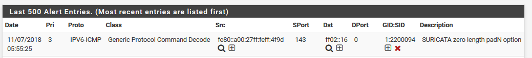

        I didn't know the packet capture function yet. It works fine. I can see both the ICMP and the TCP packages. The Interface is a LAN, thats correct, running DHCP (because i plan to add more VMs to this virtual network, once it works).
        In my alerts I find this: The IPv6 rule is one of the default rules of suricata if i got that right (Im not sure why it is sent, because only IPv4 should be enabled, but maybe its part of the "telnet" tcp command?). My custom rule is not listed.
        For me, it means that I got some mistake in my custom rules. Can I check anything to see if the rules are actually applied? Or maybe I got some mistakes in the syntax.
        That is how it looks like at the moment.
