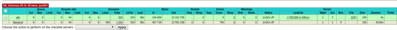

My "pfsense 2.4.4-RELEASE", has "haproxy-1.8.14", with two frontend for ports "80 and 443", until yesterday both were running, but now only the frontend of port 443 is UP, below some images .
Can anyone give any suggestions on what I can do?log when accessing http site

@wesleylc1 said in HAProxy Down with HTTP site [ 503 Service Unavailable ]:
Server HA_Sistemas-45-14_80-www_ipvANY/site is DOWN, reason: Layer7 timeout, check duration: 1002ms
Seems the webserver is slow to respond? (it takes more than 1 second.)
@piba said in HAProxy Down with HTTP site [ 503 Service Unavailable ]:
Do you think the problem may be without backend?
Yes it looks 'up' but with a health check time of above 900ms its not ideal. And might go down if load slightly increases. Perhaps a different 'status' page to check would be better than the default '/' url? Or the webserver still has issues?
Yes it looks 'up', but with a health-check time of above 900ms its not ideal.. And might go down if load slightly increases.. Perhaps a different 'status' page to check would be better than the default '/' url.?. Or the webserver still has issues?
Piter, hint to fix this problem?
@wesleylc1
Perhaps checking a different 'status' page would be better than the default '/' url.?. One that is faster?Or if the webserver has issues, fix them .. How? that depends on the issue ..
Or if the webserver has issues, fix them .. How? that depends on the issue ..Pieter, how can I set up a different status page?
