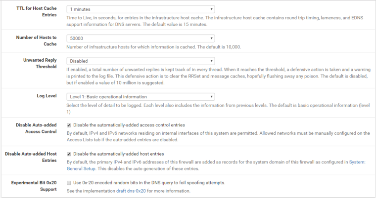

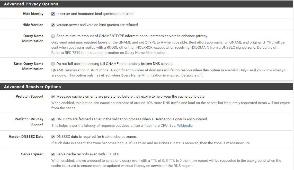

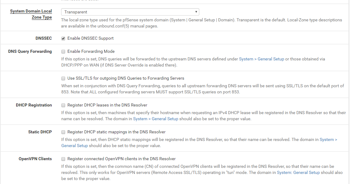

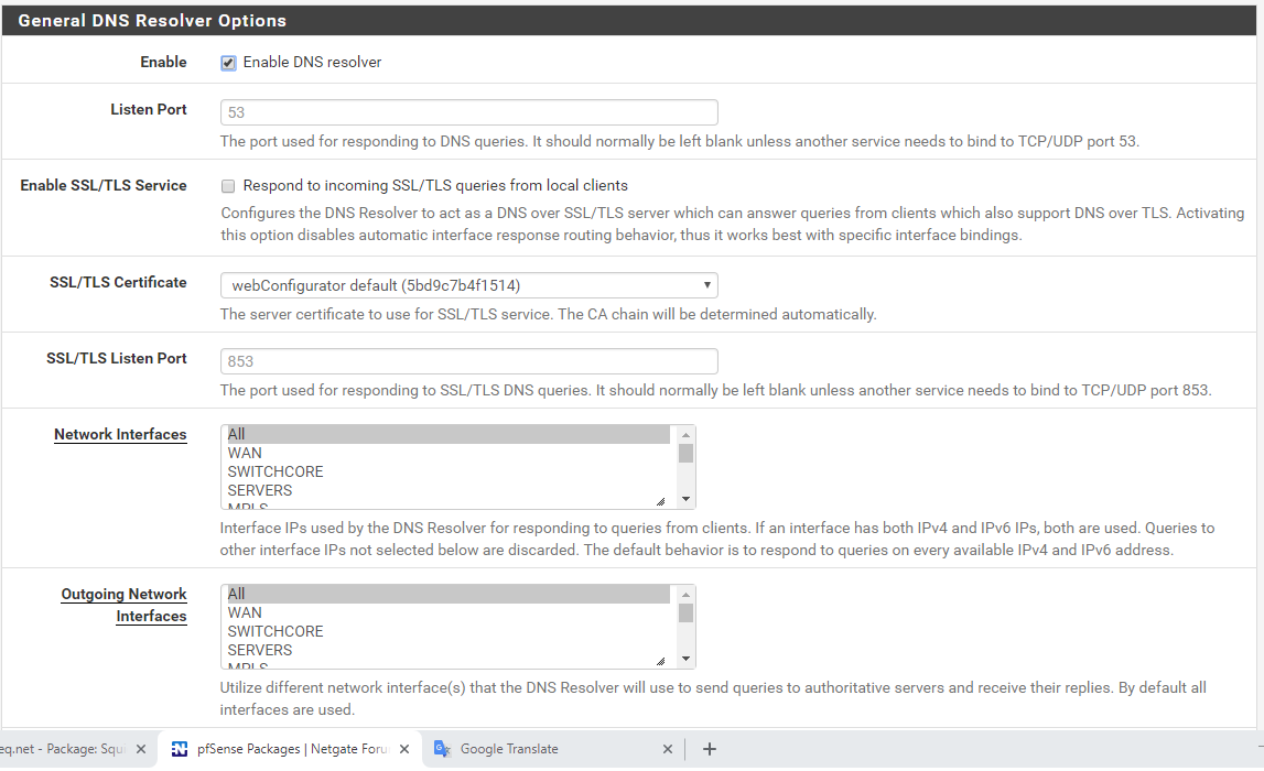

    I have installed pfSense 2.4.4 running squid, squidguard and snort, I have configured them, squid is currently configured on transparent mode, and so far it works... but my users get random disconnects from webpages such as gmail, and sometines they receive an error stating SSL_ERROR after this, they keep reloading the page and after a while they manage to access to the site, my pfsense is currently using DNS resolver... and I have configured 1.1.1.1 and 1.0.0.1 dns servers configured on the general configuration tab. any ideas for this issue?

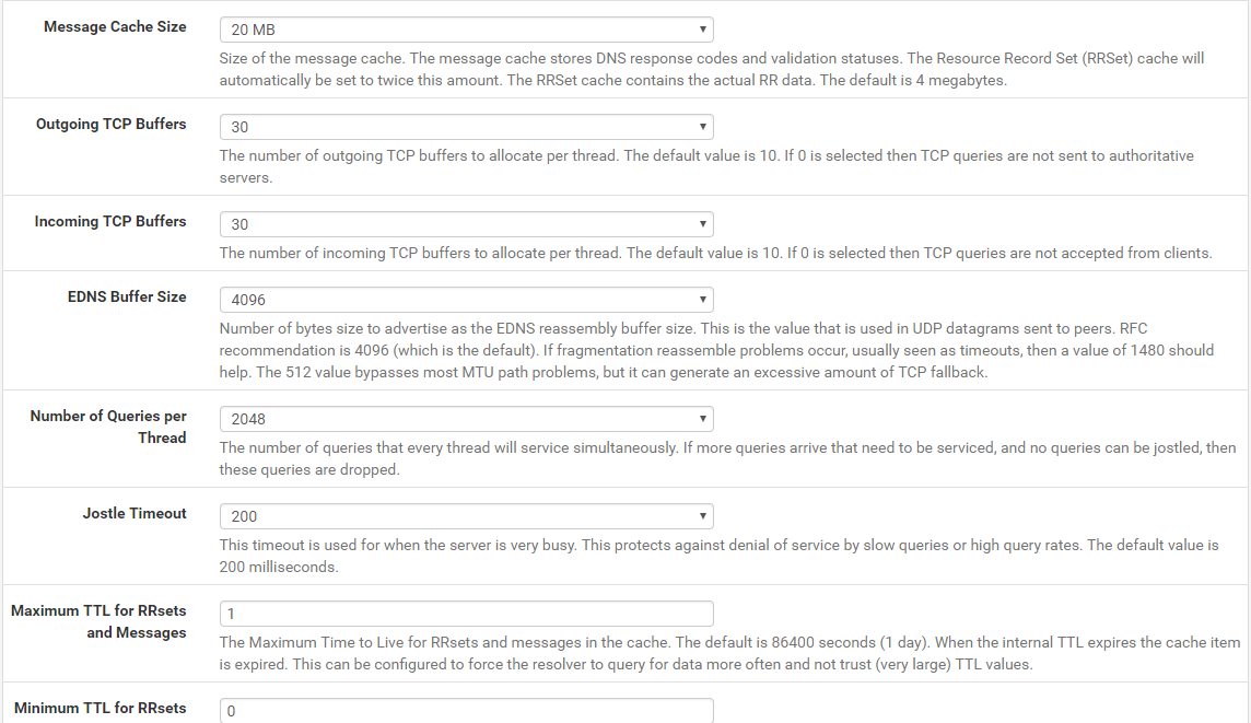

    I have configured DNS resolver configured this way:

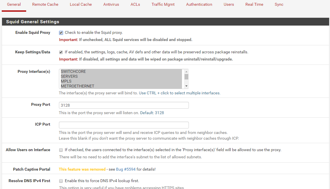

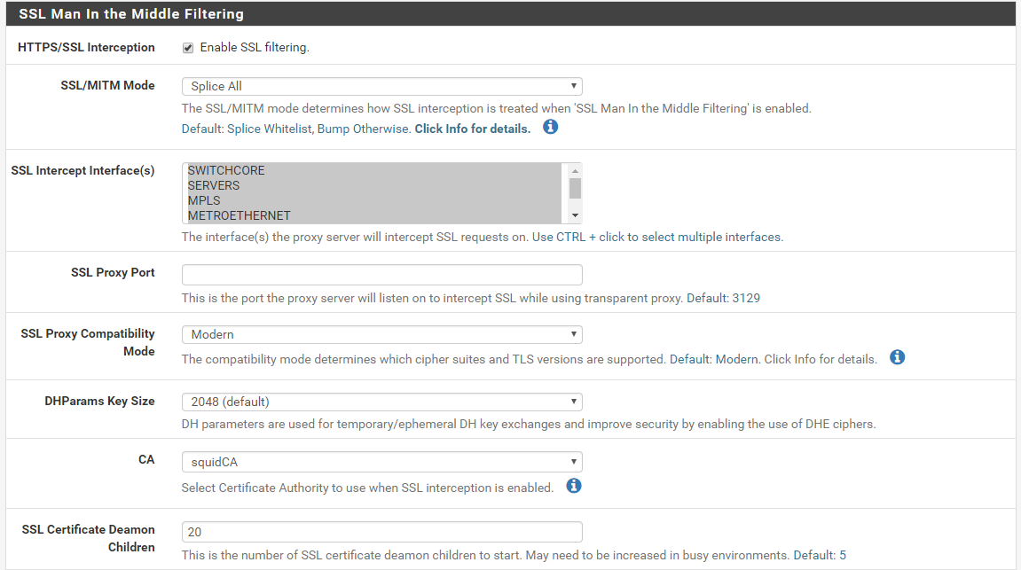

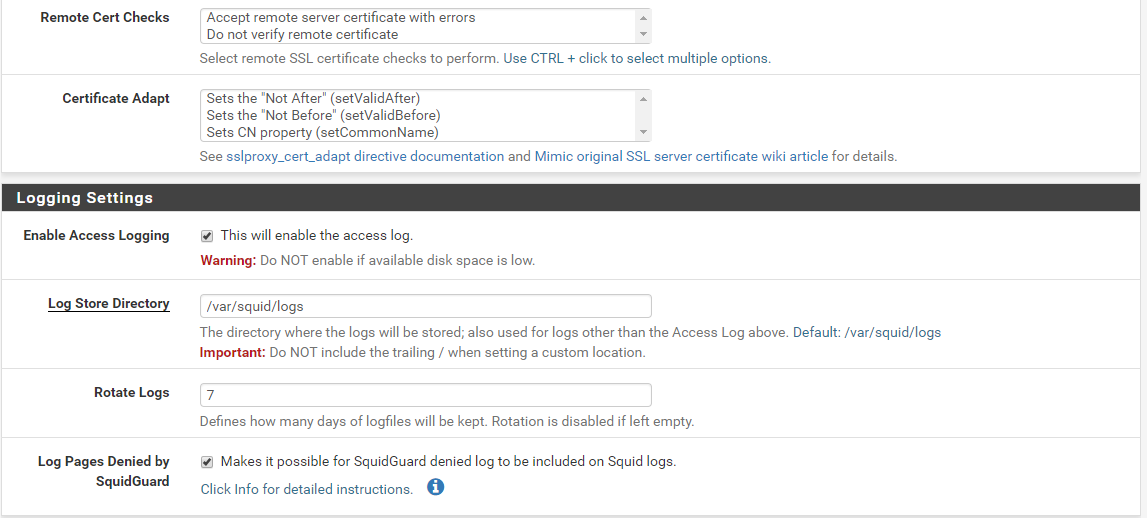

    and squid configured this way:

    On a separate note, I don't think you need 1.1.1.1 or 1.0.0.1 in the System > General Setup. You don't have forwarding mode enabled in Resolver so pfSense should still be the first option. That's a good thing. pfSense (Unbound) is going to generally be the best option for DNS resolution. That's my personal opinion, but I rather not use external servers. The main reason being security. External servers are much bigger targets for an attack. Privacy is another one. I don't care but some people who are also concerned about privacy avoid external servers. You don't know what they're doing with the information that goes to their DNS servers. Oh and it's not really going to be speeding up queries anyway. Unbound will be caching the sites you visit so the external servers will not be used for the most part. The majority of the time Unbound should resolve almost instantly from cache.
  • Yes I am using squid along with squidguard for web filtering and yes If I stop squid it works fine... with squid I randomly get issues like no DNS resolutions or the SSL_ERROR, I have deleted both DNS servers on my general and overrides on the DNS resolver, I will check how it performs

  • How many users in your environment? You are probably having an issue with a low number of rewrite & SSL child threads. Look into sslcrtd_children and url_rewrite_children which are configured under Services - Squid proxy server - General - Advanced Options - Integrations.
  • around 500 users at this time, I have SSL Certificate Deamon Children set to 20 and url_rewrite_children 64 startup=32 idle=16 concurrency=0

  • I have increeased besides I am currently using just 1 pc for testing purposes... and I still received error err_ssl_protocol_error, any ideas? :(
  • currently testing with just squid... squidguard is currently disabled, still getting SSL errors
