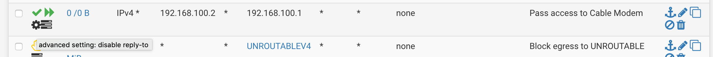

For what it's worth, for reasons I cannot quite wrap my head around, I also had to place this floating rule:
Disabling route-to makes sense to me. Disabling reply-to not so much.
192.168.100.2 is the VIP on WAN I am outbound NATting to as steve described above. 192.168.100.1 is, of course, the cable modem. Floating rule is on WAN in the outbound direction.
I just checked it again. Without reply-to disabled it does not work.

Disabling reply-to made sense at the time but I had to pcap it off the firewall to know to try it.
Yeah that would only matter if the modem was connecting to WAN.
I do block outbound RFC1918/Unroutable so I did have to carve out an exception for that.
