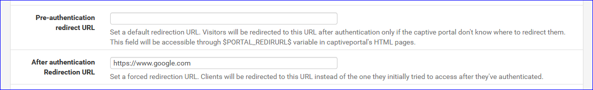

      Consider
      "After authentication URL", which I'm using for a long time now, does what it claims to do : after authenticatio users will see google.com.
      But the description of "Pre-authentication redirect URL" conflicts with the user manual.
      A "Pre-authentication redirect URL" will redirect visitors to this URL after authentication only if the captive portal don't know where to redirect them.
      I had to much coffee this morning, or not enough ?

        @gertjan said in What happened to "Pre-authentication ...." ?:
        not you...but others did, years ago
        what happened is that in 2.4.3 (and before) the description of "Pre auth URL" didn't reflected what the feature was really doing.
        This setting was used as "default URL" instead by the captive portal.
        as proof, you could see commits dated from long time ago talking about usage of Pre-Authentication URL ($redirurl)....after authentication. https://github.com/pfsense/pfsense/commit/adbb495cd692f3aeda39efddb15f02b6df46603f
        you could also see that since years, captive portal is redirecting non connected users to the login page without checking for pre-Authentication URL. the change seems to have been done 11 years ago : https://github.com/pfsense/pfsense/blob/65fbb3889680ae561f0d60c8038dbc1a737af0a2/usr/local/captiveportal/index.php#L59-L61
        before this commit, I don't see any mention of /index.php?redirurl= ....meaning that it was possible before that to redirect an user to other places than the captive portal login page
        anyway, this setting was very misleading for me, I took quite a bit to understand what could it be used for....so I updated its description, that's all. there is no behaviour change of this setting (unless I made a mistake of course).
        it's entirely possible that I missed something, though. i am going to re-check carefully the behaviour of Pre-Authentication URL in 2.4.3 in the next days, to make sure there is no change.
        maybe we should think about updating the docs ?
