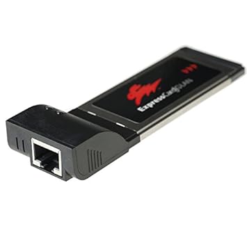

                                  I also try to play around with laptop, and four usb nics trought usb 2.0 hub, it's working but no prformance at all, better deal with vlans and managed switch can handle gigabit port of laptop on board and or additional PCI express 34 network card for WAN side is a must for psycally isolate network, like this: Link:
                                  http://amzn.eu/d/5DlC62R
                                  and of course laptop must to have pci express card 34 slot too.
                                  Anyway my first choiche for home office pfSense router is APU box , look great piece of hardware for my customers :D duh.
