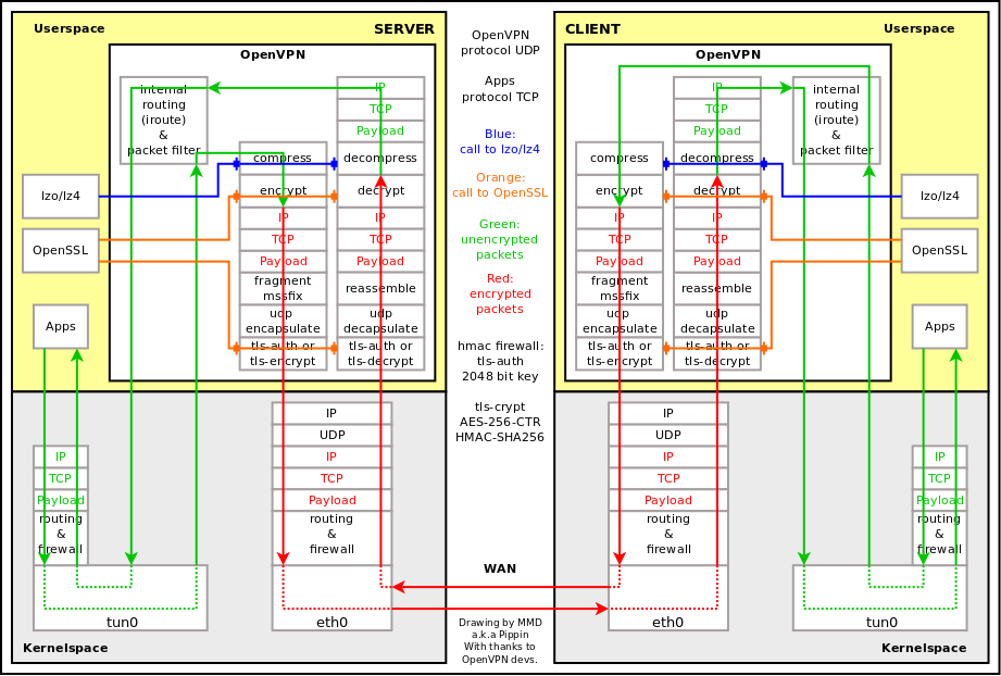

I'm not sure but I think OpenVPN does not know about outside MTU after connection is established. Please see attached diagram and --mssfix max (and --fragment) in manual 2.4:
https://community.openvpn.net/openvpn/wiki/Openvpn24ManPage -
