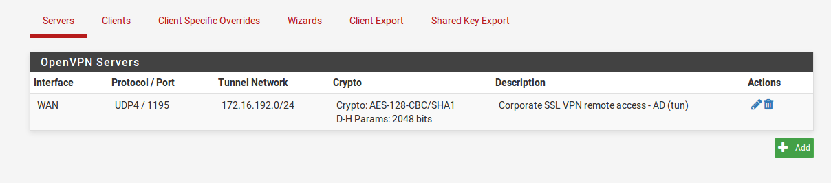

                and finaly openvpn server
                All this is fine if traffic is coming from Internet to public 141.....
                But when traffic is coming from internal_vlan1001688 it doesnt work
