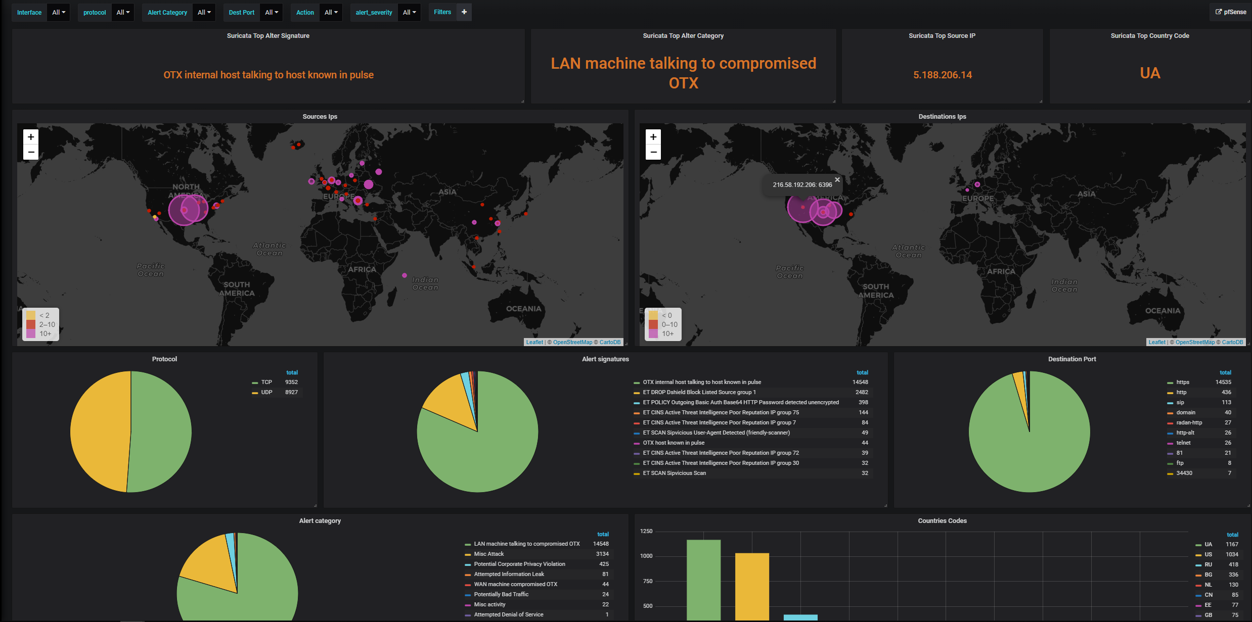

        With some trepidation (the setup for this isn't simple), I suggest you look into setting up a Graylog server to receive EVE JSON from Suricata on pfSense and then using Grafana to interact with the data in a useful way.
        I'm not an expert on either, and won't be much help should you run into issues. I know that Graylog has an OVA image that can be used and I have a Grafana dashboard I've configured to my liking that I can share. It looks like this (modified from an example found online):
        This type of setup can use an enormous amount of disk space depending on what you log. If you just want Suricata Alerts, it won't be too bad. But if you enable all of the EVE logging from Suricata you can easily end up storing multiple GB of log data per day...
