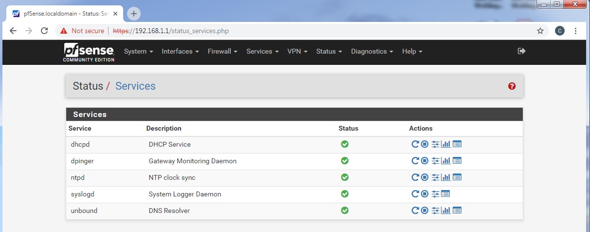

            But- Look at Status / Services on your box and see if everything is running.

                @chpalmer ![alt text]0_1544127458933_running services.jpg not sure what services should be running but this is the page, everything seems to be running ok?
