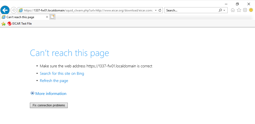

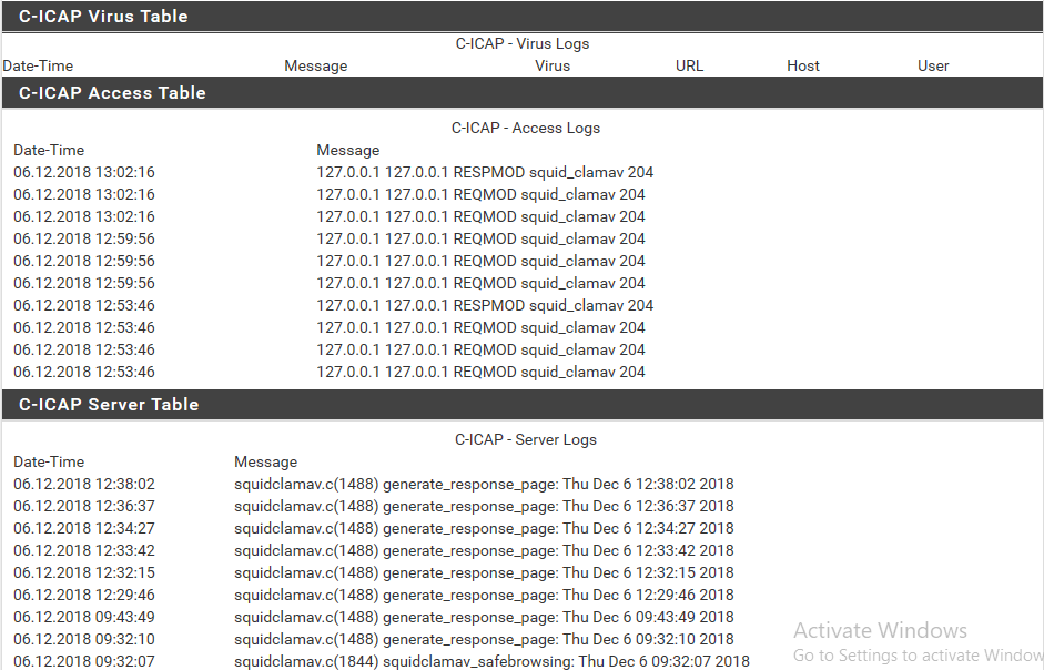

      When I tried downloading the Eicar test file (both HTTP and HTTPS) from https://www.eicar.org/?page_id=3950 I'm getting a error page, see attachment. I'm not getting the ClamAV page and also I'm not getting any logs in the C-ICAP Virus Table, see attachment.
      When I disable the antivirus I can download the HTTP and HTTPS files, so ClamAV is doing something by showing the error page, but not what I'm expecting. Does anyone have a solution?

        You can see by the C-ICAP Server Table log that the response page was called.

          I do see the response page being called, also by the URL when I try downloading the testfile which tries to redirect to squid_clwarn.php

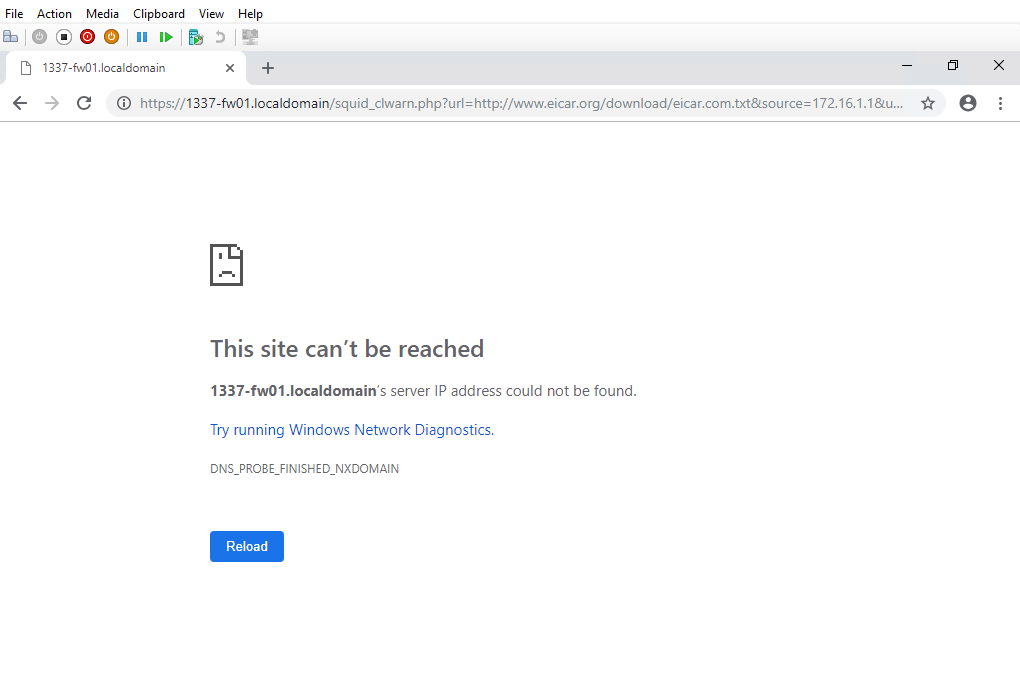

              Sorry for the late reply. I've completely removed squidguard and rebooted the firewall, but I got the same response. I've tried with Google Chrome as well and got a NXDOMAIN error (see attached screenshot). Is thh "localdomain" configuration causing this problem and is a valid domain required?
              Or what issue are you referring to a year ago in the Squid package?

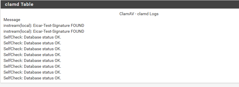

                  pimmes111
                  It is being caught instream:
                  • I Offline
                    Impatient
                    That indicate's clamav is detecting the test file but isn't logging it properly.
                    I checked my setup and receive the same, Found instream with no default block page and it is not logged in either the C-ICAP Virus Table or the dashboard widget.

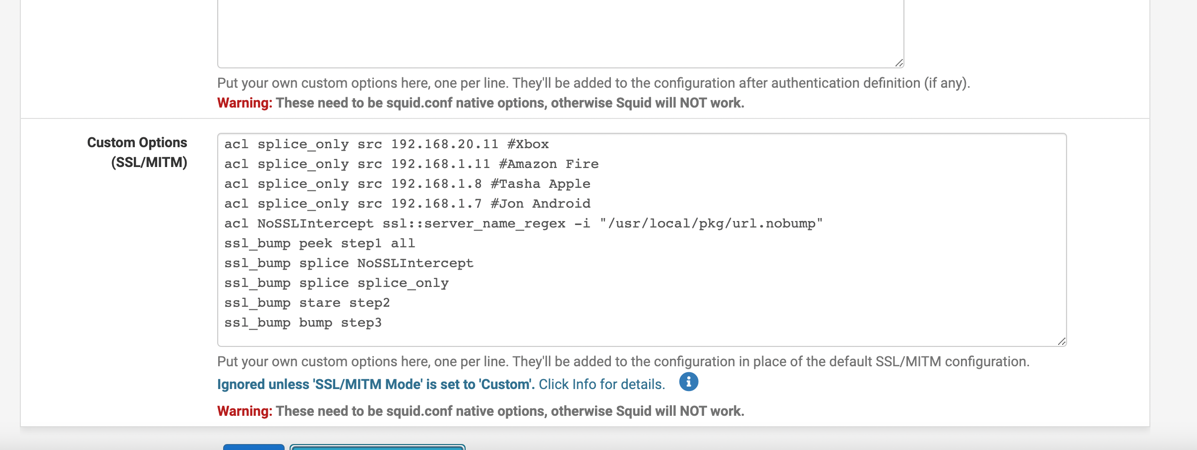

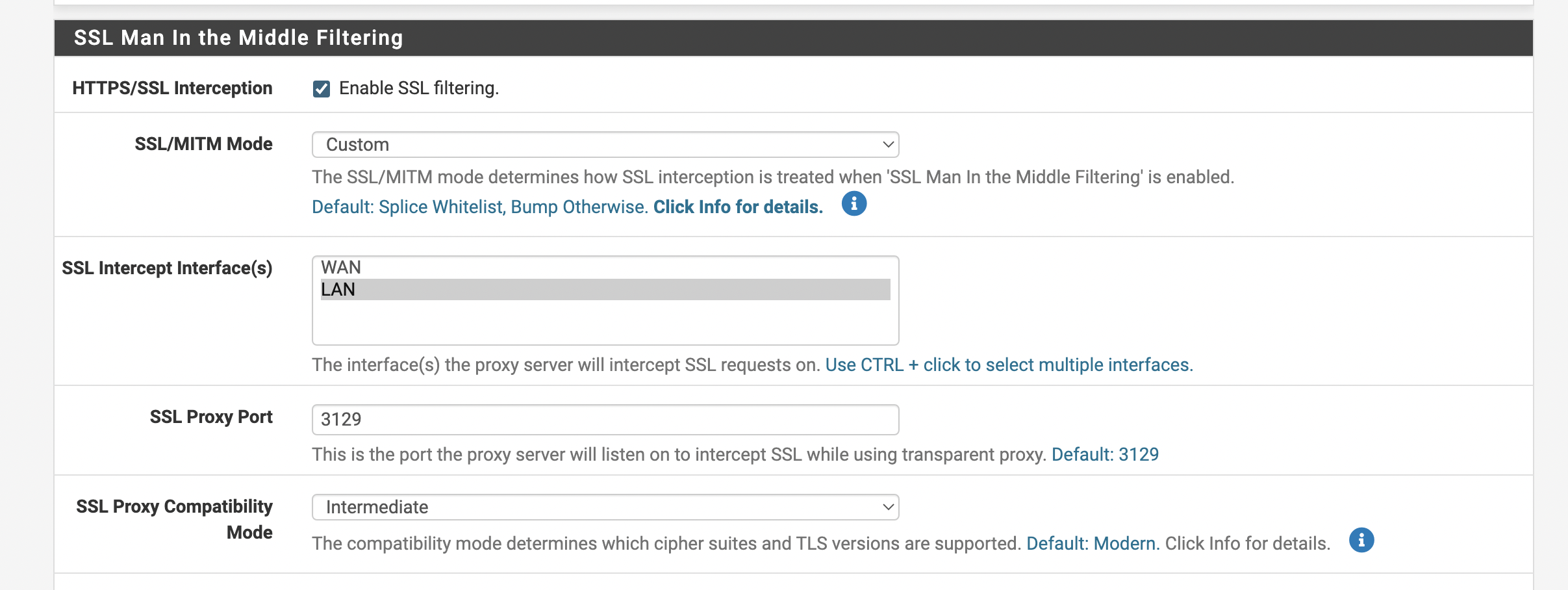

                          I have it set to custom and it will now catch both http and https test viruses. I tested and researched some different settings. The certificate had to be created with Squid and used that way however.
                          (IMAGE: Custom used)
                          (Image Advanced options)

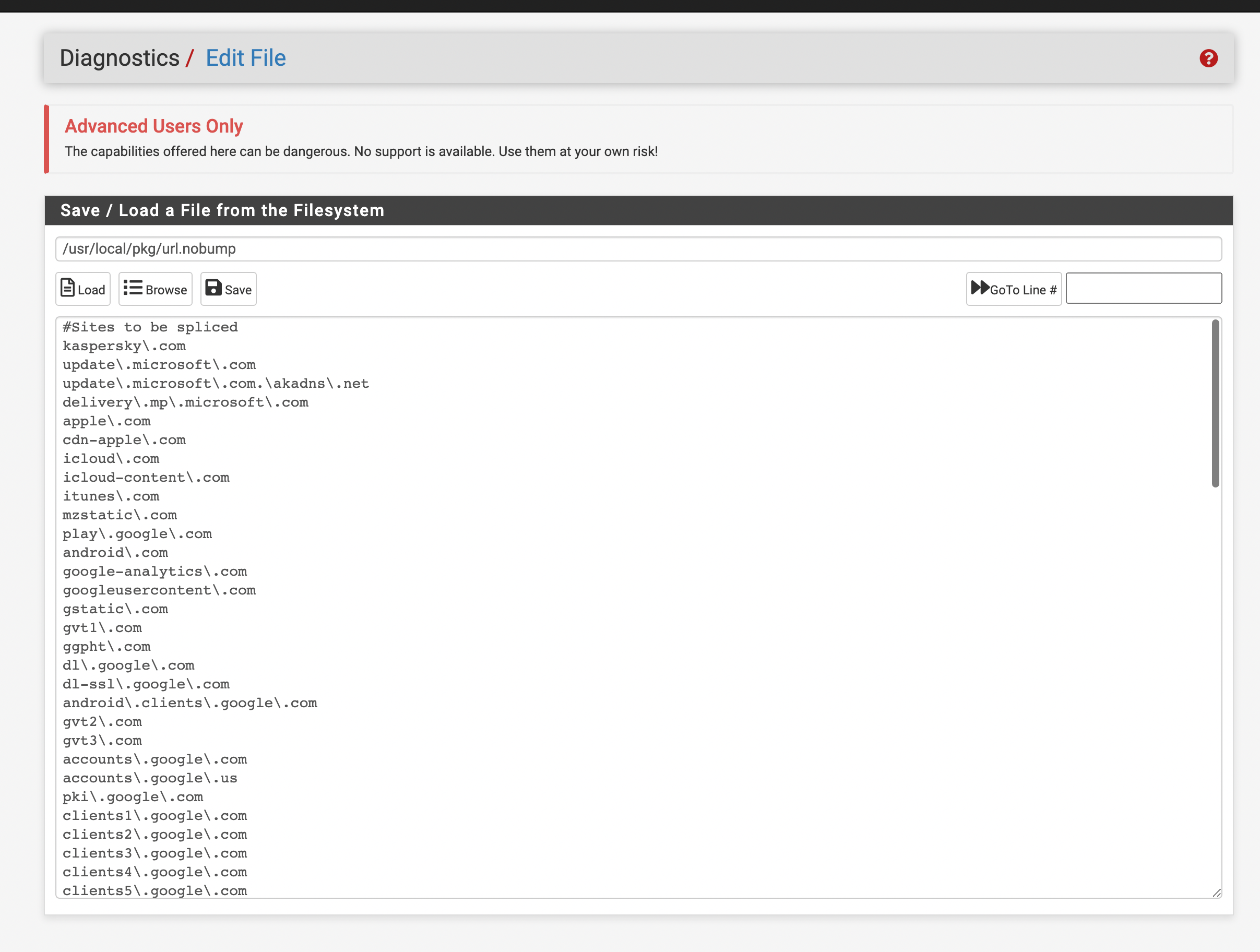

                          Take notice on the Amazon fire and Xbox I have the firewall set to use splice all for those static LAN IP addresses. The other devices that can use the certificates use peak step1 all slice only for my nosslintercept list of IP addresses and a file I created with URLS I do not want ssl intercepted.
                          (Image: Custom made URL splice file)

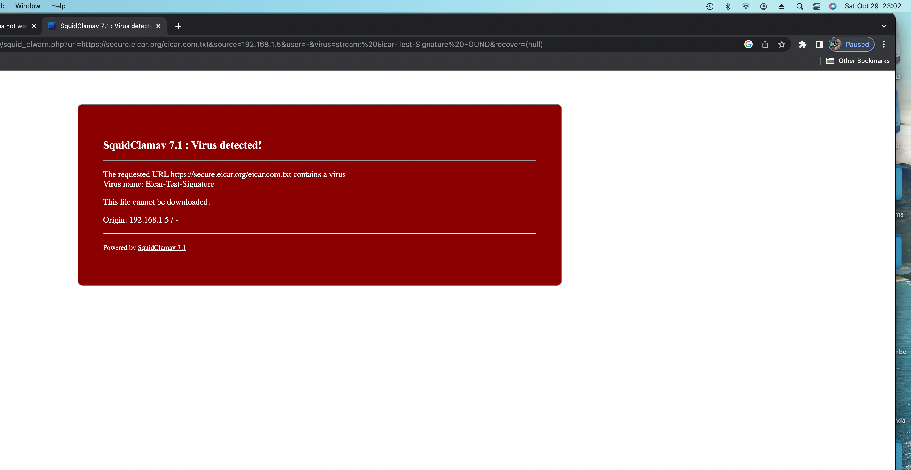

                            Now ClamAV catches both HTTPS and HTTP test virus
                            (IMAGE: HTTPS Virus test successful) Squid Blocks them notice it states HTTPS now in the error
