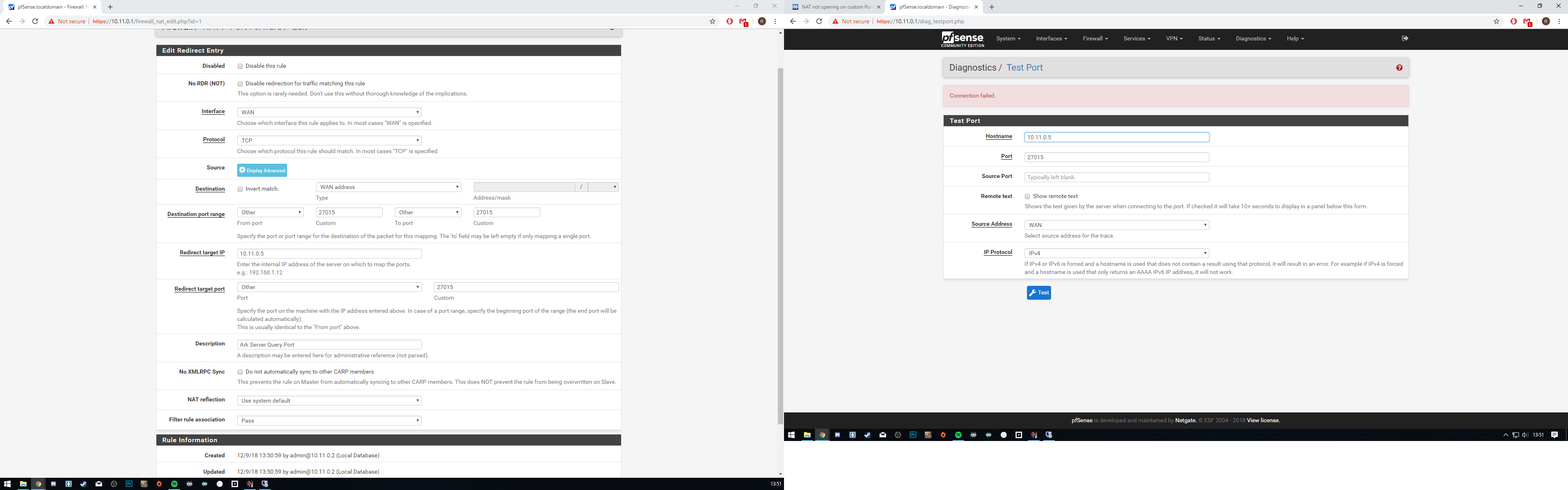

          @rico So how would I go about looking at this? Granted i'm a total noob but I want to get a better understanding of PFSense.

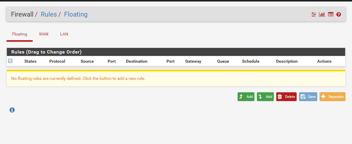

            Your target 10.11.0.5 machine is using pfSense 10.11.0.1 as gateway right?
            What can you see in the Logs about this connection?
            Also show some screenshot of your Firewall Rules.

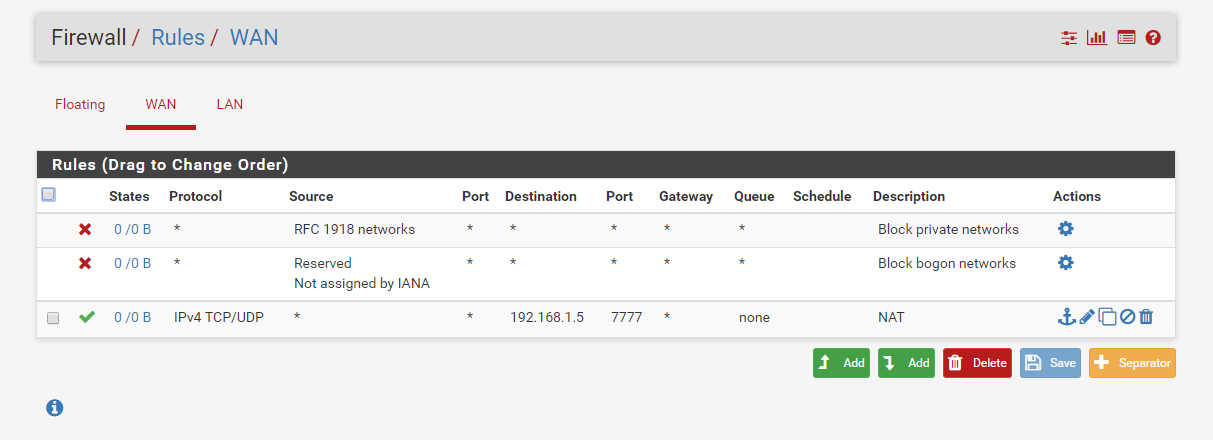

              PEBKAC Time. Where can I find the logs? I can get into the terminal via my second screen as its currently hooked in so If I need to shell anything I can.
              Dec 9 13:56:37 WAN Default deny rule IPv4 (1000000103)
              I see this against it?

                You see those logs for what traffic? Please don't truncate/obfuscate anything. You left off part we need to see.
                If you are getting "Connection Refused" it is not coming from pfSense unless you specifically set up Reject rules instead of Block rules.
                A "Connection Refused" message means something received the SYN and replied with a RST. pfSense will not do that unless the traffic is hitting a Reject rule which is not anywhere in the default configuration.
                Packet capture on WAN for the traffic to TCP port 27015. Attempt a connection. See what is there.
                Then packet capture on LAN (or whatever interface 10.11.0.5 is on) for traffic to TCP port 27015 and attempt another connection. What is there?
                Just about every guide out there will have you using auto-generated rules for the WAN interface instead of NAT firewall rule type Pass. Can you elaborate on why you chose to do it differently?

                  @derelict said in NAT not opening on custom Ports:
                  This is with a rule in place and still it shows as closed. That was tested via Yougetsignal

                    @ryanh said in NAT not opening on custom Ports:
                    08:44:59.616503 AF IPv4 (2), length 64: (tos 0x0, ttl 56, id 27812, offset 0, flags [DF], proto TCP (6), length 60)
                    198.199.98.246.45066 > 90.255.228.195.27015: Flags [S], cksum 0xaefc (correct), seq 19903264, win 14600, options [mss 1460,sackOK,TS val 1226039172 ecr 0,nop,wscale 8], length 0
                    08:44:59.616989 AF IPv4 (2), length 44: (tos 0x0, ttl 127, id 37, offset 0, flags [DF], proto TCP (6), length 40)
                    90.255.228.195.27015 > 198.199.98.246.45066: Flags [R.], cksum 0x786d (correct), seq 0, ack 19903265, win 0, length 0
                    The server is sending a RST - rejecting the connection. Check the logs there.
                    To be sure, do the same capture on the inside interface.
                    Again, check (really check) everything here:
                    https://www.netgate.com/docs/pfsense/nat/port-forward-troubleshooting.html
                    it is pretty much invariably something on that list.

                      Nat reflections is set to NAT + Proxy, I only have LAN and WAN. I've deleted and remade NAT Portforward including rules. I'm literally at the end.

                        Post your wan, lan and floating firewall rules tab.. And the sniff on your LAN side interface on pfsense and we will help you figure out where your problem is... Since you seem incapable of following the simple instructions on troubleshooting given in the guide.

                          RyanH @johnpoz
                            RyanH @johnpoz
                            @johnpoz

                                  @derelict I don't get it, the firewall is off... 1.5 is the VM running via hyper V
                                  • DerelictD Offline
                                    Derelict LAYER 8 Netgate
                                    All we can see is the SYN packets are sent to 192.168.1.5 port 7777 and there is no response. It's something in either your infrastructure or on that host itself. It's not the firewall. The firewall is forwarding the traffic as instructed.
