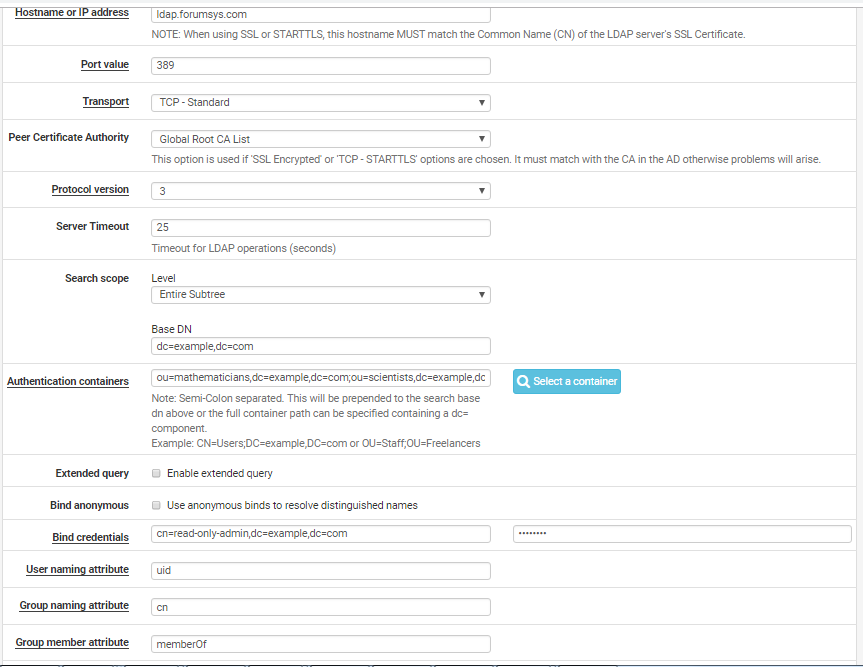

      1/on "SystemUser Manager>Authentication Servers" i add my ldap server;for my lab i used online LDAP server test(https://www.forumsys.com/tutorials/integration-how-to/ldap/online-ldap-test-server/):
      Server: ldap.forumsys.com
      Port: 389
      Bind DN: cn=read-only-admin,dc=example,dc=com
      Bind Password: password

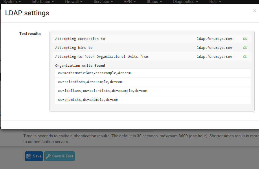

      2/on "SystemUser Manager>Settings" i tested my ldap server all are ok(you can see the attached imag)
