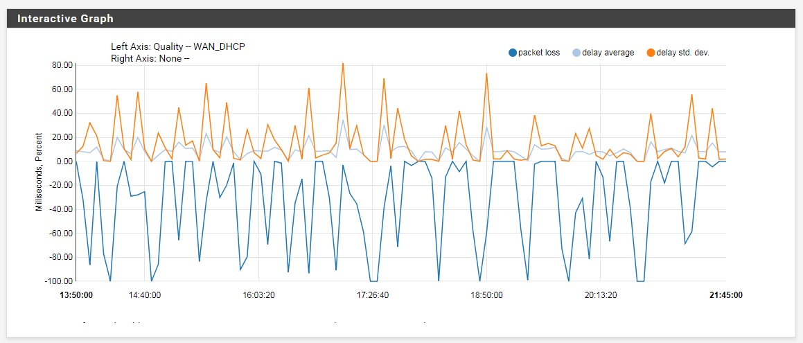

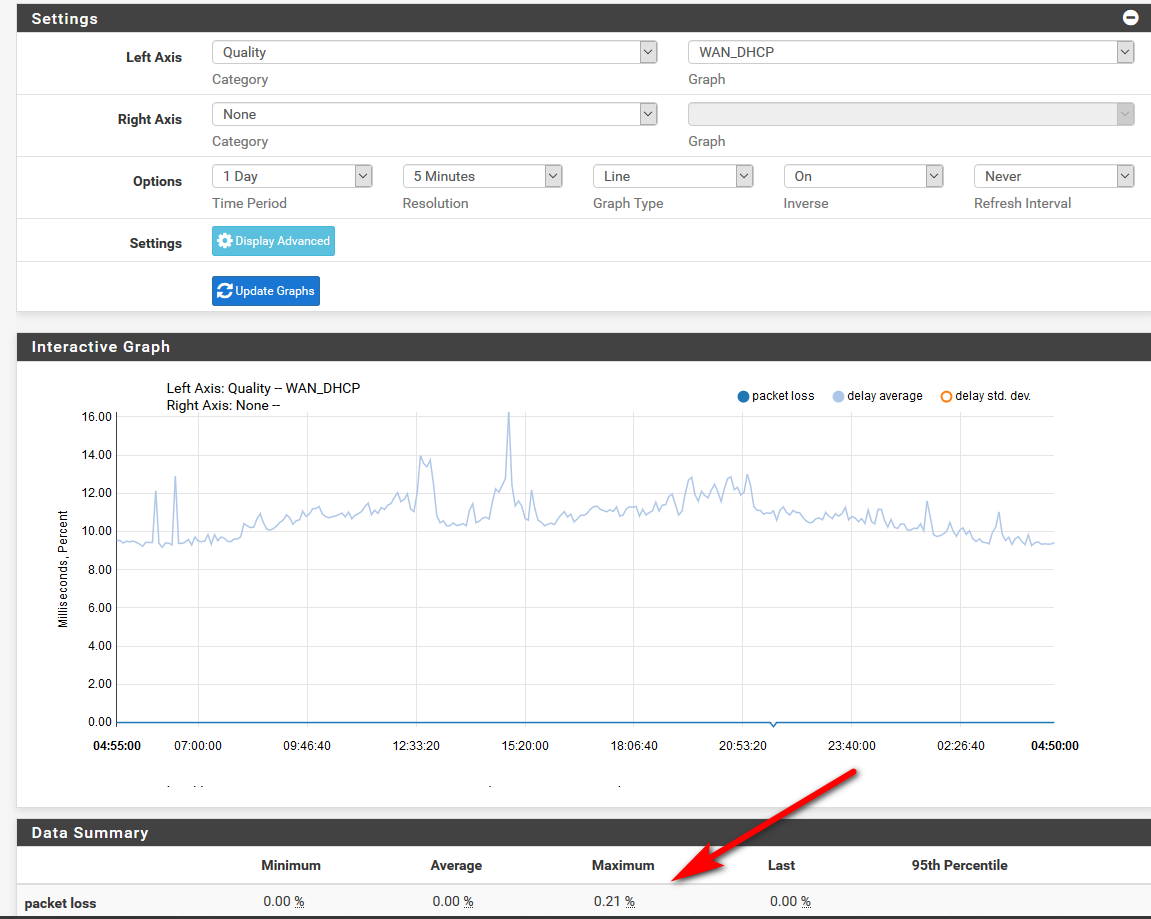

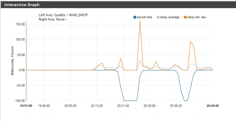

      the only thing ive been able to find that could be causing this is the WAN quality graphs0_1544734271241_graph.jpg
      this seems to have improved after a wipe and clean install but still shows issues?0_1544734366848_after reload.jpg

      • johnpozJ Online
        Dude nothing is goiing to work with packet loss like that!!
        • N Offline
          noob @johnpoz
          @johnpoz funny you should say that... as everything is actually working.. speed tests, website browsing. video streaming, youtube it all works fine.......
          so how do i find out whats causing that packet loss?
          • johnpozJ Online
            If your saying its working then might be just dropping pings to your gateway... But when quality sees high loss and thinks internet is down it can reset all your states..
            That is not good condition.. Are you pinging just your gateway - or did you change it to something else.

              if standard is to ping the gateway then thats all dpinger is doing, i have a log running from think-broadband pinging my public IP address and its not showing the same packet loss that pfsense is :/
              the strange thing is that i was surfing the web and watching youtube (and mrs on facebook) while pfsense was claiming 100% packet loss for about 3 mins solid!
              so is this a "false flag"? that pfsense is reporting high packet loss because its pinging its own gateway?
              from what i can tell i can still browse the internet no problems although pfsense is reporting 100% packet loss :/

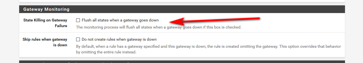

              • johnpozJ Online
                While it might be false flag - ie pfsense gateway just not answering the PING..
                But when that happens pfsense can think internet is down and reset all states - then you loose connection.
                Under Advanced, Misc
                Or set gateway to always be up and disable monitoring.

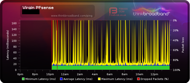

                  the spike of packet loss at around 10pm was before i allowed ICMP ping requests as a rule and the 2nd spike at around 11pm was when i rebooted pfsense
                  never used thinkbroadband monitor before so no idea if those ping spikes/results are normal for my line (speedtest.net is ALWAYS below 20ms ping and 2ms jitter but that test is with an idle connection so best case scenario)
                  think broadband pings once every second no matter the load on bandwidth
                  • N Offline
                    noob @noob
                    It doesn't flush/reset all states (box is unticked) and I've disabled gateway monitoring.

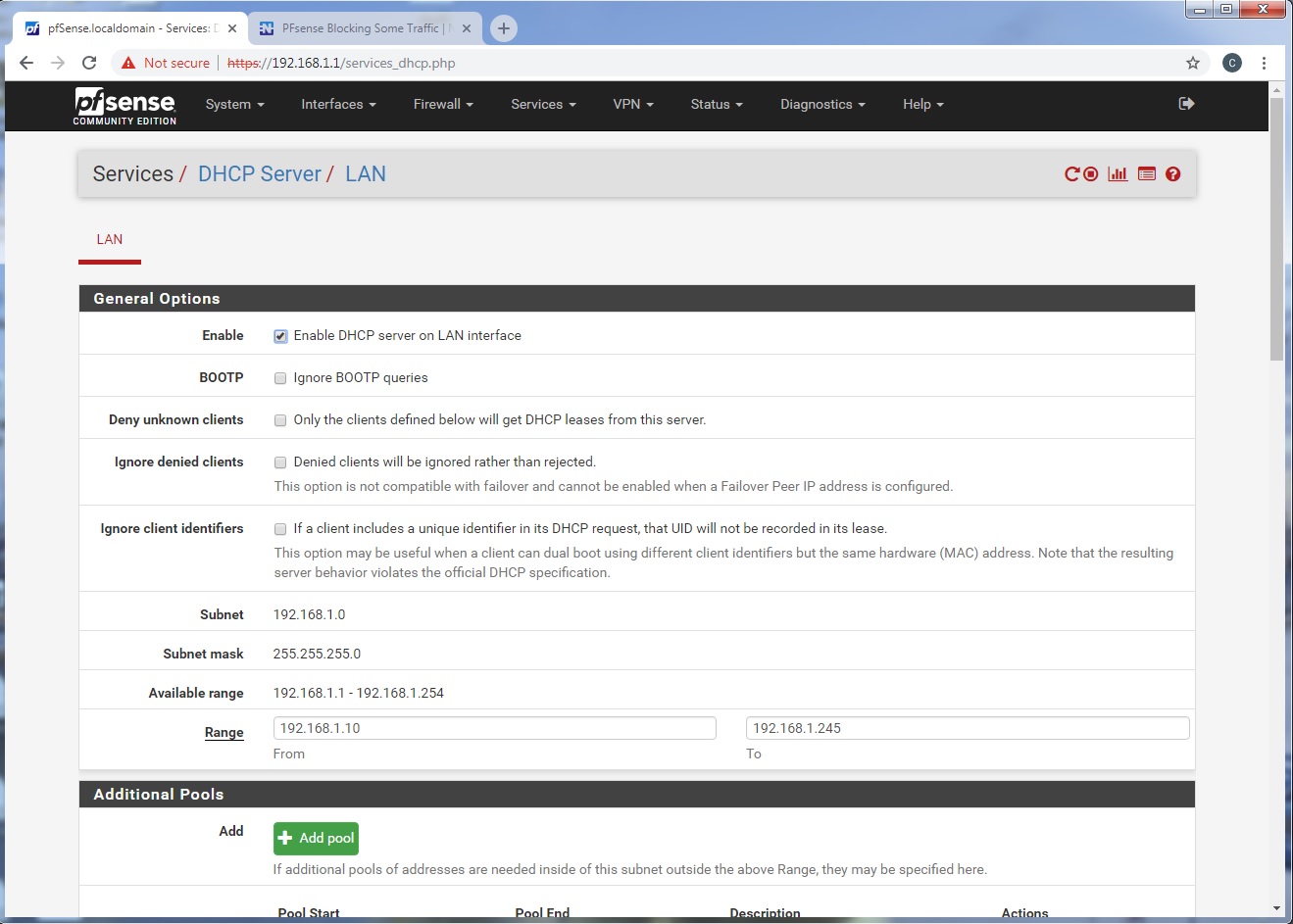

                          • N Offline
                            noob @tim.mcmanus

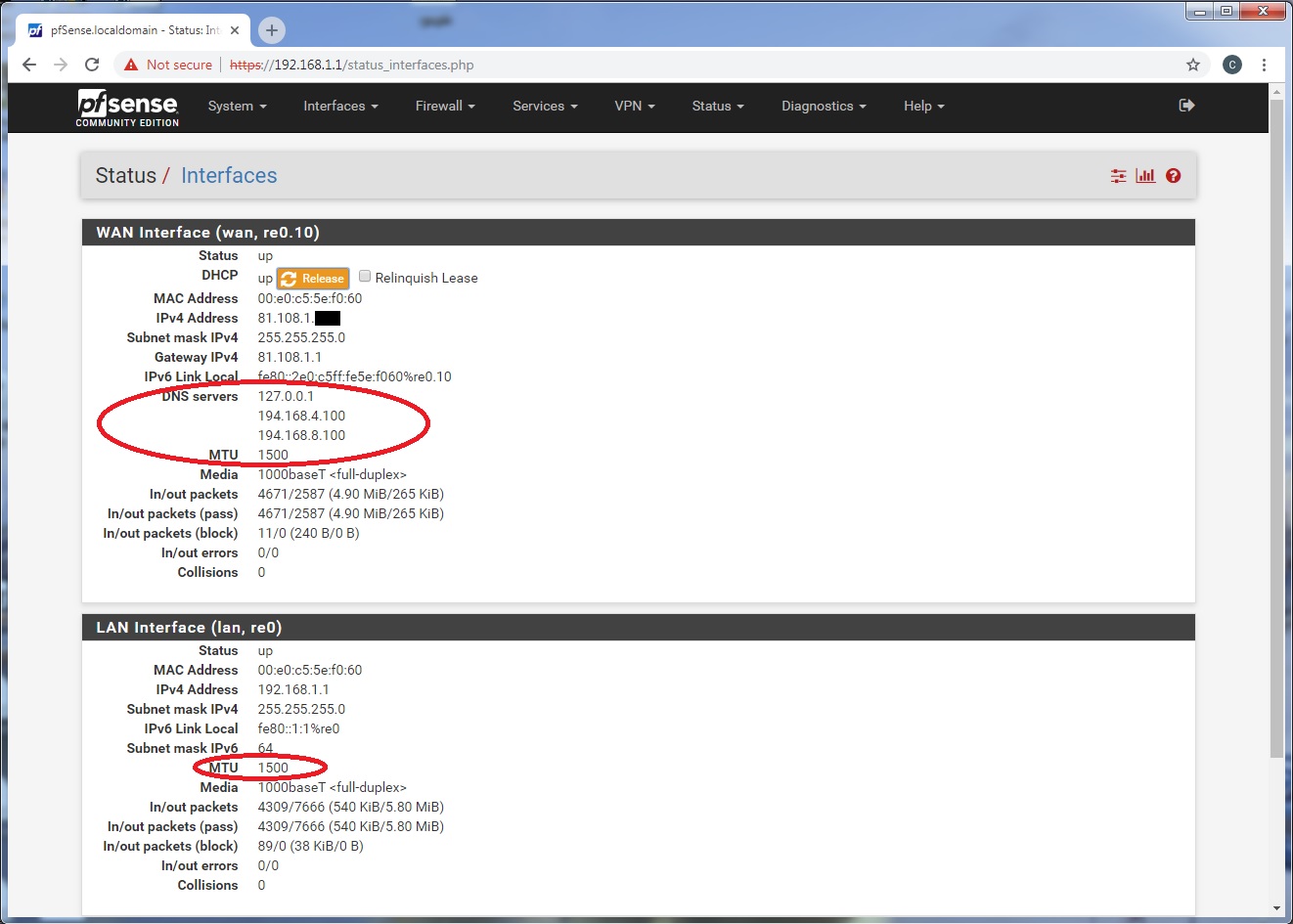

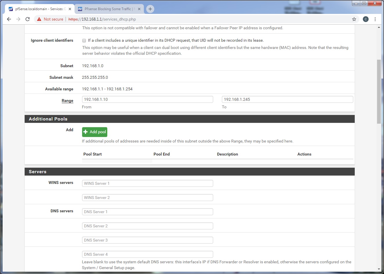

                            i hope these screen shots contain the info you requested?
                            the DNS servers listed have all been automatically assigned (i assume via DHCP from the modem)
                            the gateway listed, belongs to virgin media and again has been automatically filled in, however this is not my modems public IP address.
                            i had to disable gateway monitoring as it was throwing up false information, claiming my gateway was offline yet i was still online with no issues (i'm guessing because it was monitoring virgin media's gateway and not my public IP?)
                            MTU is automatically set to 1500 on both wan/lan.
                            my virgin media superhub 3 is in modem only mode so DHCP is not active, neither is NAT or any form of firewalling
                            • T Offline
                              tim.mcmanus
                              Thanks for posting those screen shots.
                              What I didn't see was which DNS servers your DHCP server is giving out.
                              Also, when you say pfSense is doing DNS, are you running the DNS resolver?

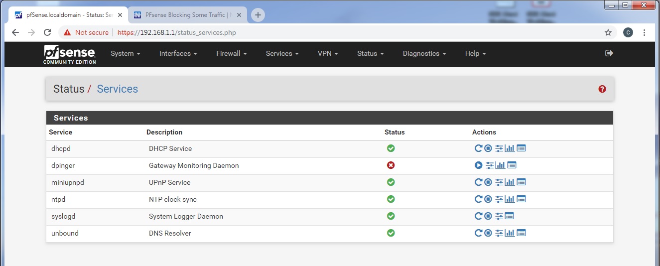

                              • N Offline
                                noob @tim.mcmanus
                                the DNS resolver is running (i have not changed this, so default configuration must be to have this on)
                                did you need a screen shot of the DNS resolver general settings page?

                                        • N Offline
                                          noob @johnpoz
                                          @johnpoz the packet loss from another post was a red herring, pfsense was not monitoring my modem, it was monitoring virgin media's gateway which is way out of my control.
                                          i setup "think broadband" to monitor my public IP (and so monitoring my own gateway) and packet loss was 0.11% max
                                          i have disabled pfsense gateway monitor, as it was monitoring the wrong thing and giving irrelevant into, and was easier than getting pfsense to monitor the correct gateway
