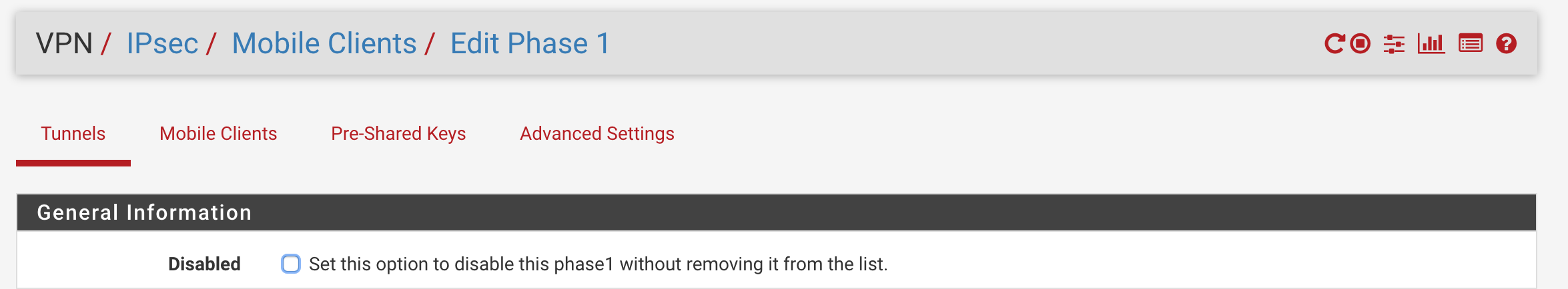

                          @artemis This means that IPSEC is not enabled at boot time
                          Or missing phase 1
                          Or phase 1 is disabled
                          K 1 Reply Last reply Dec 21, 2018, 11:50 AM Reply Quote 0

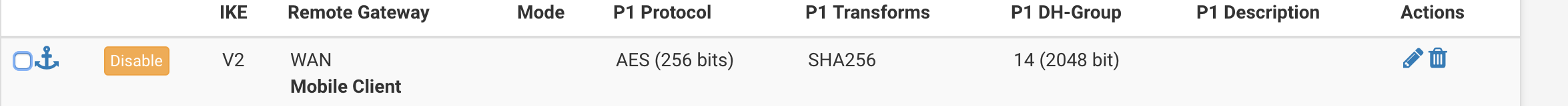

                              @konstanti Try to set IKEV2without the l2tp/IPSEC
                              From the documentation
                              We strongly recommend using another solution such as IKEv2 instead of L2TP/IPsec.
                              • A
                                artemis
                                K 3 Replies Last reply Dec 21, 2018, 11:52 AM Reply Quote 0
                                • K
                                  Konstanti @artemis
                                  @artemis Unfortunately, nothing is visible

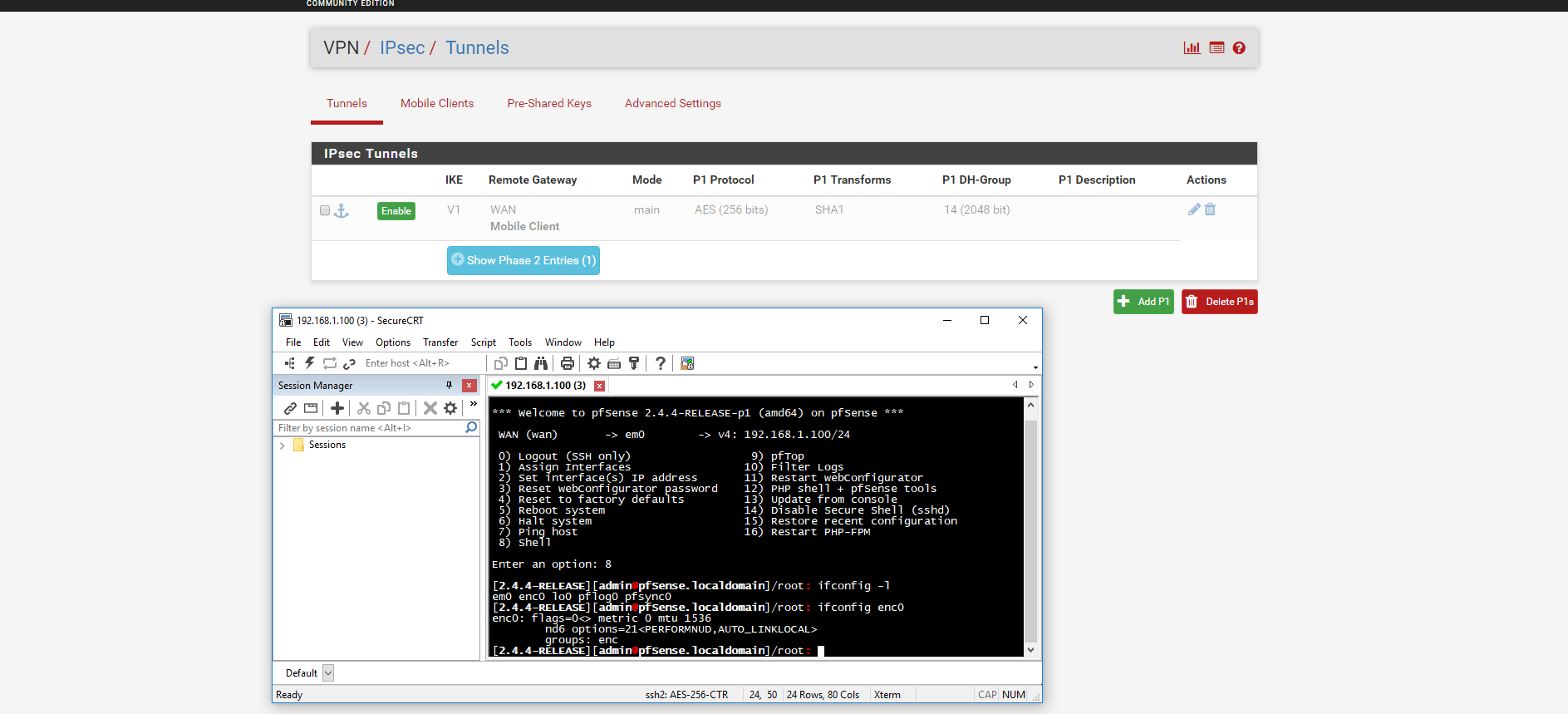

                                      Ok. To describe it, am showing you that the phase1 is enabled from the gui and the interface is not up.
                                      K 1 Reply Last reply Dec 21, 2018, 11:58 AM Reply Quote 0
                                      • K
                                        Konstanti @artemis
                                        @artemis
                                        When booting the PF checks whether it is enabled to initialize IPSEC
                                        If not , enc0 set to down
                                        And files strongswan.conf, ipsec.conf,..... not created
                                        Try to configure access using IKEV2 without l2tp
