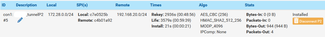

    The widget shows that all three tunnels are up. However the Sophos side still says that there is no connection on the third tunnel. Also cannot ping across. [image: 1762831782639-snag_233c72.png]
