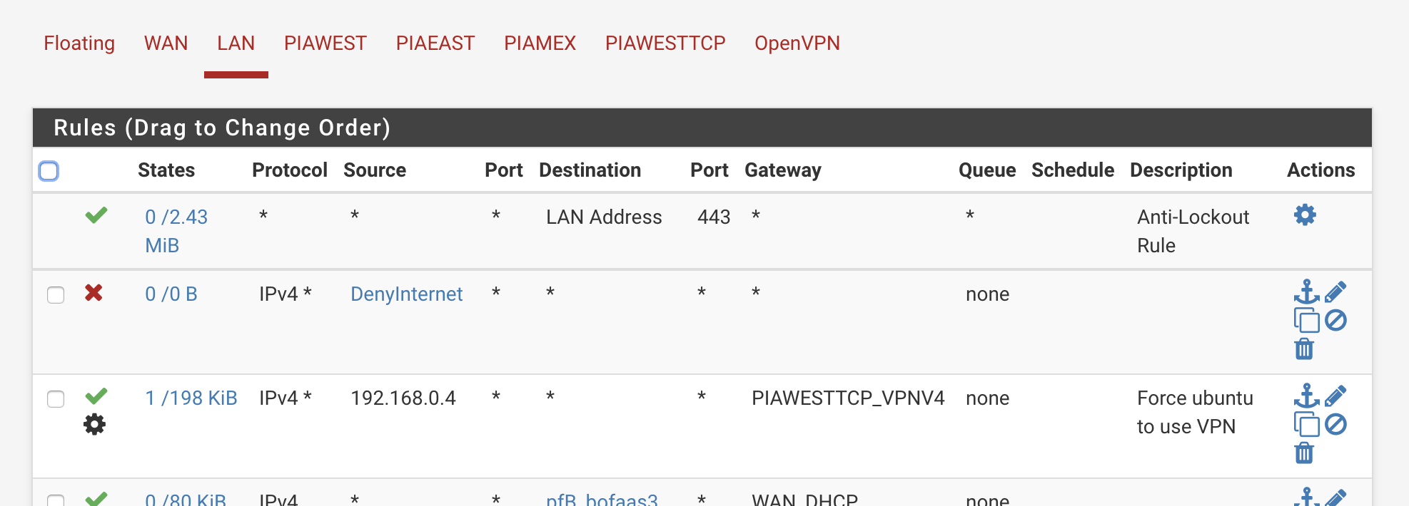

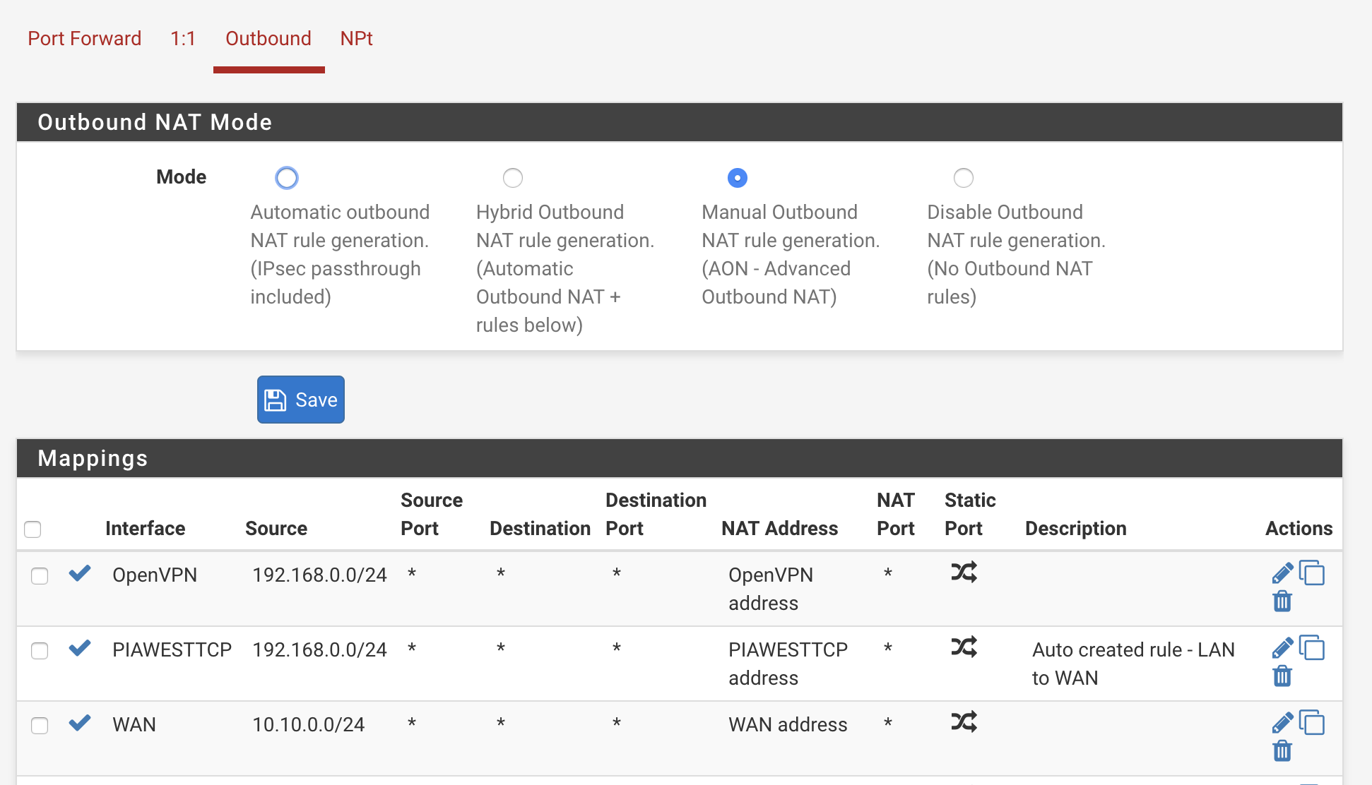

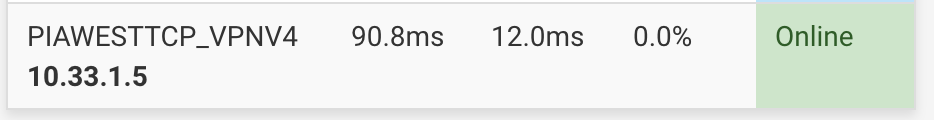

      I have already set a NAT rule from my LAN IP range to the VPN and I also have the gateway created and up
      The problem that I do see is that connections do establish almost 50% of the time. If a connection is open, I can see that all its traffic its perfectly routed to the VPN gateway but it just fails to start 50% of the time. Doing packet captures I can see that the client sends the SYN flag but it never receives the SYN ACK, so the TCP connection does not start. Retrying the connection does indeed work but it breaks on the next one, rendering the tunnel useless.

            Looks like the problem was the first OpenVPN rule that was there to allow the VPN server to route traffic to the internet but for whatever reason, it was confusing the pfsense routing. I have deleted that NAT rule and now it works as expected
