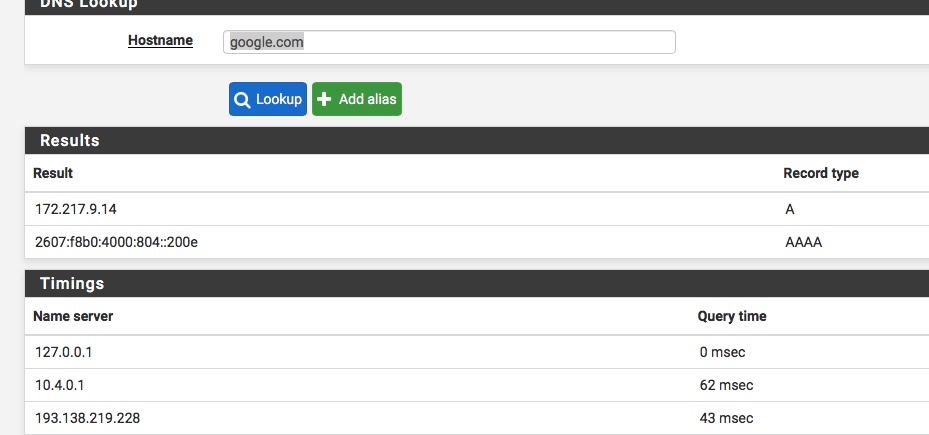

            screen shot on my box.
            mbt 4220 running latest stable
            L 1 Reply Last reply Jan 2, 2019, 9:05 PM Reply Quote 0

                @bcruze said in Diagnostics / DNS Lookup, using Resolver, always shows Query time 0 msec:
                Yep, this is exactly what happens to me, 0 msec but for every domain I look up.

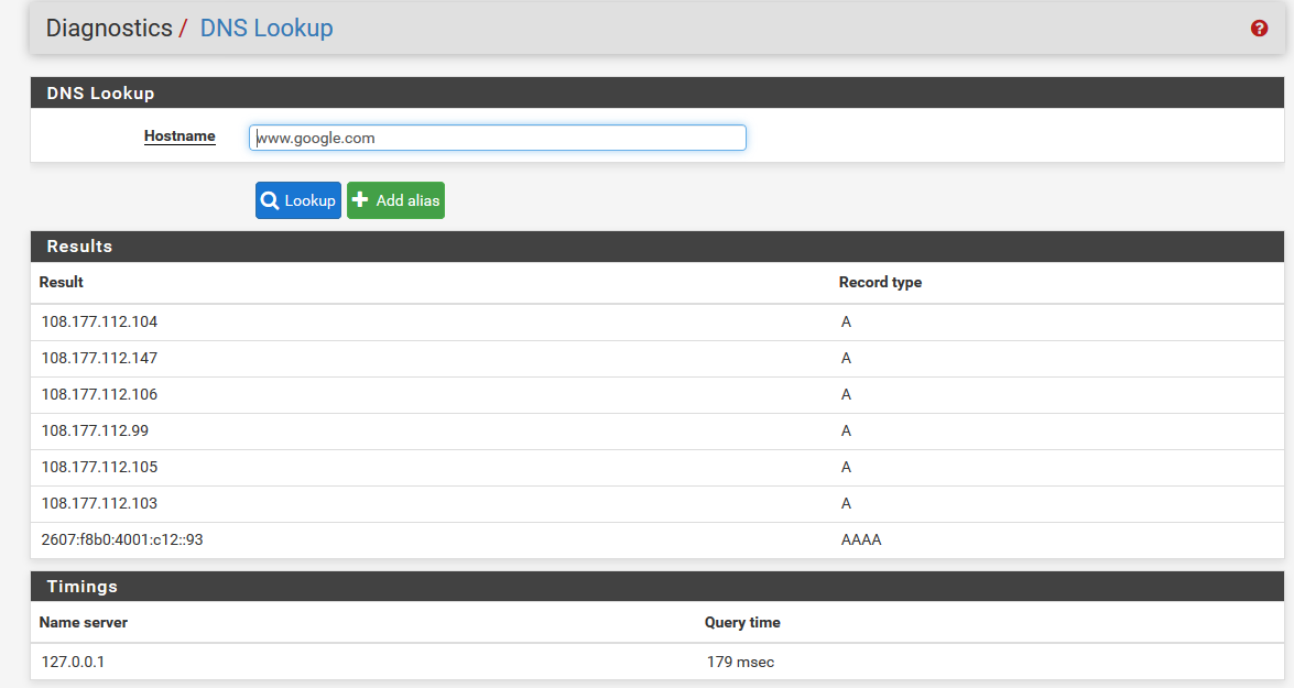

                        So clearly its showing fine - here is after a flush
                        Look at the log if you want to know how long it takes to resolve something, or just look at your status for how long it takes for resolver to talk to different NS..

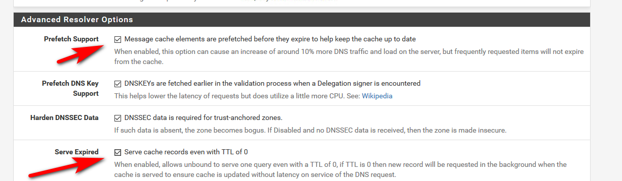

                                      When I need to troubleshoot anything to do with dns, I always just use dig... Only time I really use that gui is for examples for users to validate if pfsense can actually resolve or not.
                                      As to answering Zero and Prefetch - yes both options that can be turned on, and can be very helpful.. I am not sure if on by default because I always make sure they are both on - unless testing something.. You should see a drastic increase in your cache hit % turning on the prefetch option.
                                        Interesting! If I may ask, why do you turn on Serve Expired? That seems like something we wouldn't want turned on if DNS records for a website changed but our pfSense installs were instead giving us an older expired value (I understand that 99% of the time, it'd be just fine since most DNS records don't change that frequently). How does pfSense know when to drop that expired value then or update it? Unless I'm misunderstanding what that option does.
                                          Raffi_ @johnpoz
                                          @johnpoz Thanks for the tip on the advanced resolver options. I'll give them a try. They are both disabled by default, FYI.
