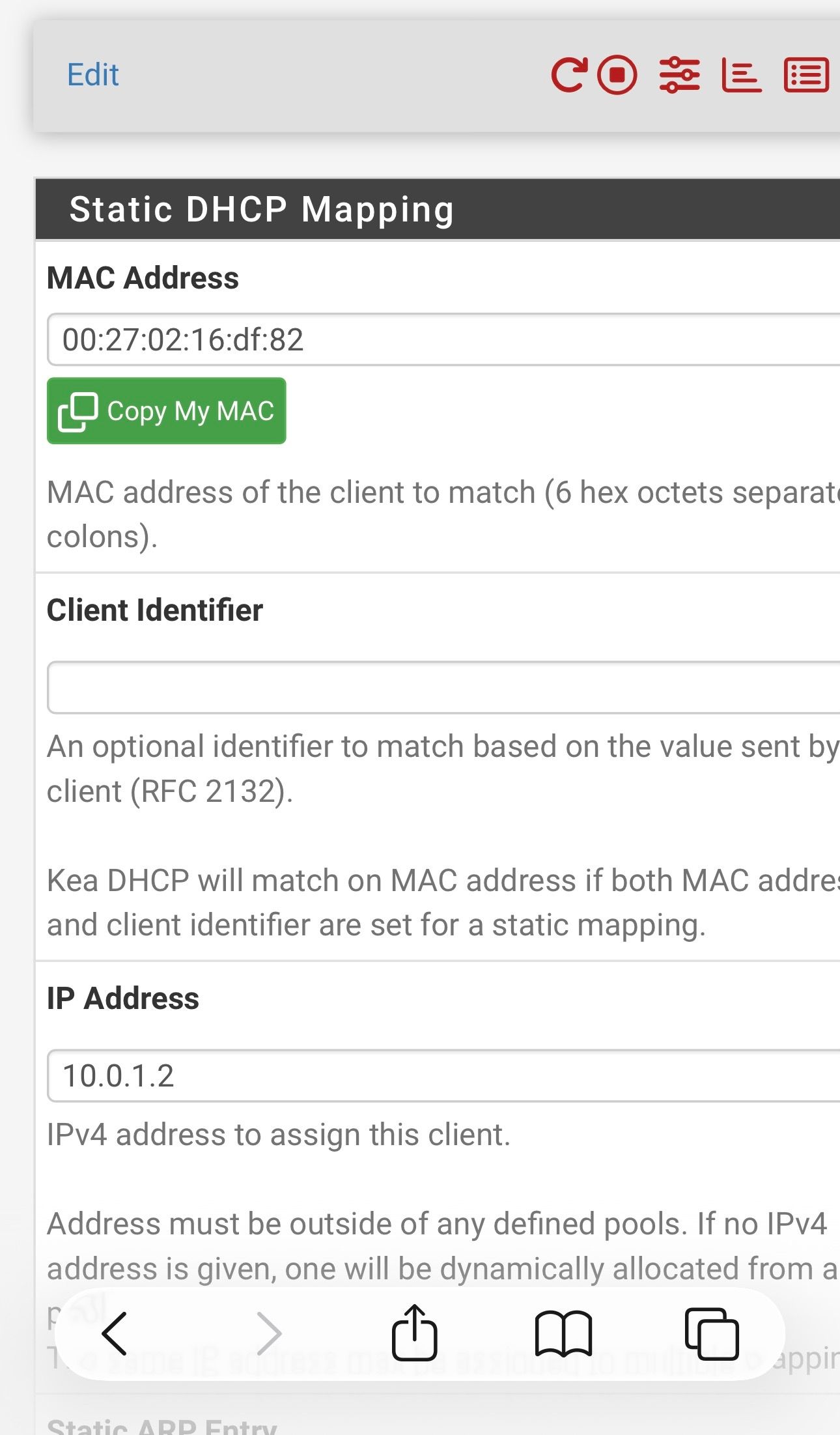

    mandelbrotM
    @Gertjan said in Changing the MAC address on a Kea static lease does not work: So, still me thinking out loud, maybe you have an issue - and it happens when you use static mac leases and change NICs. => How often does that happen IRL ? We actually do this relatively frequently! Some client devices have static DHCP assignments. When those users get a new device, we update the MAC address in the static DHCP entry and their new device gets that IP. I suspect this is not an uncommon practice. We've been doing this for nearly two decades now with pfSense using ISC. It is only when switching to Kea that this problem presented itself.

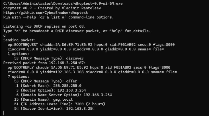

    177 Views
    @sam.newby again - pfsense is not involved in it.. Doesn't matter if they got the lease originally from pfsense or not.. When that lease expires they would do a discover and your windows dhcp server would give them a lease.. There is no such thing as a firewall rule for devices on the same network talking to each other - because pfsense is never involved in such communications. Do you have any sort of dhcp snooping setup on your switch infrastructure? This for sure could cause you all kinds of problems if not setup correctly, or if you forget to change it when you bring up a different dhcp server. I would again suggest you sniff on your dhcp server and force a client to do a discover.. Does your dhcp server see the discover.. A discover is a full broadcast - every single device on the network would/should see that traffic.

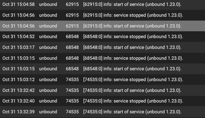

  • Unbound is restarting hundreds of times in 9 hours
    109 Views
    H
    thank you for this link. Finally update to KeA

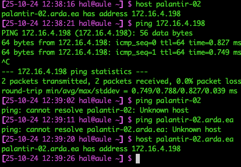

    143 Views
    [image: 1769109778518-ac843c80-c200-4430-a26a-4f092c967e71-image.png]
