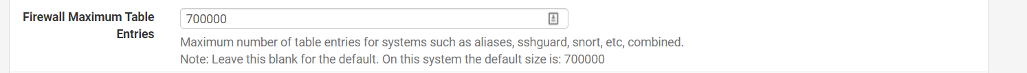

              StyleNZ
              I have 16GB of RAM. I believe I had played around with the state tables before this with no luck, but I can try again. I recall the issue may only arise when I use forwarding too but I'll try confirm that by troubleshooting some more. Below are the settings I currently have enabled where changing anything now under the resolver causes it to become unresponsive.

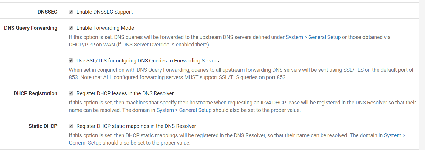

                      StyleNZ
                      BBcan177, I really believe this is a separate issue to the one you describe. I had looked at a few other posts and had already seen your solution regarding DHCP and unbound reloads but through troubleshooting for about a week now, don't believe this problem I am coming across is due to the same reason. When unbound is loading and working correctly, the reloads you speak of can be forced with DHCP renewals which I witness about a 5-10 second outage tops.
                      I have tried a number of settings back and forward now and have come to the conclusion that regardless of the settings being forwarding with TLS enabled or not, that something is causing pfsense to lockup when DNS resolver settings are changed with pfblocker enabled and running. I have repeated this many many times now and have come to the work around that stopping both pfBlockerNG DNSBL service and pfBlockerNG firewall filter service before making the resolver changes works. It's a matter of those 2 not executing together or unloading what ever needs to be unloaded for the resolver changes to take place.
                      Hope that clears things up.
