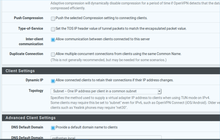

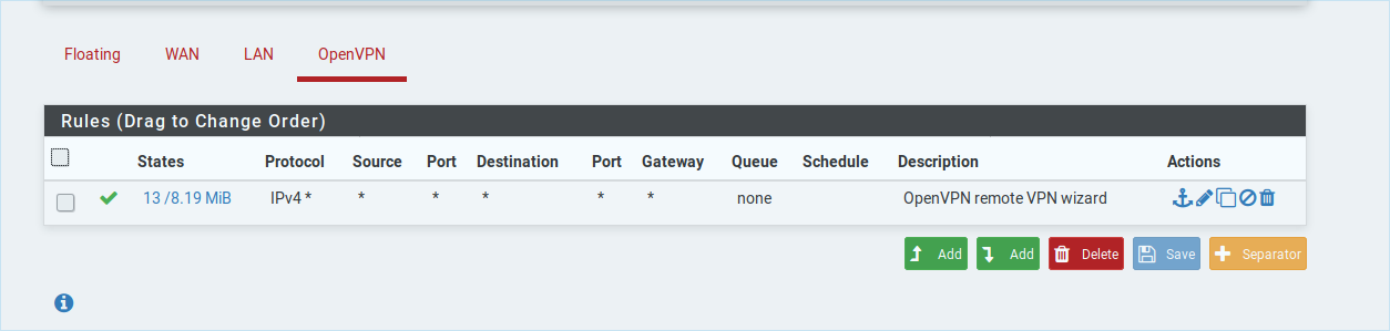

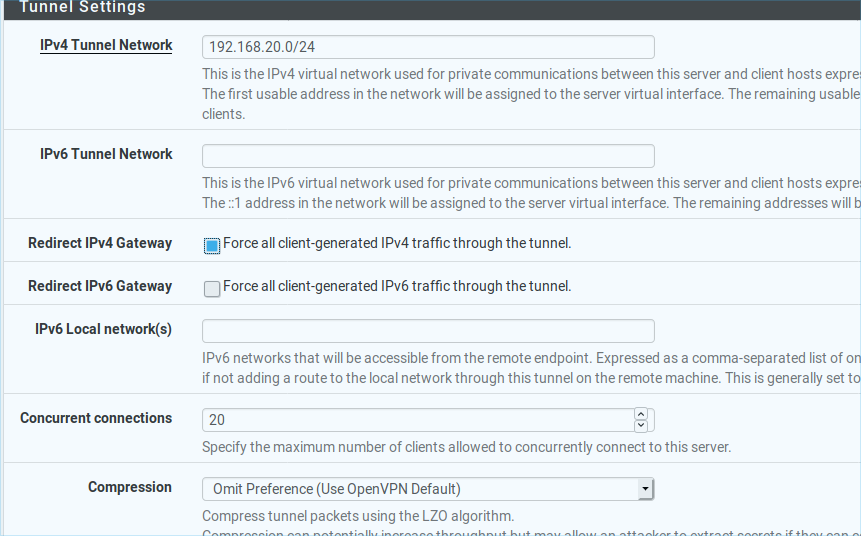

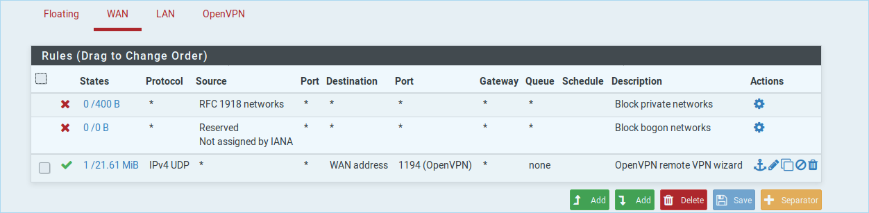

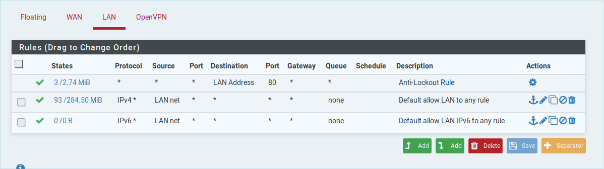

      i was wondering if someone could shed some light on the issue im having. Currently running pfSense 2.4.4-RELEASE-p1
      which is working the OpenVPN i can ping all the LAN but i can only access pfSense webGUI. When i try to access RDP or the webgui of proxmox it wont let me. So odd. also disabled firewall on windows server
      also tried accessing smb shares wont work either
      This are the screen shots
      4_1547916470930_Screenshot at 2019-01-19 10-52-58.png 3_1547916470929_Screenshot at 2019-01-19 10-53-26.png 2_1547916470928_Screenshot at 2019-01-19 10-53-38.png 1_1547916470928_Screenshot at 2019-01-19 10-56-18.png 0_1547916470927_Screenshot at 2019-01-19 10-56-30.png
      Any ideas?
