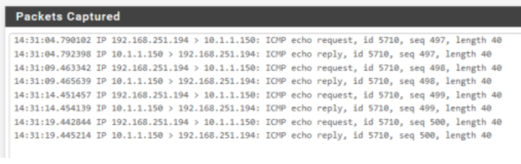

      when i try to ping 10.1.1.20 from my 192.168.10.4 host, it does not go through. i've captured icmp packets with 10.1.1.20 destination of GRE interface. surprisingly it shows that 10.1.1.20 reply to my x.x.x.194 side of the tunnel, but i get nothing on the host,

        Can you show me this packet capture ?
        And yet, you can do the same (packet capture) only on the lan interface.

          sorry, the local ip over tunnel is not 10.1.1.20, that's for another service (which we haven't purchased yet) the remote IP is 10.1.1.150. in this capture is when i capture GRE interface and when i try to ping 10.1.1.150 from my windows host.but i don't get any response.

                                  here you can see that the answer comes to the gre interface
                                  and on the lan interface the answer comes ?

                                    no. it does not come to lan interface. here is what i assumed:
                                    that capture is when i ping 10.1.1.150 (remote GRE ip) from my windows box (192.168.10.4) packet capture on lan shows a bunch of request. but packet capture on gre shows that requests from 192.168.251.194 (my side of GRE) goes to 10.1.1.150 and reply comes from 10.1.1.150 to x.x.x.194 and from there it does not come to my windows box.
