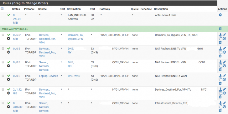

      I have set up Aliases for devices that I want on each VPN and aliases for the DNS servers. The connection work great but it seems that the DNS for one VPN is being used for both VPN connections and even my WAN connection. I have created the following port forward rules:
      So what I am getting is the DNS from the DNS_QC for the DNS_NY and the DNS_WAN.
      Even though I am specifying the redirect IPs of the DNS servers in the Aliases, is it possible for each connection to have its own DNS?
      Am I missing a block rule for each so that it does not go into the other? If yes, can you give me an example of how to go about it?
      here is my NAT Outbound rule and they are set to manual:
      Here are my LAN Rules:

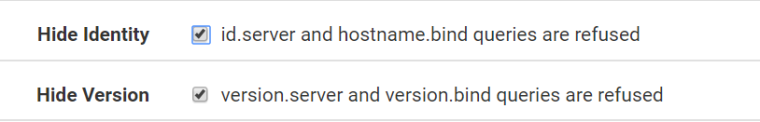

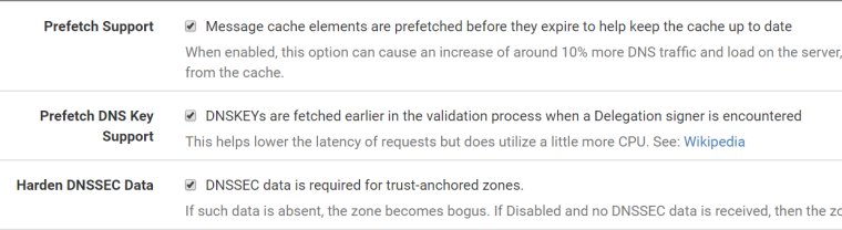

          On the advanced settings:
          The only options checked are:
          Everything else is set at default values.
