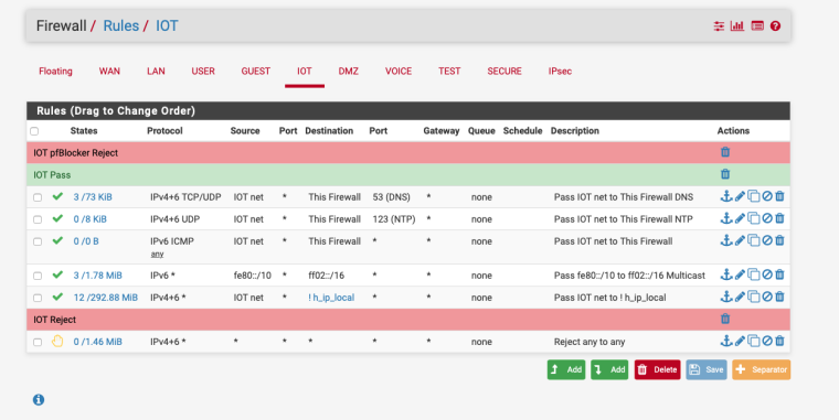

                    Here's my IOT firewall rules, nothing special:-
