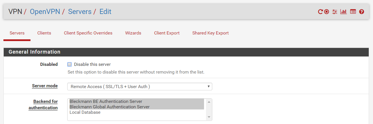

      I'm experiencing a problem when we set up 2 RADIUS servers.
      At the moment we are migrating to a new domain, so we have a Radius Server in both domains.
      Both servers are selected in the OpenVPN server configuration:
      And testing credentials using "Diagnostics -> Authentication" works with credentials in both domains.
      But when trying to log in in OpenVPN GUI I get "wrong username or password":
      Removing a server solves the problem:
      Is there a way (or a setting I'm missing) to use 2 RADIUS servers?
      pfSense version "2.4.4-RELEASE-p1"

        Do both servers work in Diagnostics > Authentication?

          SvenVW
          Yes, both work
          First server:
          Second server:
          The login problems only occur when both authentication servers are selected.
          When only one is selected, I'm able to use OpenVPN in the selected domain.
