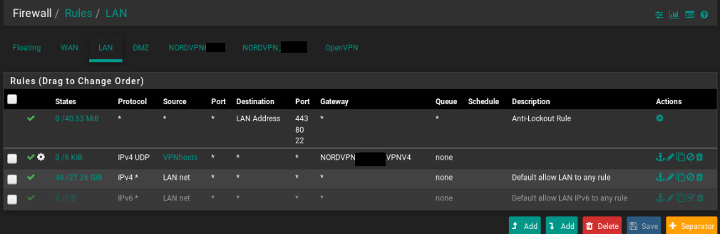

      Hello all,
      I managed to install NordVPN in pfsense (2.4.5-DEVELOPMENT) following this tutorial: https://nordvpn.com/fr/tutorials/pfsense/pfsense-openvpn/
      My problem is all my network is passing trough the VPN, but I don't want that.
      I've create an Aliase with the hosts I want to be in the VPN connection.
      Can you help me please?
      Here my settings:
      If you need something else please tell me.
      Thanks for your help.

        Why are you only policy based routing UDP ?
        Change the protocol to ANY.
        Also for testing use an IP address for the source, does it then work ?
        Andy

            @luckyzor said in NordVPN Client only for specific hosts:
            Here my settings:
            Tried changing the gateway in the two rules below the NORD VPN rule to be the WAN gateway ?
            Is the state count going up on the two rules below the NORD VPN ?
            Andy
