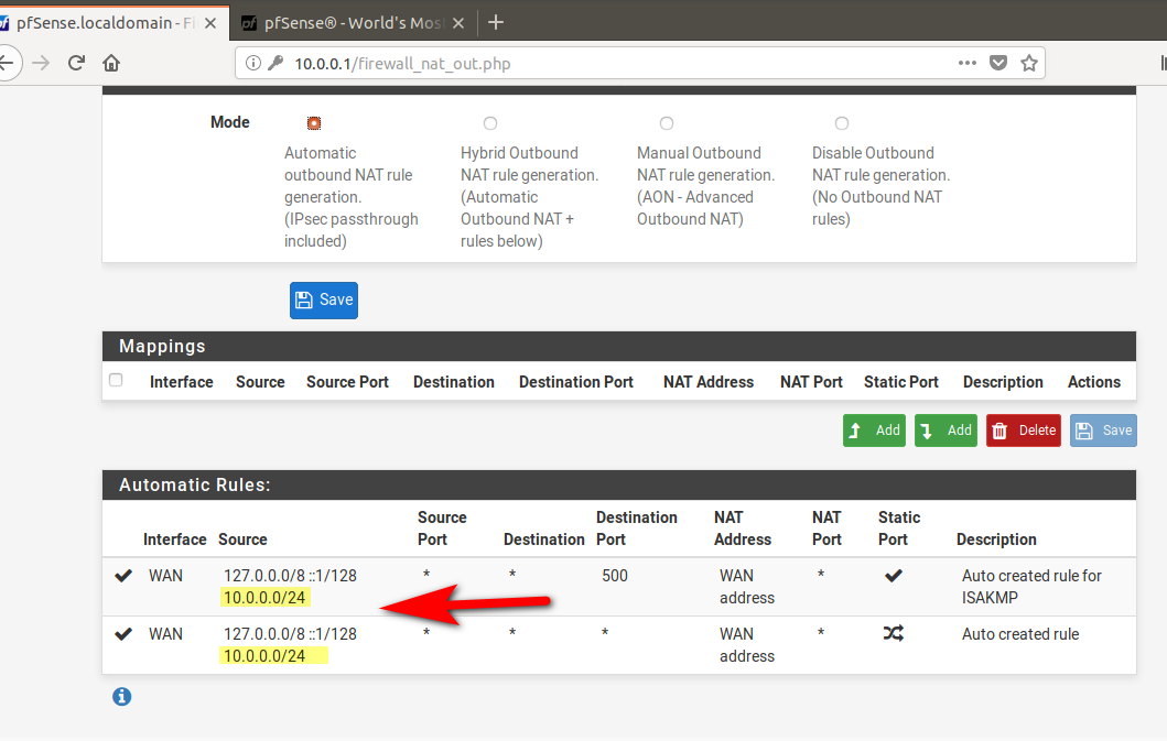

                                      edit-
                                      also want to mention I realized Hyper V created this weird Default Switch which is greyed out it state the Default network switch automatically gives virtual machines access to the computer's network using NAT. Any idea if I should be doing this for anything? When I look at it from the host it has a 172.18.19.255 255.255.255.240 network.
                                        And you did a clean install of pfsense with a wan and lan switch in hyper-v?

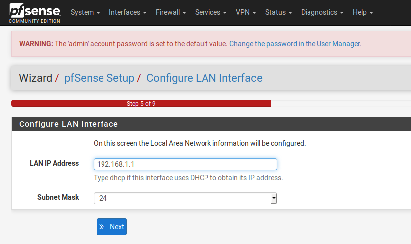

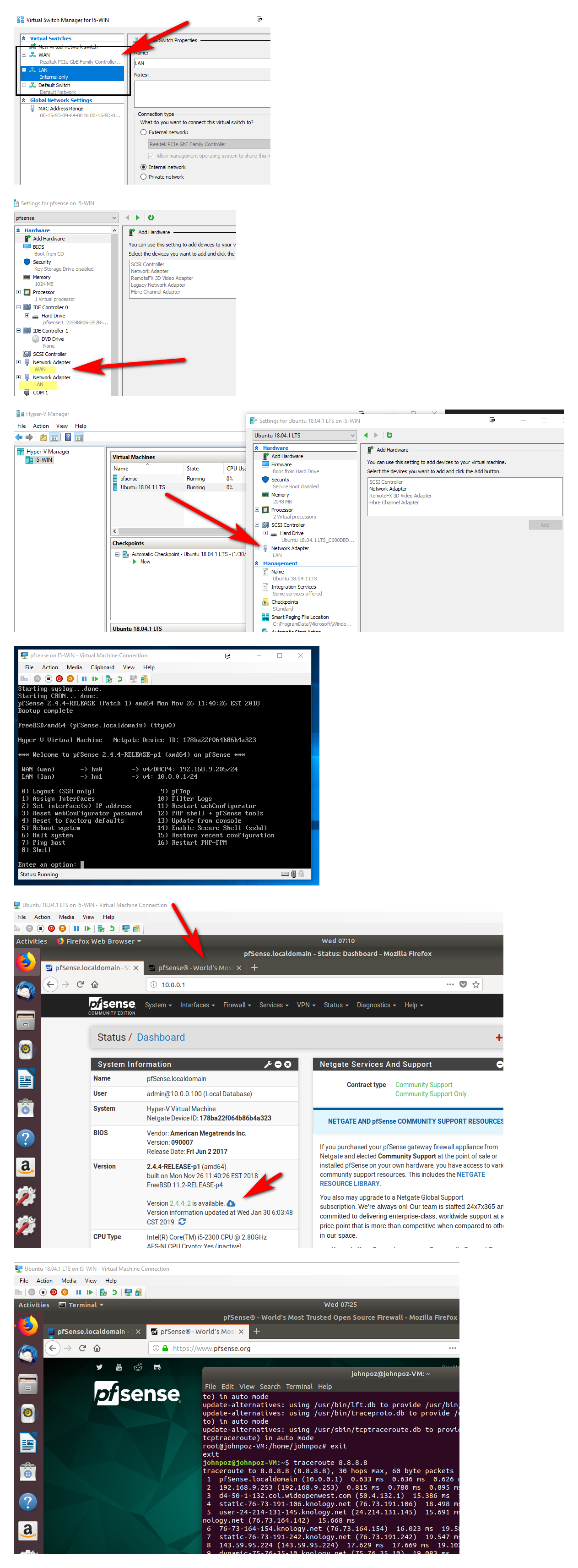

                                        Here this is how freaking drop dead simple this is..
                                        Created my wan external switch, connected to nic on my host machine.
                                        Created an internal vswitch (only for vms)
                                        Did a pfsense vm, 2 nic 1 on wan switch, other on lan switch. even set my lan IP to be the same as yours 10.0.0.1/24
                                        Fired up test vm on the internal switch.. It got IP from pfsense dhcp, can access the gui, internet.. If it takes you more than 5 minutes to set this all up you have something wrong..
                                        You can see pfsense sees there is update available - so it can get to the internet.. client can get to the internet through pfsense.. See the traceroute.
                                          @korr2221 said in Setting up a home lab- need NAT to have internal virtual switch to go into the internet:
                                          LAN 127.0.0.0/8 ::1/128 * * 500 LAN address * Auto created rule for ISAKMP
                                          LAN 127.0.0.0/8 ::1/128 * * * LAN address * Auto created rule
                                          That is Never going to work!!! Where is your local network? 10.0.0/24
                                          Here is mine just setup
                                          You got something broke if its not creating the automatic NAT for your lan network.
                                          You set a GATEWAY on your LAN interface didn't you to what its OWN address... Pfsense clearly NOT to do that!!!!
                                          GW_LAN LAN 10.0.0.1 10.0.0.1 Interface lan Gateway
                                          How could you think that would work???
                                          I just went through the wizard again... It doesn't even give you a option to set the gateway on the LAN... You have to go OUT OF YOUR WAY to do that... And then NOT read the info that clearly says NOT to set a gateway if its the local network and not your wan..
