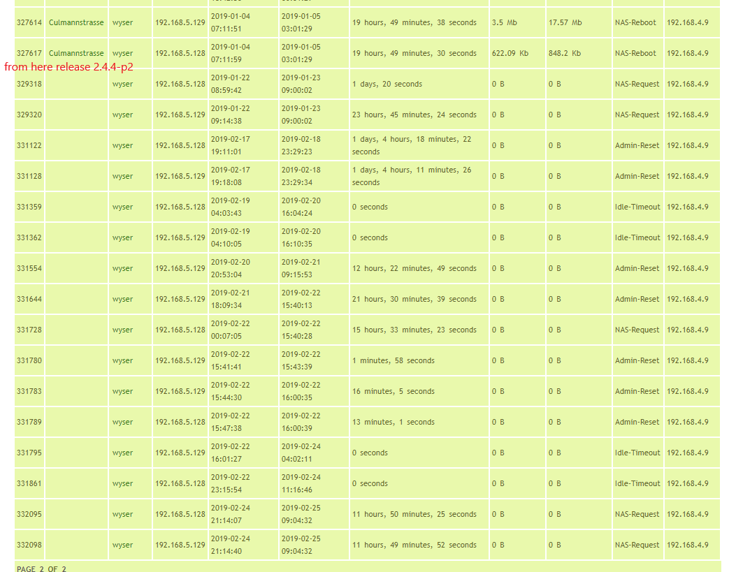

              Something isn't working with CP and RADIUS really since realease 2.4.4-p2.
              As I wrote, we have 3 three synchronized RADIUS servers. Since 2.4.4-p2 users can login correctly. After about 24 hours (potentially idle logout) users are stopped on RADIUS, accounting isn't set correctly and they aren't logged out on captive portal. Please check the RADIUS accounting log attached.
              If users open their browser the directly get the "redirect to..." page in a loop without redirecting really. If I check CP status I see that "last activity" is equal to "session start".
              If I logout the user in pfsense manually. The user can login as usual until the same behaviour rebegins.
              On an other pfsense on another hotspot (other building) with release 2.4.4 (not p1/p2) using same RADIUS servers are working as usual.
              For us is CP on 2.4.4-p2 not usable. I had to disable CP.
