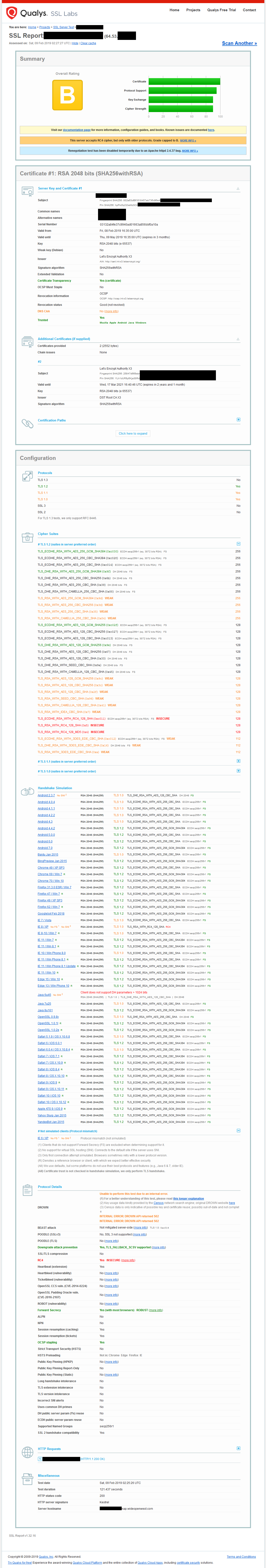

            edit: ok I just disabled my openvpn server on 443 and setup a frontend using the same cert to send to my backend and tested... I would think out of the box just clicking go a B is pretty good.
            Lets see your results.. I will play with this a bit and see if can get to an A without much issue - I had saw where I could easy restrict to tls 1.2, etc. etc.. But since I lock this down to only my friends an family to access ombi to request stuff for my plex I wasn't too worry about it, etc.. But his is good excuse to set it up with better settings ;)

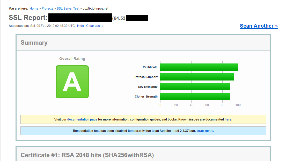

              Ok that took all of a couple of minutes
              Quick google for hardening ha proxy.. Quick copy paste in the global settings. And now A rating.
              ssl-default-bind-options no-sslv3 no-tls-tickets
              ssl-default-bind-ciphers ECDHE-RSA-AES128-GCM-SHA256:ECDHE-ECDSA-AES128-GCM-SHA256:ECDHE-RSA-AES256-GCM-SHA384:ECDHE-ECDSA-AES256-GCM-SHA384:DHE-RSA-AES128-GCM-SHA256:DHE-DSS-AES128-GCM-SHA256:kEDH+AESGCM:ECDHE-RSA-AES128-SHA256:ECDHE-ECDSA-AES128-SHA256:ECDHE-RSA-AES128-SHA:ECDHE-ECDSA-AES128-SHA:ECDHE-RSA-AES256-SHA384:ECDHE-ECDSA-AES256-SHA384:ECDHE-RSA-AES256-SHA:ECDHE-ECDSA-AES256-SHA:DHE-RSA-AES128-SHA256:DHE-RSA-AES128-SHA:DHE-DSS-AES128-SHA256:DHE-RSA-AES256-SHA256:DHE-DSS-AES256-SHA:DHE-RSA-AES256-SHA:AES128-GCM-SHA256:AES256-GCM-SHA384:AES128-SHA256:AES256-SHA256:AES128-SHA:AES256-SHA:AES:CAMELLIA:DES-CBC3-SHA:!aNULL:!eNULL:!EXPORT:!DES:!RC4:!MD5:!PSK:!aECDH:!EDH-DSS-DES-CBC3-SHA:!EDH-RSA-DES-CBC3-SHA:!KRB5-DES-CBC3-SHA
              So post up what your concerned about in your report and we can discuss.
              I will for sure look into it deeper, but that was a quick jump from B to A with simple copy paste ;)

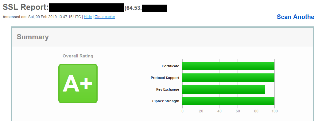

                Ok played with it a bit more and up to A+ with some minor tweaks, enabled CAA in my dns record, turned on HSTS

                          edit: BTW a few other tweaks, and now 100 across the board.. I removed the 128s from what moz suggest as ciphers, this gets you to 100 on ciphers.. And if your use 4096 or higher AND you set ecdhe secp384r1
                          So in my advanced I have set
                          alpn h2 ecdhe secp384r1
                          You should get A+ with 100 across
                          With no need to PIN ;)

                            thanks for the clarification, and the links has helped me a lot to learn more about the subject. I agree and now I have an A+ too! thanks again
