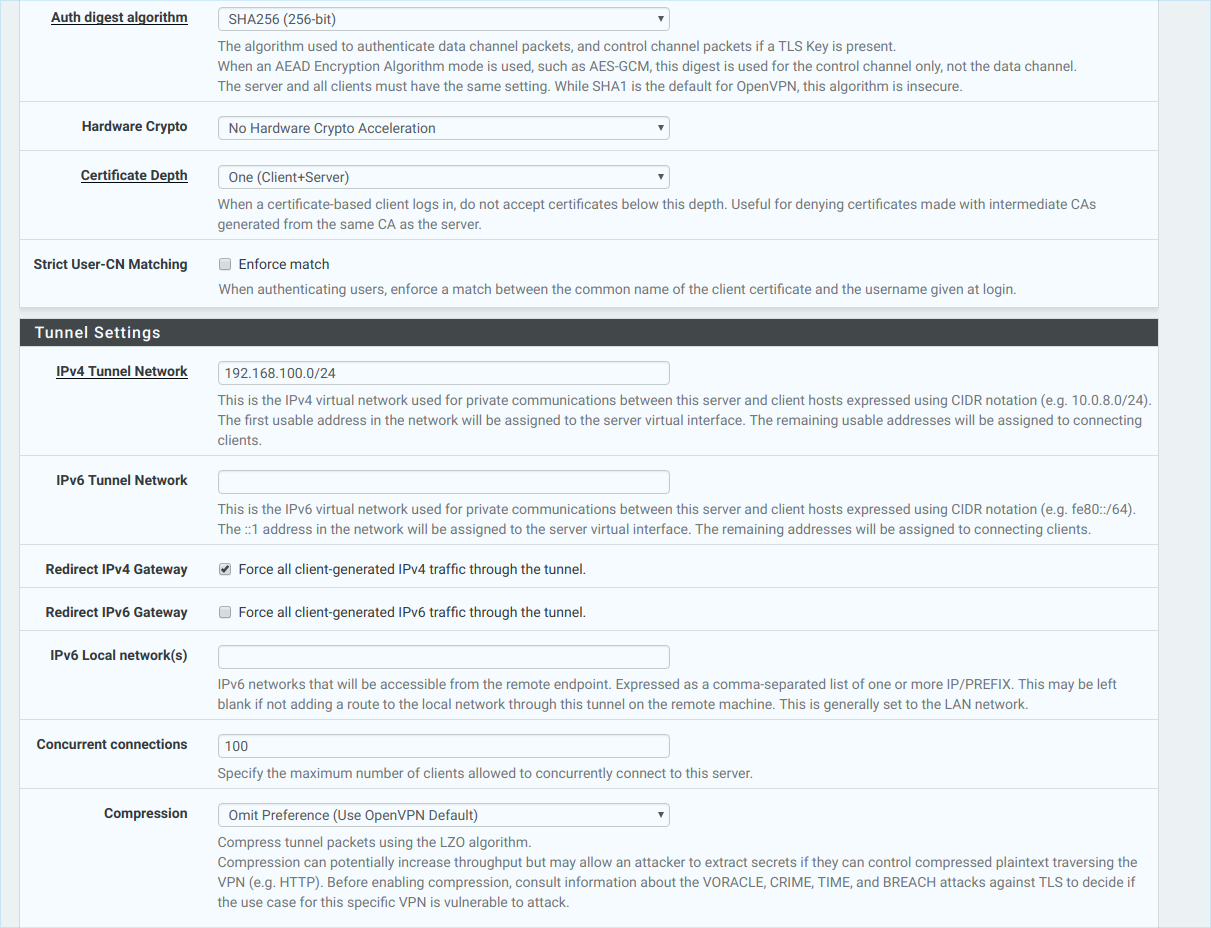

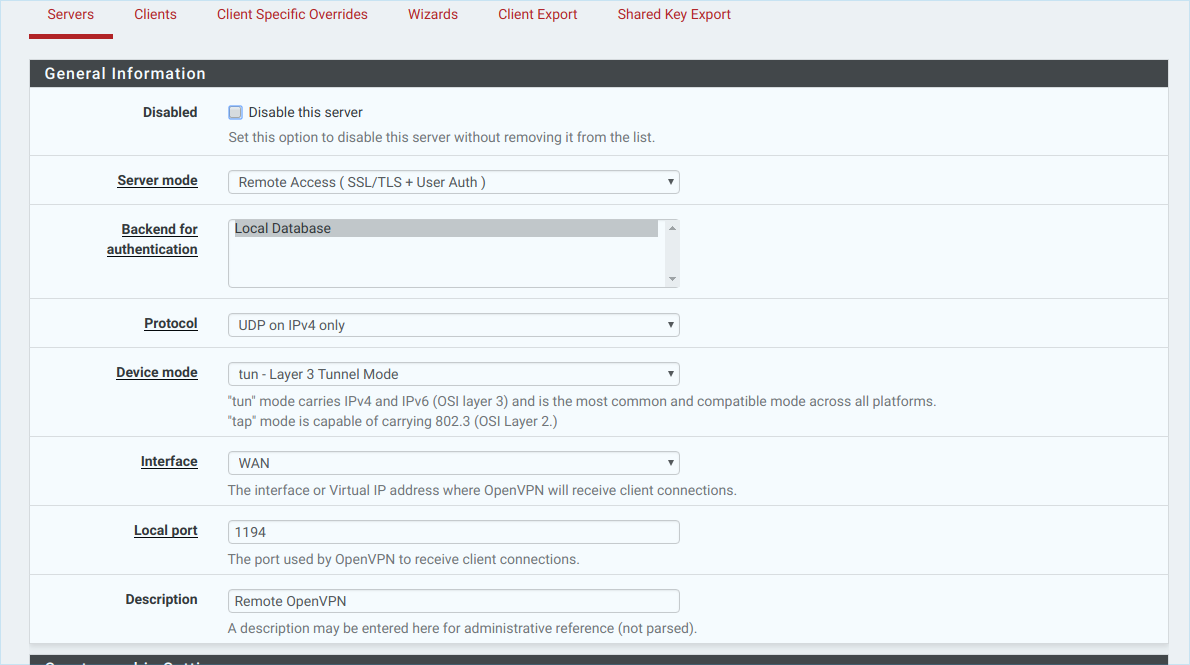

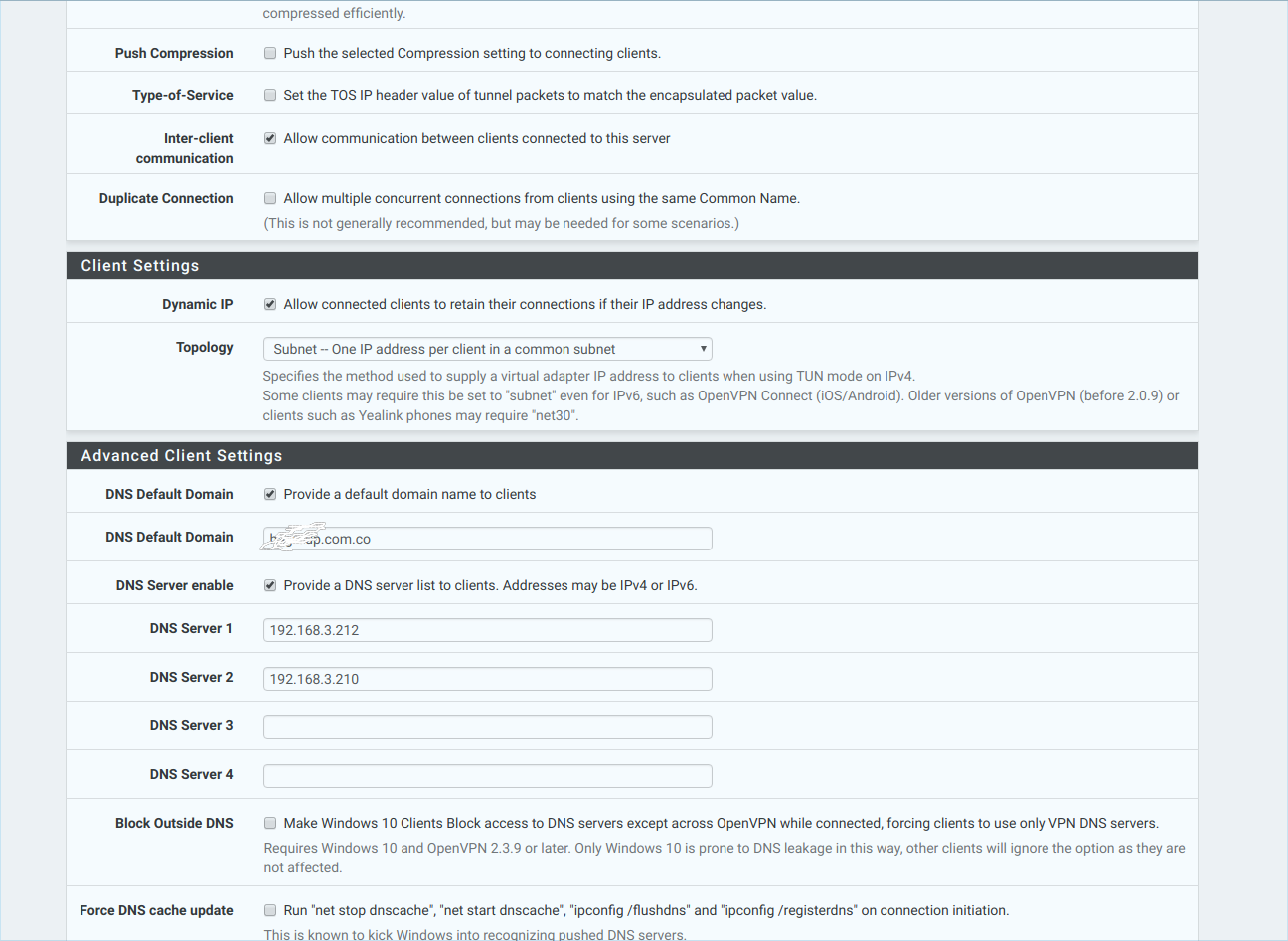

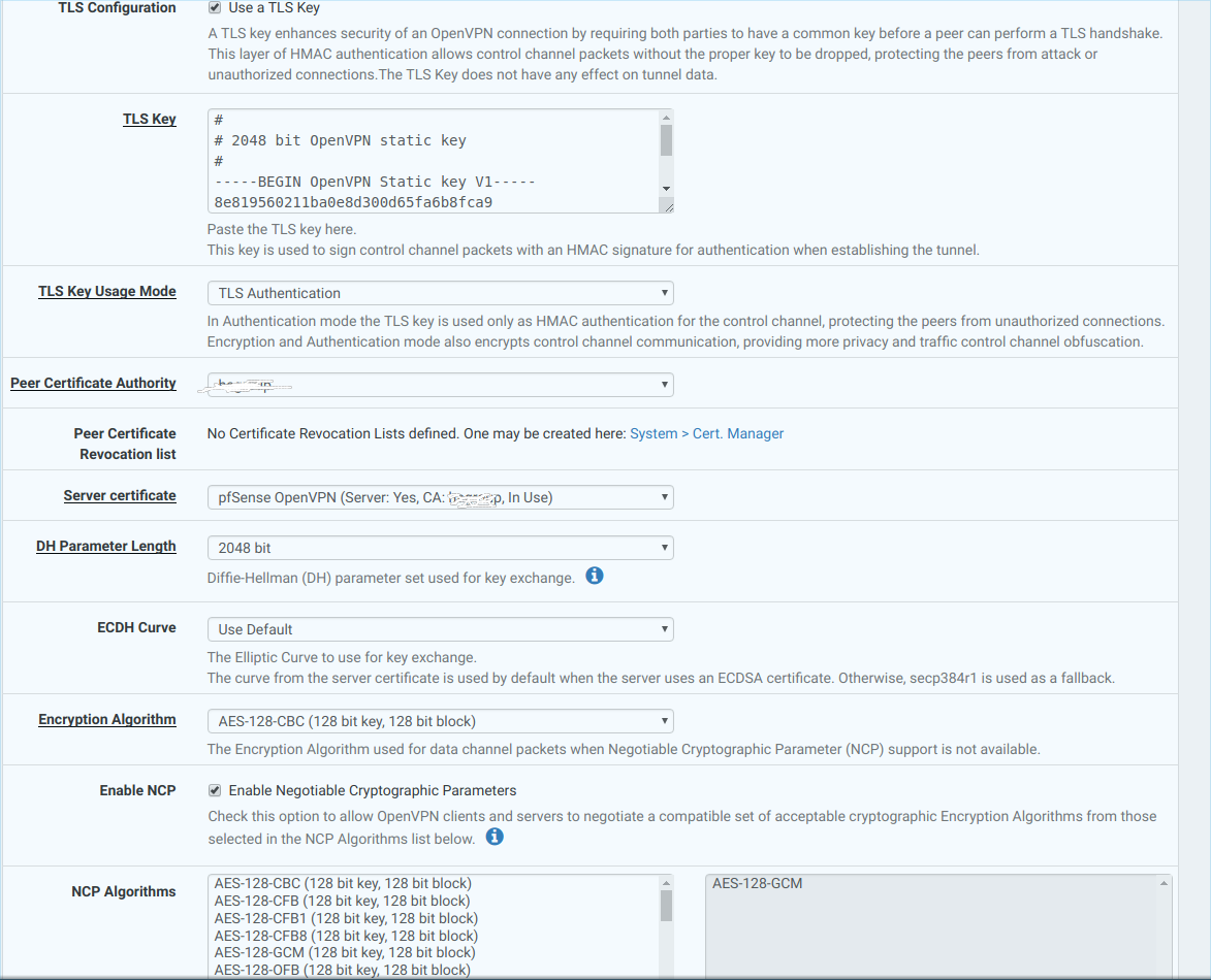

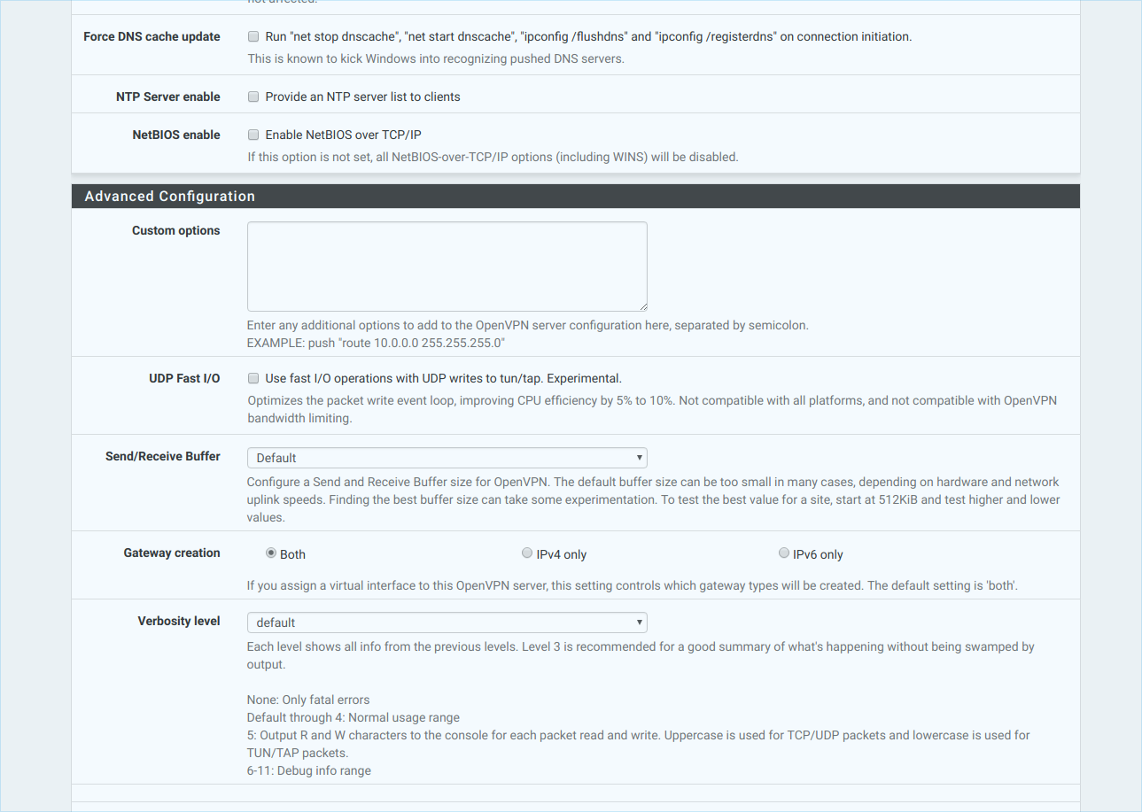

Thanks for the reply, im attaching pictures of my server OpenVPN

Please share your Client Config file.
