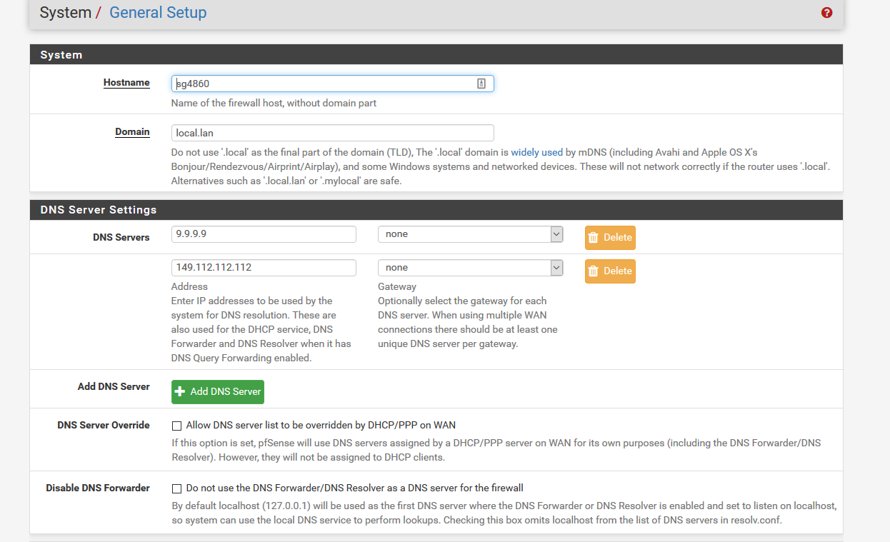

        @johnpoz
        2.4.4-RELEASE-p2
        DNS server(s)
        127.0.0.1
        9.9.9.9
        149.112.112.112
        Resolver setup https://snag.gy/6MoRP1.jpg
        I run OpenVNP server but no clients and don't think have traffic l going over.
        Thx

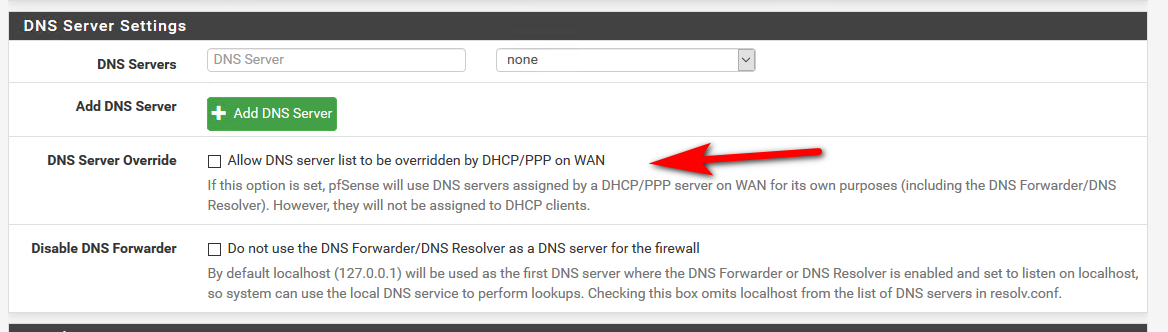

                My "Allow DNS server list to be overridden by DHCP/PPP on WAN" is unchecked

                                      I even did a query for that entry you posted up.. Notice nothing about insecure... No errors about tcp errors, etc..
                                      Post up your dns servers you set - you didn't set a gateway did you?
                                      Again for what possible reason or you running TLS local for??? That is just pointless!!! Who would be sniffing your dns traffic locally???
                                      unbound unbound 94103 52 tcp4 127.0.0.1:853 :
                                      Turn that OFF!!! Does that remove your errors?

                                        @johnpoz ok ok done :)
                                        DNS Server Settings =>
                                        https://snag.gy/g3bnED.jpg
