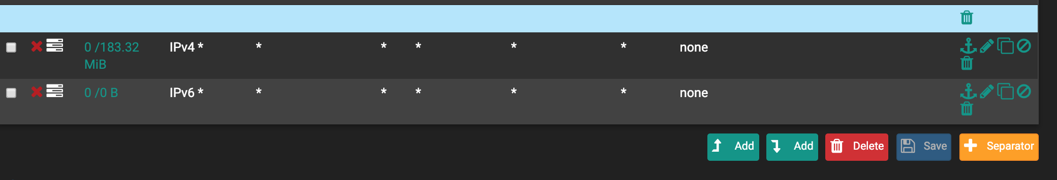

                        ix0 is the WAN interface ??
                        If you create a rule like the one in the picture, will it block IGMP ?

                            Yes, ix0 is the wan for sure (wan2 actually). I don't think I want to create that kind of rule without being on site. I will try it, but don't want to cause any undue issues while they are working and I am off site.
