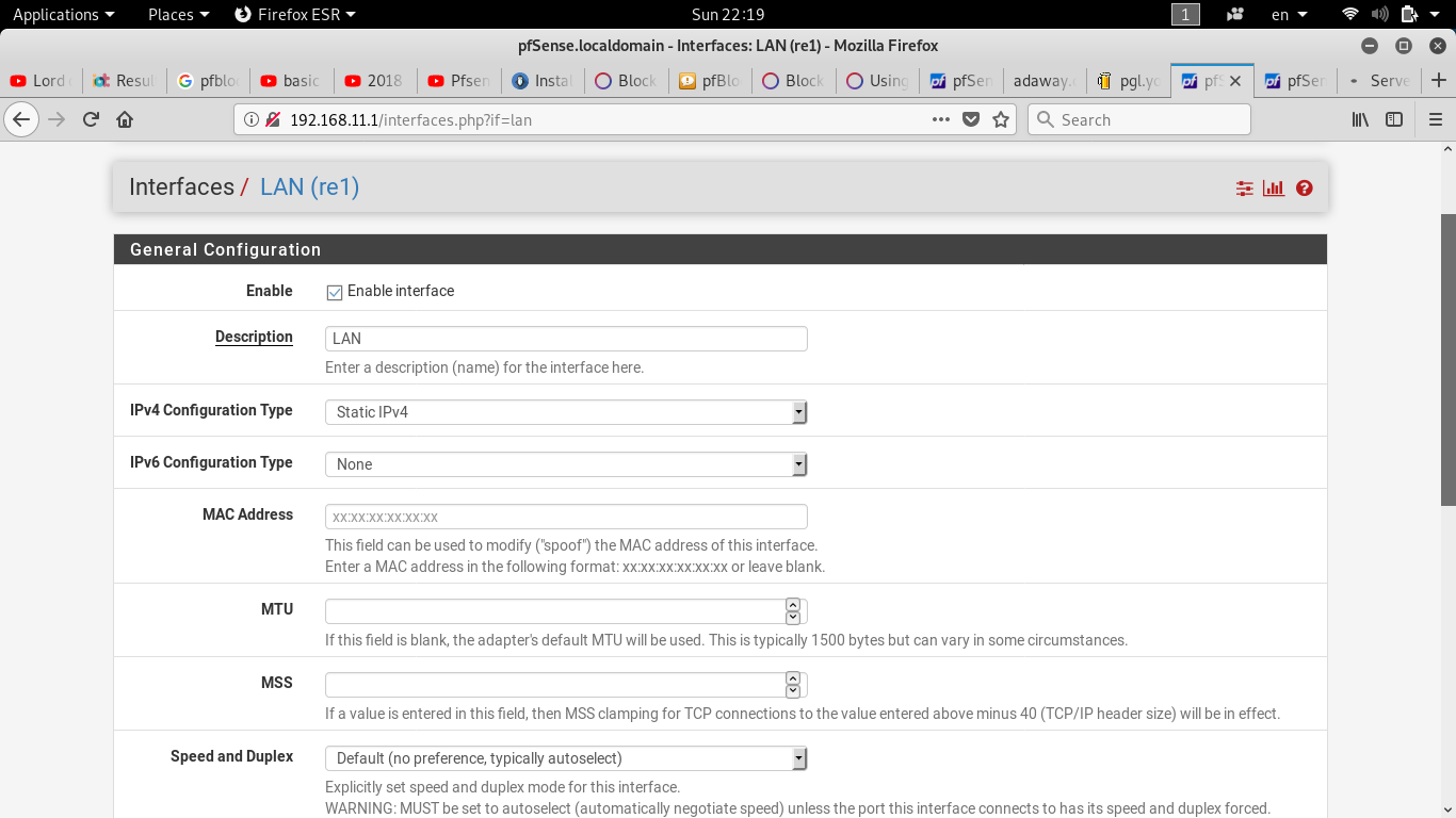

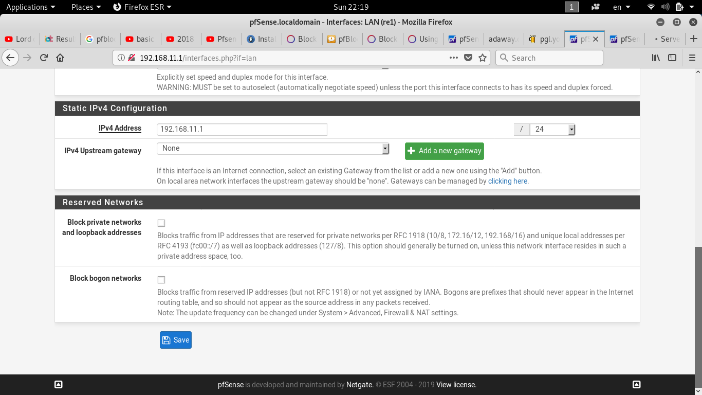

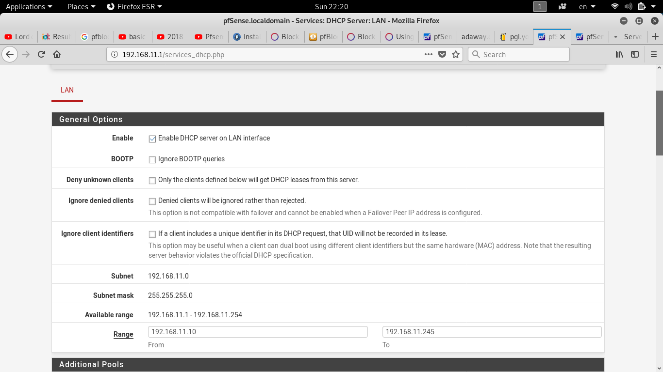

Hello, my name is Coach. I am new to PfSense and I have watched many tutorial videos from youtube and follow many instructions on websites. Also I have made the factory default so many times, please give me detailed advice about my below configuration screenshots.

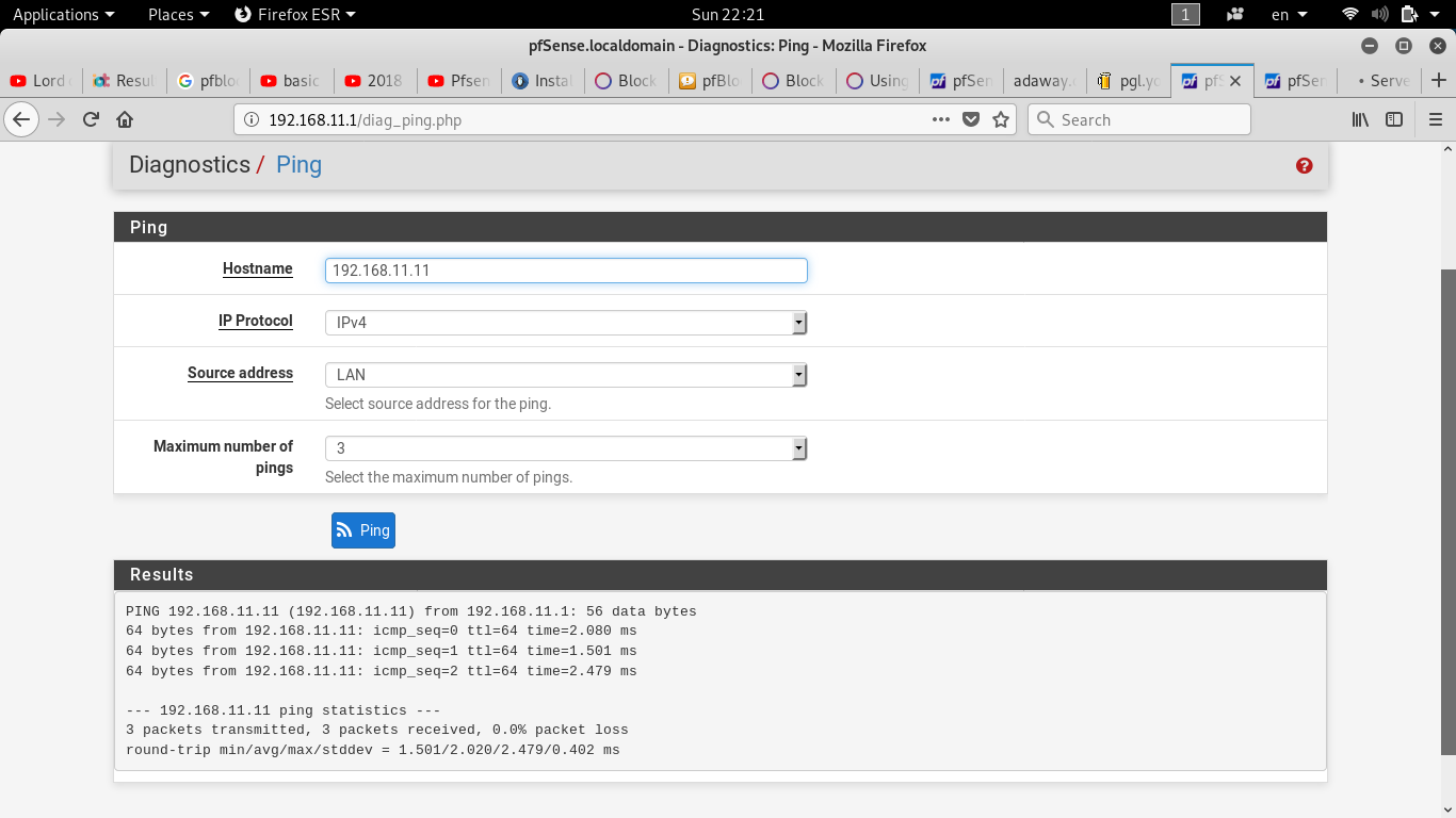

P.S: When I ping from both WAN and LAN to www.yahoo.com it is worked, also from LAN interface to Client (192.168.11.11) it worked.
Thanks,
Best regards, -

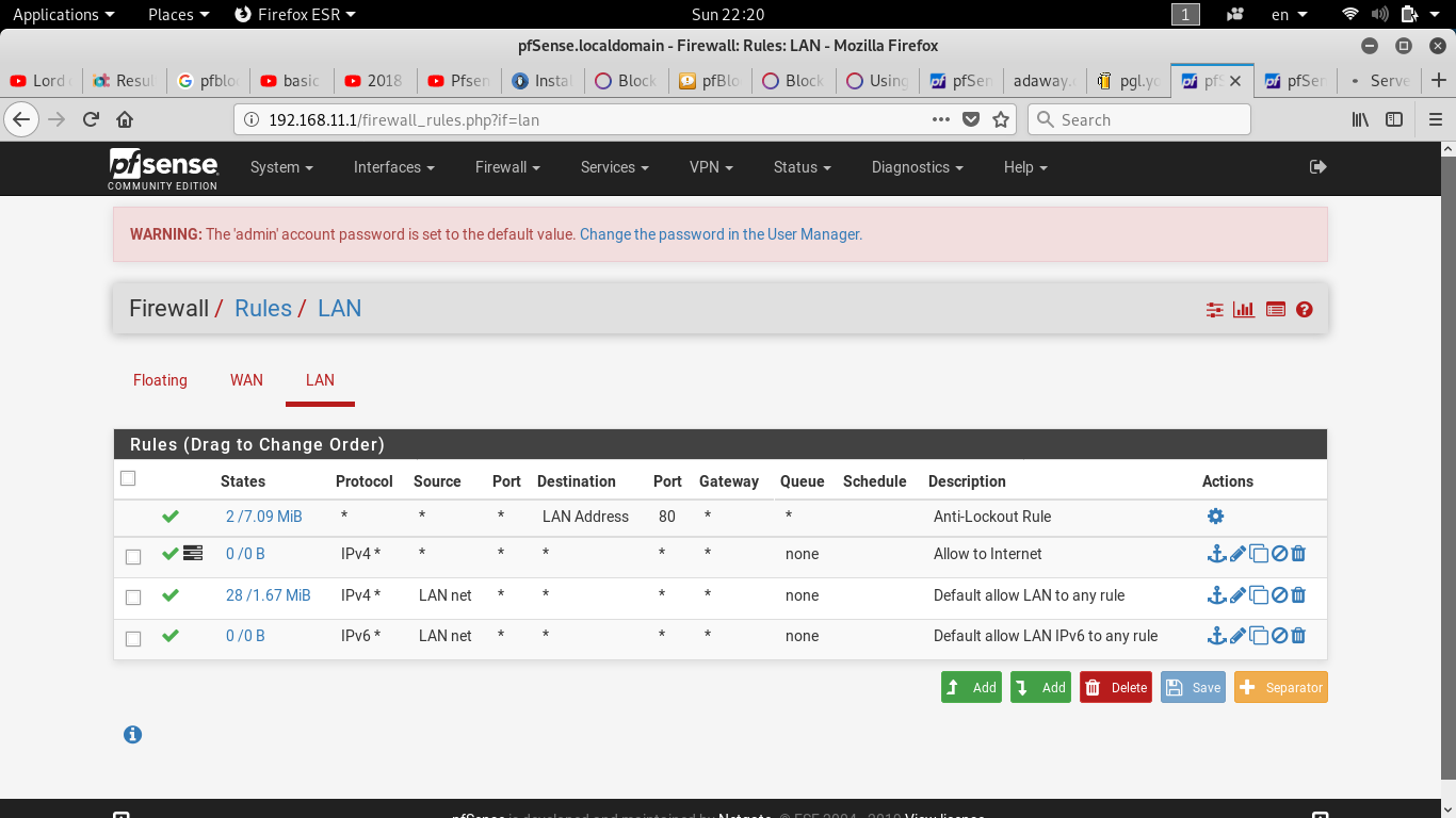

What do you try to achieve with this rule ?
The 0/0 in front of it means : no traffic matched this rule.
The next IPv4 'default' pass rule accepts all traffic, thus also all traffic to the internet. -

After I finished the basic configuration wizard, I want to connect to internet from my LAN side. So should I make changes to Services=>DHCP=> gateways and DNS servers? From youtube videos and other guidelines they did not change or configure this to PfSense and able to browse websites easily. I am not sure that I wrote my issue clear, but my main point is, LAN side clients should connect to internet.

No need to change anything elsewhere : pfSense will work.A notable exception is when the upstream router - if one exists - also uses the 192.168.1.0/24 as is LAN.
In that case you change that LAN - or you change the LAN settings on the pfSense LAN interface. -

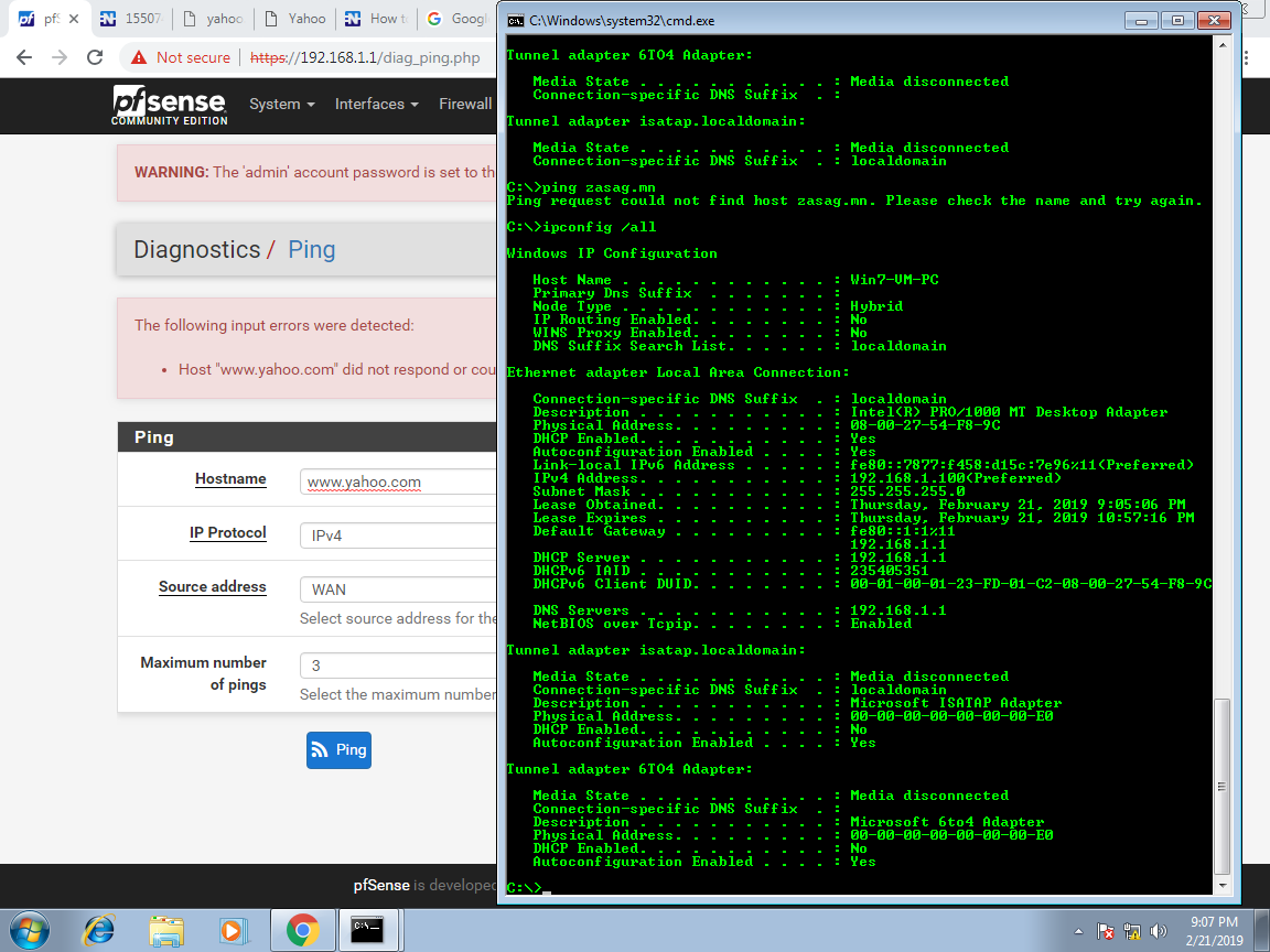

@gertjan I have not changed DNS servers, Gateways on services=>DHCP server (i mean its blank). So the DNS and Default gateway is 192.168.1.1 LAN interface is 192.168.1.0/24
And therefore, when i using ping from client machine to yahoo.com it did not respond, but when i ping to IP address of yahoo, it replied.

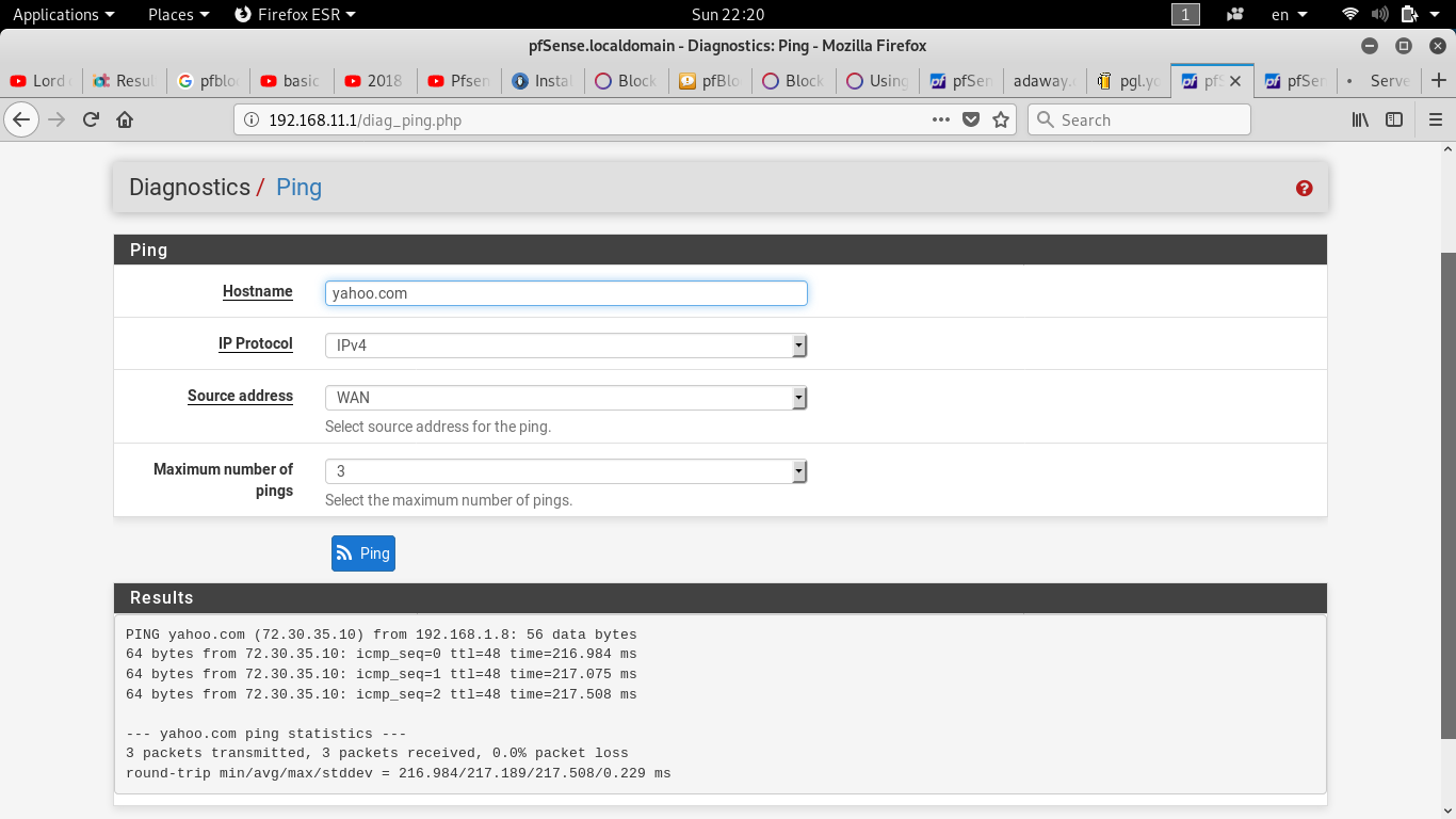

Also from LAN and WAN both interfaces on pfSense webGUI to yahoo.com pinging is replied. So the problem is in DNS configuration on LAN interface I guess, when I add 8.8.8.8 to services=>DHCP server=>DNS servers client machine can connect to internet. What should i do?
So, when you run this :
[2.4.4-RELEASE][admin@pfsense.brit-hotel-fumel.net]/root: ping yahoo.com PING yahoo.com (98.138.219.232): 56 data bytes 64 bytes from 98.138.219.232: icmp_seq=0 ttl=48 time=146.540 ms 64 bytes from 98.138.219.232: icmp_seq=1 ttl=48 time=145.787 msyou have replies - and more important : yahoo.com resolves => the DNS works.
But not from a device on LAN.This means these devices can't contact the DNS Resolver running on pfSense.

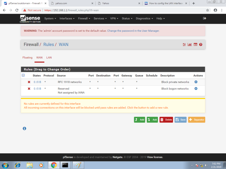

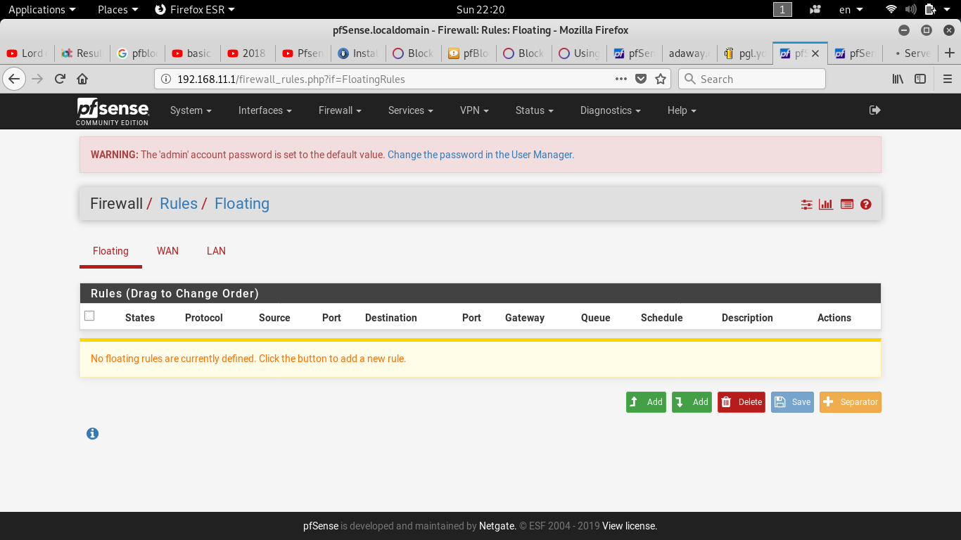

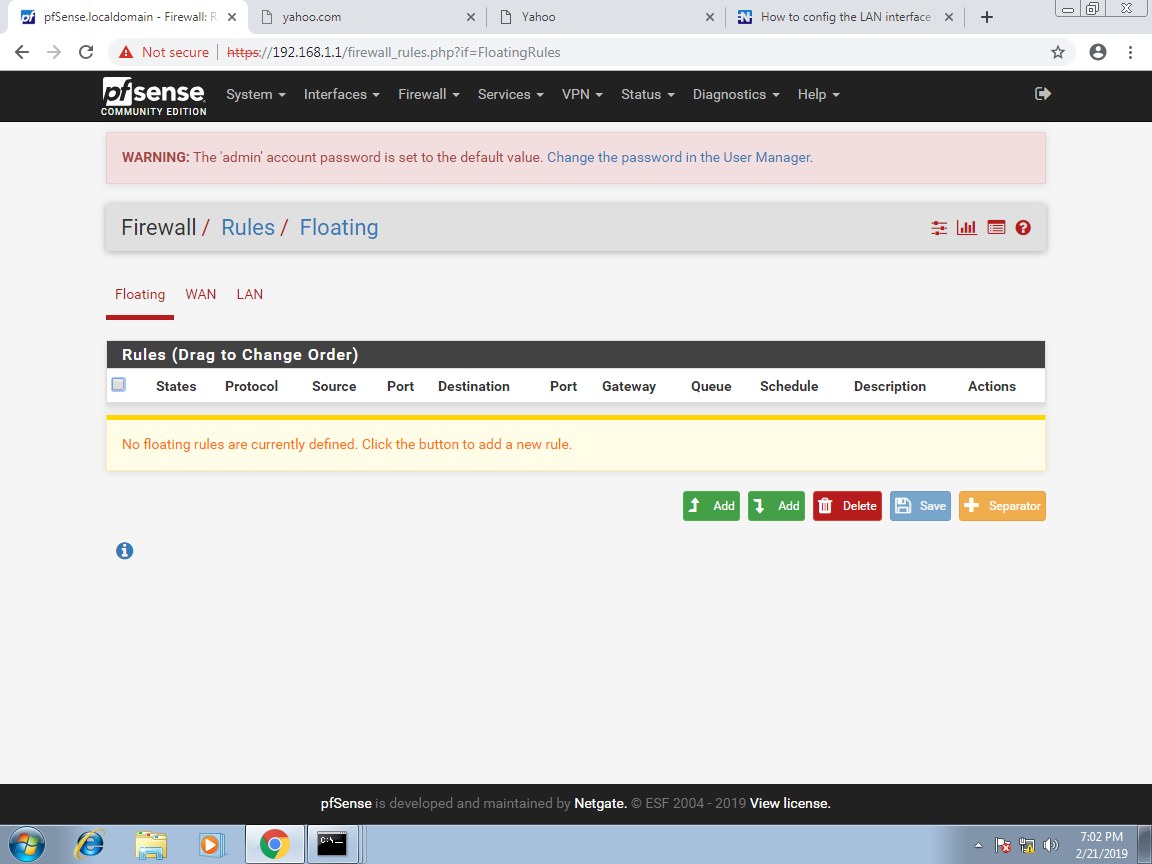

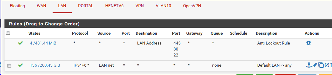

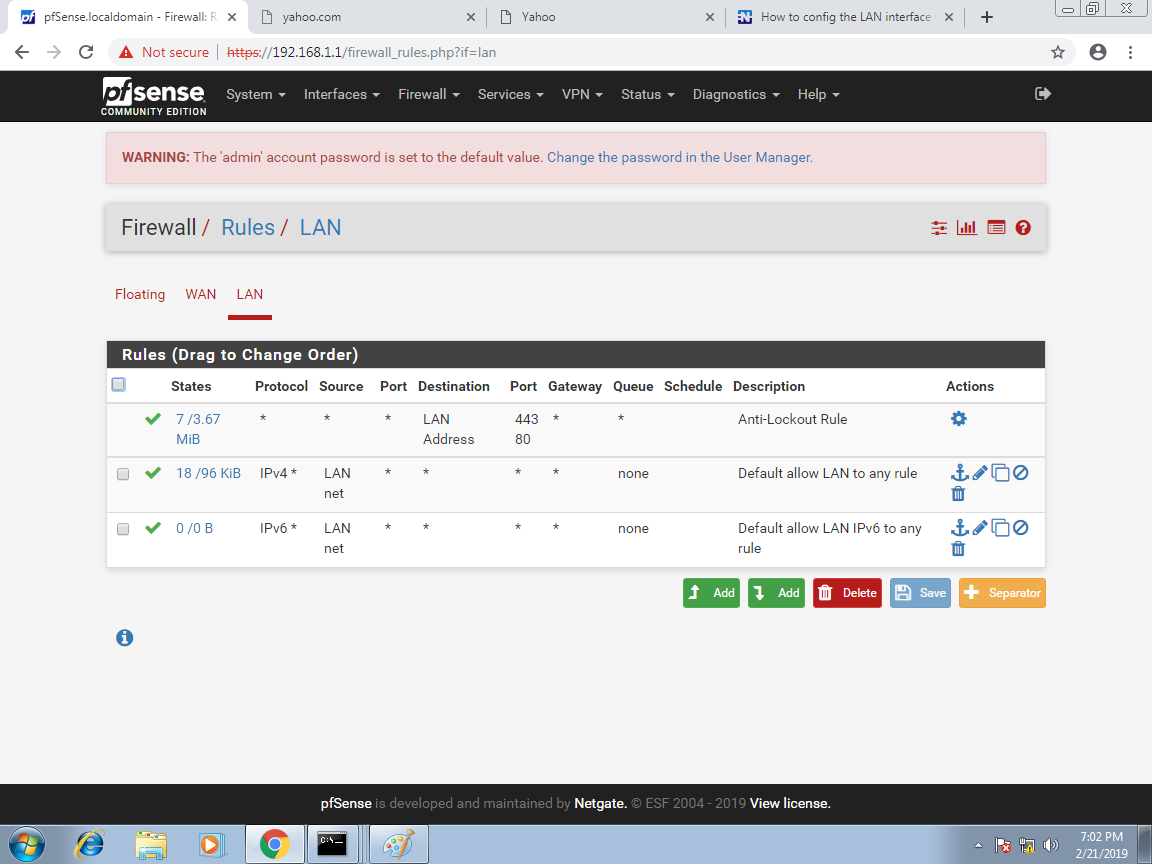

What are your LAN firewall rules ?
Floating rule is
WAN rule is
LAN rule is

Ping from Pfsense wan side to 105.57.94.2 is
Nslookup from client machine to 105.57.94.2 and www.duckduckgo.com is

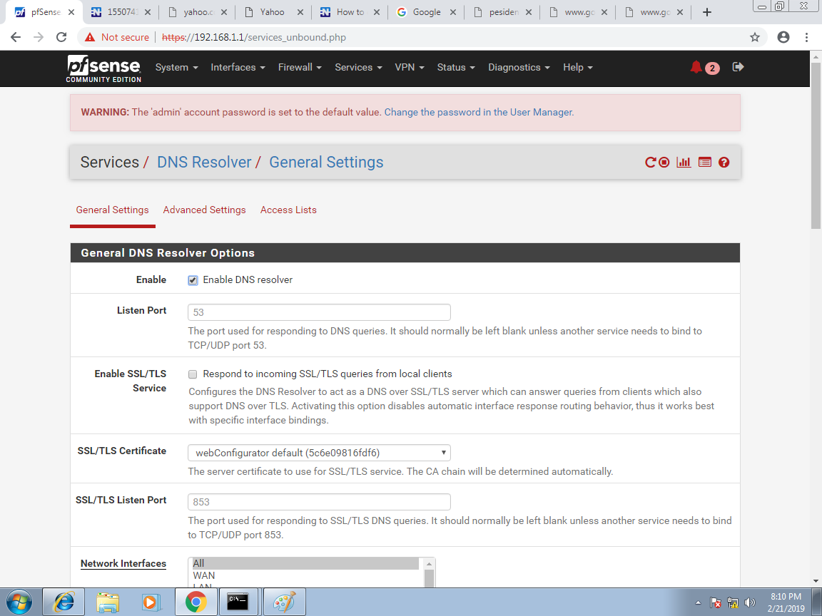

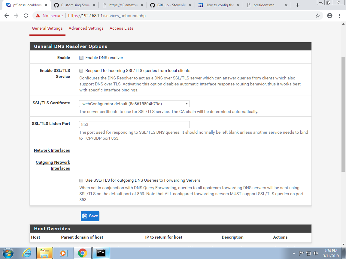

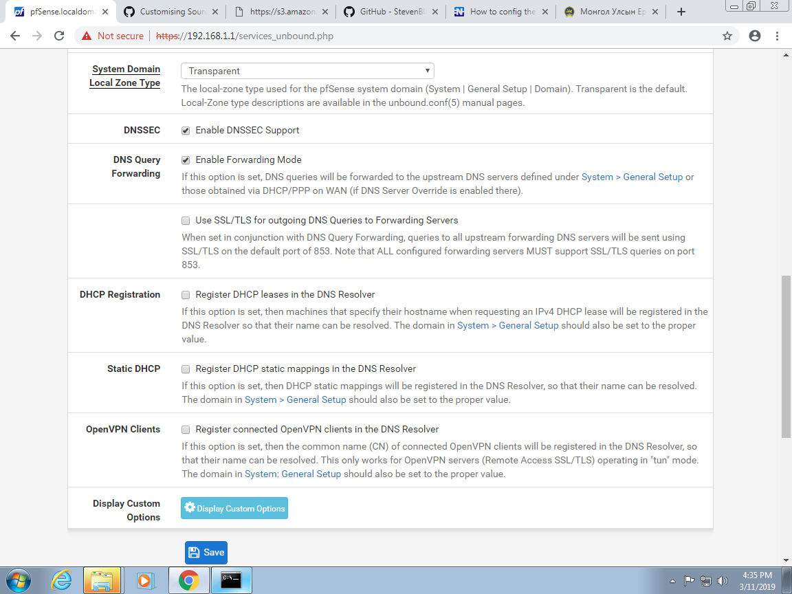

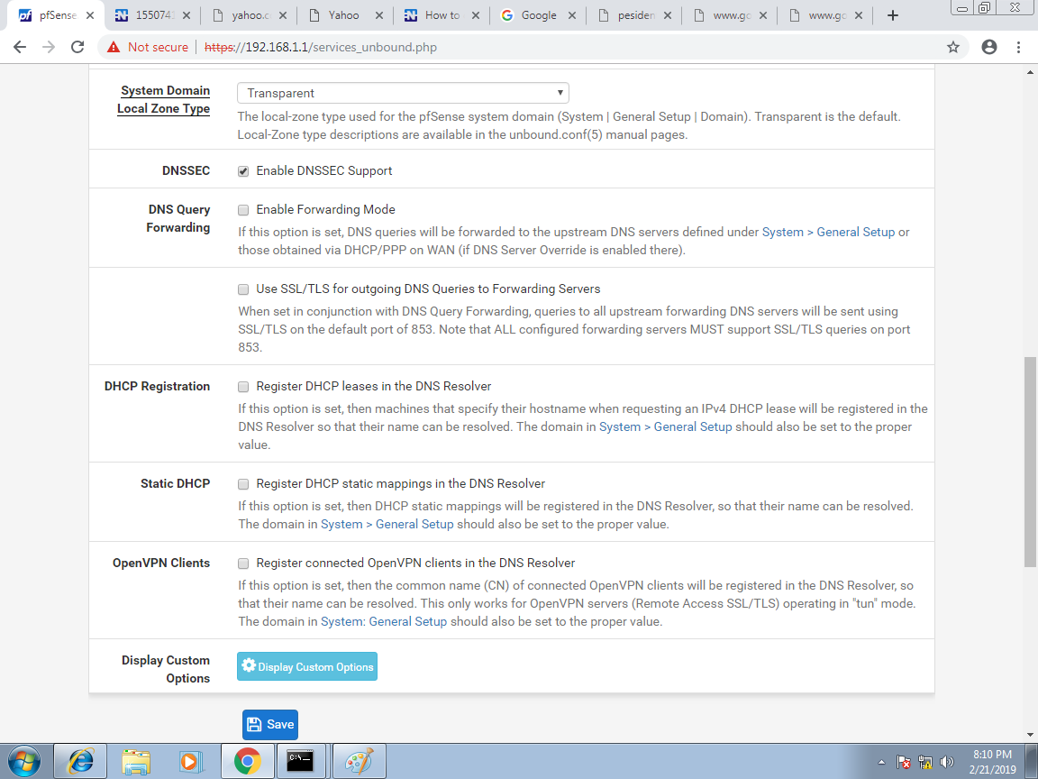

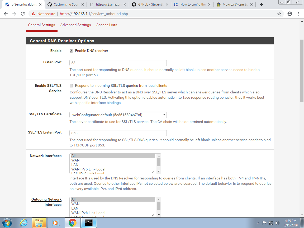

No changes to DNS settings and the DNS resolver config is

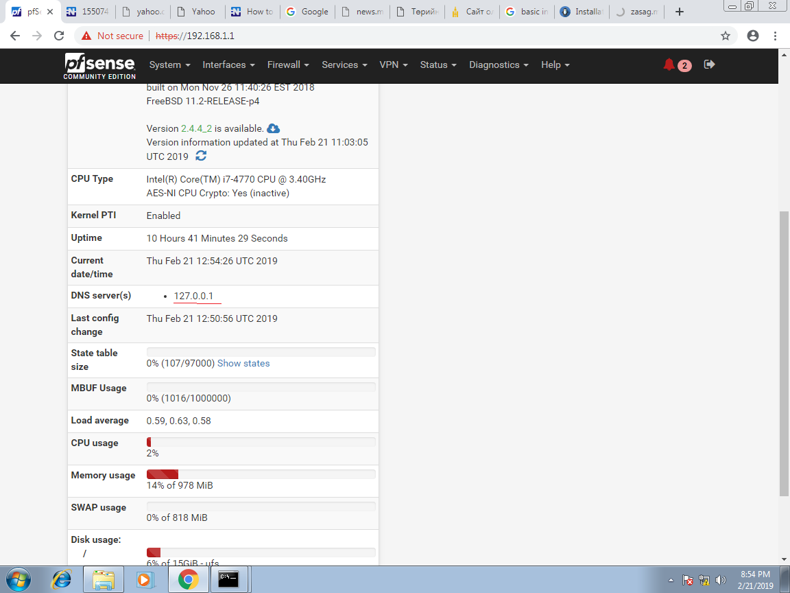

review the first screenshot in the topic (105.57.94.2) is listes as a DNS server. Yes, uncheck that, you have the firewall performing as a DNS server itself (listed as 127.0.0.1). its capable of looking up DNS itself would the use of an upstream DNS server from WAN.

But after that, there is no ping response from WAN side to yahoo.com

If this is working, perform a nslookup on pfsense to confirm you can resolve www.duckduckgo.comwhat are the outgoing DNS interfaces set as in the DNS resolver?
Confirm the following: System-> General Setup
-No DNS servers configured.
-DNS Override UNCHECKED
-Disable DNS Forwarder UNCHECKEDServices -> DNS Forwarder
-Enable DNS Forwarder UNCHECKEDServices -> DNS Resolver
-Enable DNS Resolver CHECKED
-Network Interfaces ALL
-Outgoing Interfaces WAN (or whatever your uplink interface is)
-DNS Query Forwarding UNCHECKEDOn windows:
Ping 8.8.8.8
In a browser, navigate to www.duckduckgo.com, or perform a nslookupOn pfsense
ping 8.8.8.8
perform nslookup for www.duckduckgo.com -

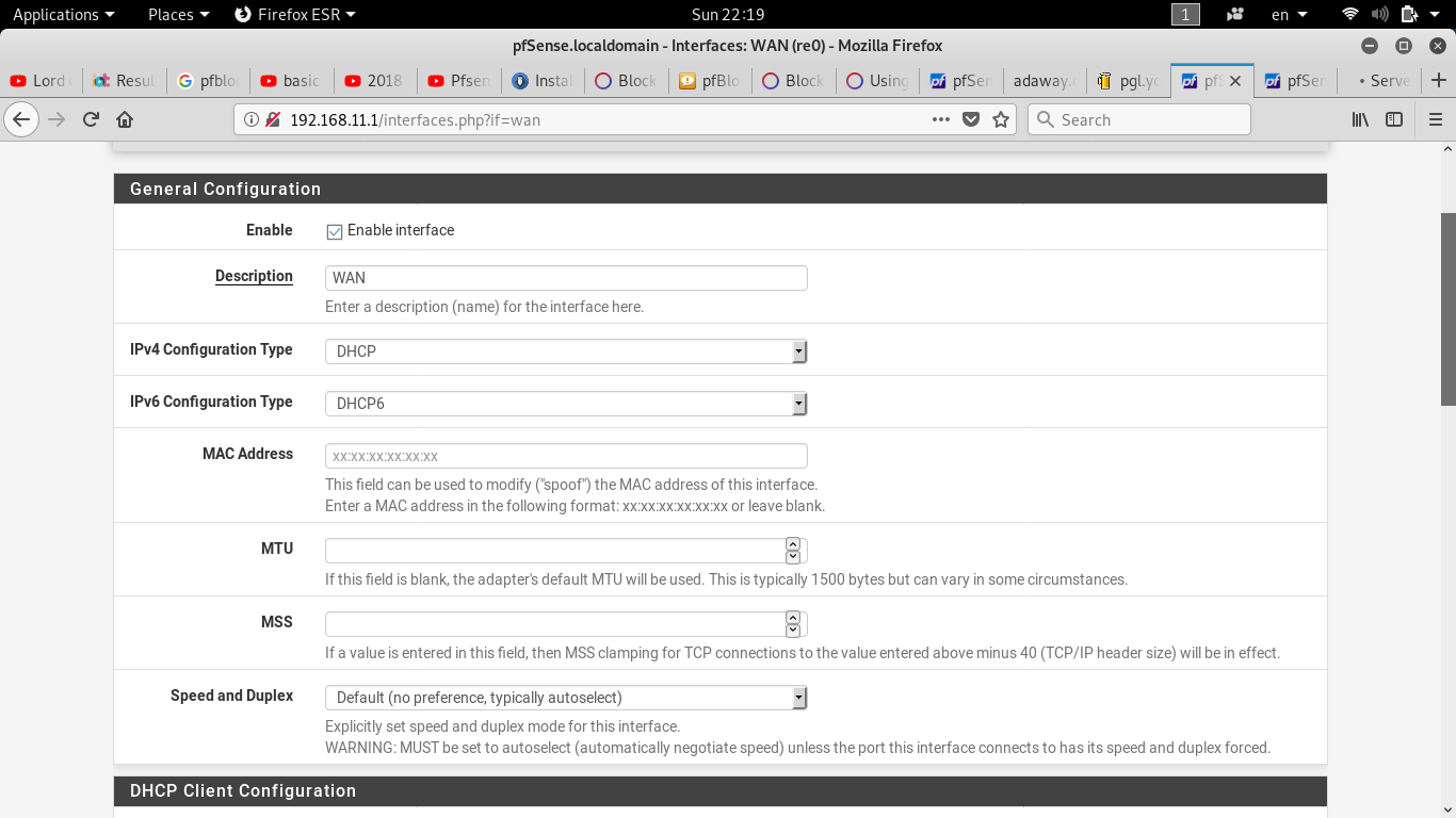

In your first Post your pfSense WAN interface was configured (via DHCP?) to 192.168.1.8.
In later posts it happens to be 10.0.2.15.What is your WAN connection? How do you connect pfSense to your ISP/uplink/Internet? DNS may be a problem, but I think you don't have your WAN running correct. Also if your WAN is indeed a private IP, uncheck the "block private IPs" checkbox on "Interfaces / WAN".
