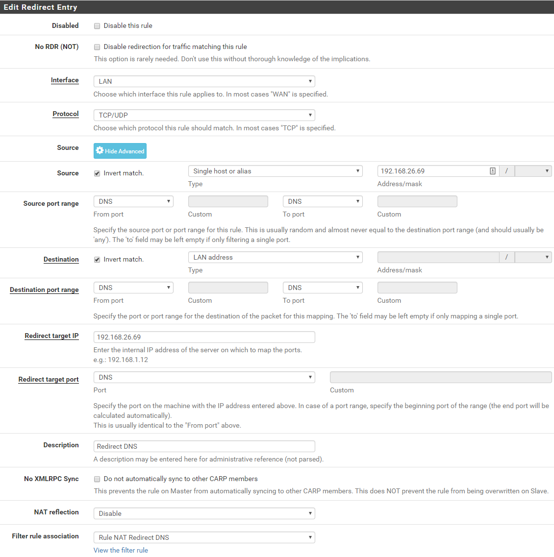

      Hey guys. I'm currently using a PiHole appliance on my network and I wanted to ensure that all DNS traffic on my local network is being forced to route through PiHole. I saw this very informative article that demonstrated how to force DNS traffic through the PfSense firewall itself.
      I assumed I could modify it to instead redirect all DNS traffic to the PiHole, but I have confirmed that I can in fact change my workstation's DNS to 4.2.2.2 as an example and I no longer have Ad Blocking. Please see screenshot for modified firewall rule. I'm probably missing something obvious, so any help will be welcomed. Thanks.
      FYI: My PiHole appliance is using 192.168.26.69.
        you can not redirect traffic like that.. If you want to redirect to your pihole, then put your pihole on a different segment than lan.
        Or redirect to pfsense (be it unbound or dnsmasq your using on pfsense) and then have it ask your pihole. Notice in that article you link to
        "Redirect Target IP: 127.0.0.1"

          Use that doc to force all local DNS to be captured by pfSense. Then either:
          1. Configure DNS Resolver in forwarding mode and set it to use your pihole by putting pihole IP address in System - General Setup - DNS Servers, or
          2. Disable DNS Resolver, enable DNS Forwarder and set it to use your pihole by putting pihole IP address in System - General Setup - DNS Servers

                Middge @KOM
                @kom said in DNS Firewall Rules:
                I tried this and it still let me manually define an external DNS address and Ads were not being blocked. :-(

                  @middge said in DNS Firewall Rules:
                  If you simply are trying to block ads, then why does manually being able to change the DNS setting matter? Simply don't change it. If you are trying to get users you have minimal control over to use a specific DNS provider, then you will want to create some rules on your LAN interface that block everything inbound on TCP and UDP ports 53 unless it is directed at whatever internal DNS you want to use (as others have suggested above, this could be your pfSense box running Unbound in forwarder mode or your pihole server iself). So with this kind of setup, any user who manually changes their DNS server IP will get nothing but DNS lookup timehouts.

                        Middge @bmeeks
                        @bmeeks said in DNS Firewall Rules:
                        This is exactly what I was looking for. Thank you.
                          You're welcome. Just note that this method is not foolproof. If someone has access to a DNS server that uses TLS, then you also would need to block port 853. There are other possibilities as well. For plain vanilla non-skilled users, the method I provided is effective. For someone with a bit of skill and the brains to search on Google, they can eventually find a way around. Then it becomes a whack-a-mole game.
