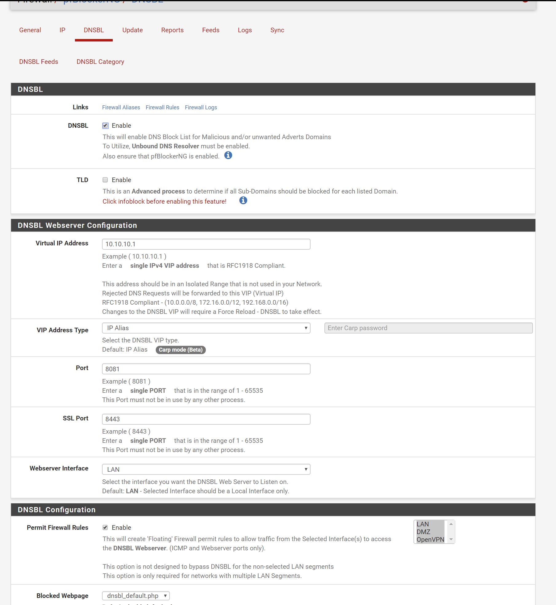

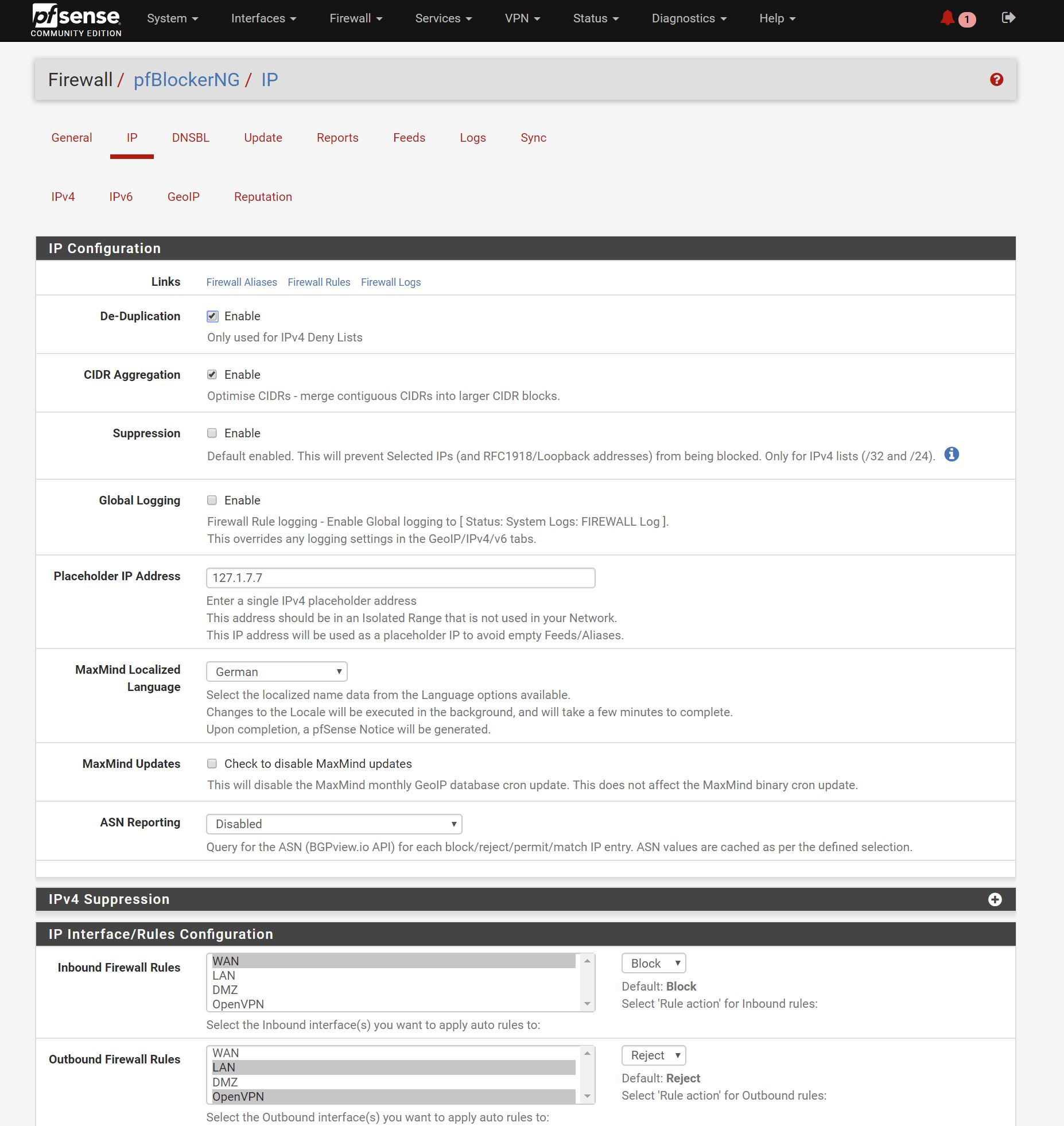

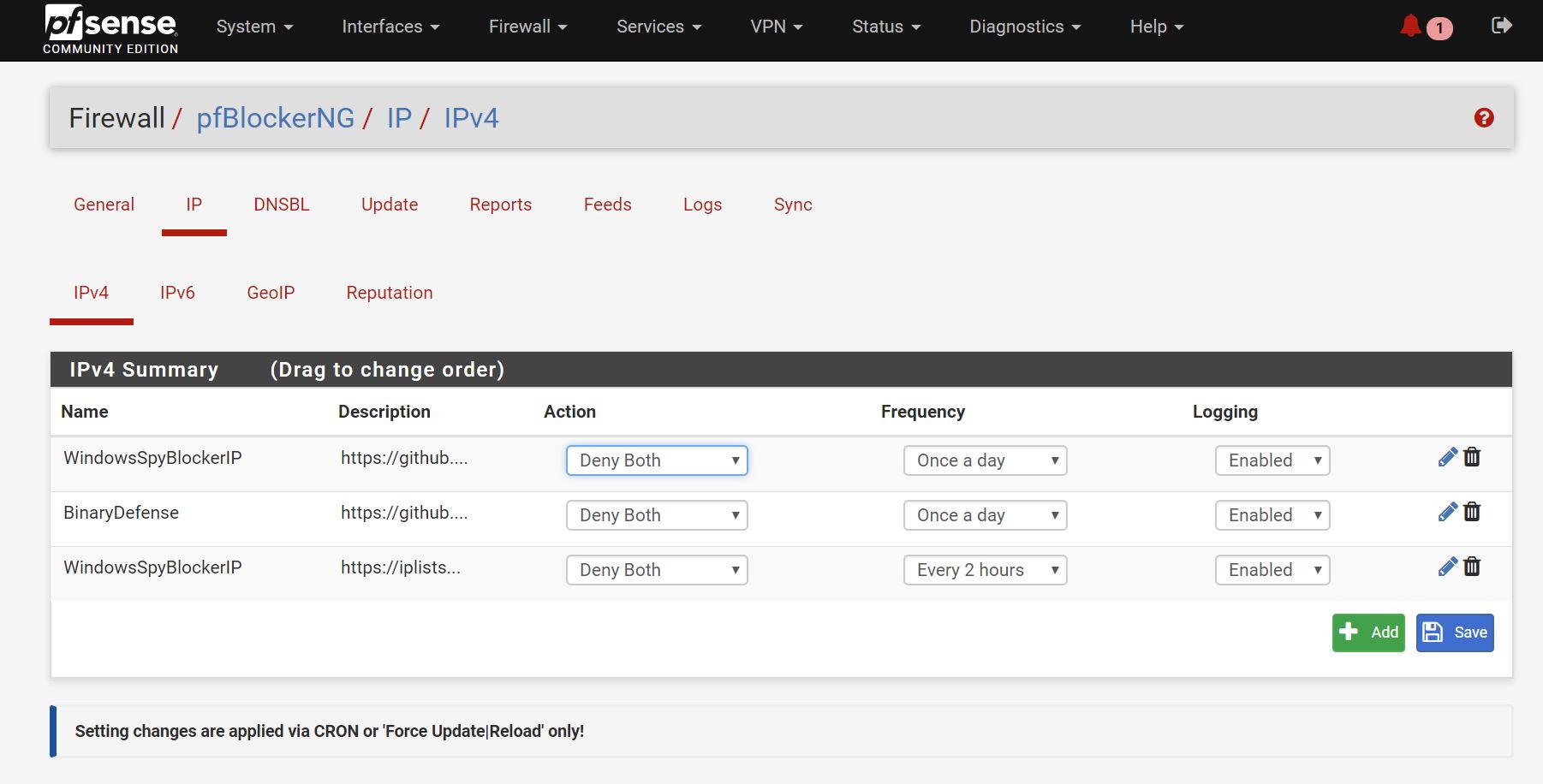

      Hi I recently virtualized pfSense and installed pfBlockerng.
      With activated pfblocker it take about 20 seconds to start loading the page.
      If I turn it off, it is at ~1.5 sec
      any idea what causes this massive delay?
      virtualized with esxi 6.7, running on 1 core, 8gb ram 35gb space.
      ![alt text](3_1551810030383_4.JPG 2_1551810030383_3.JPG 1_1551810030383_2.JPG 0_1551810030382_1.JPG image url)

        Check the Alerts tab to see what is being blocked.
        Try to enable IP blocking first, then enable DNSBL to narrow down which component to review.
        Also there are some Dashboard notices. What do they say?
