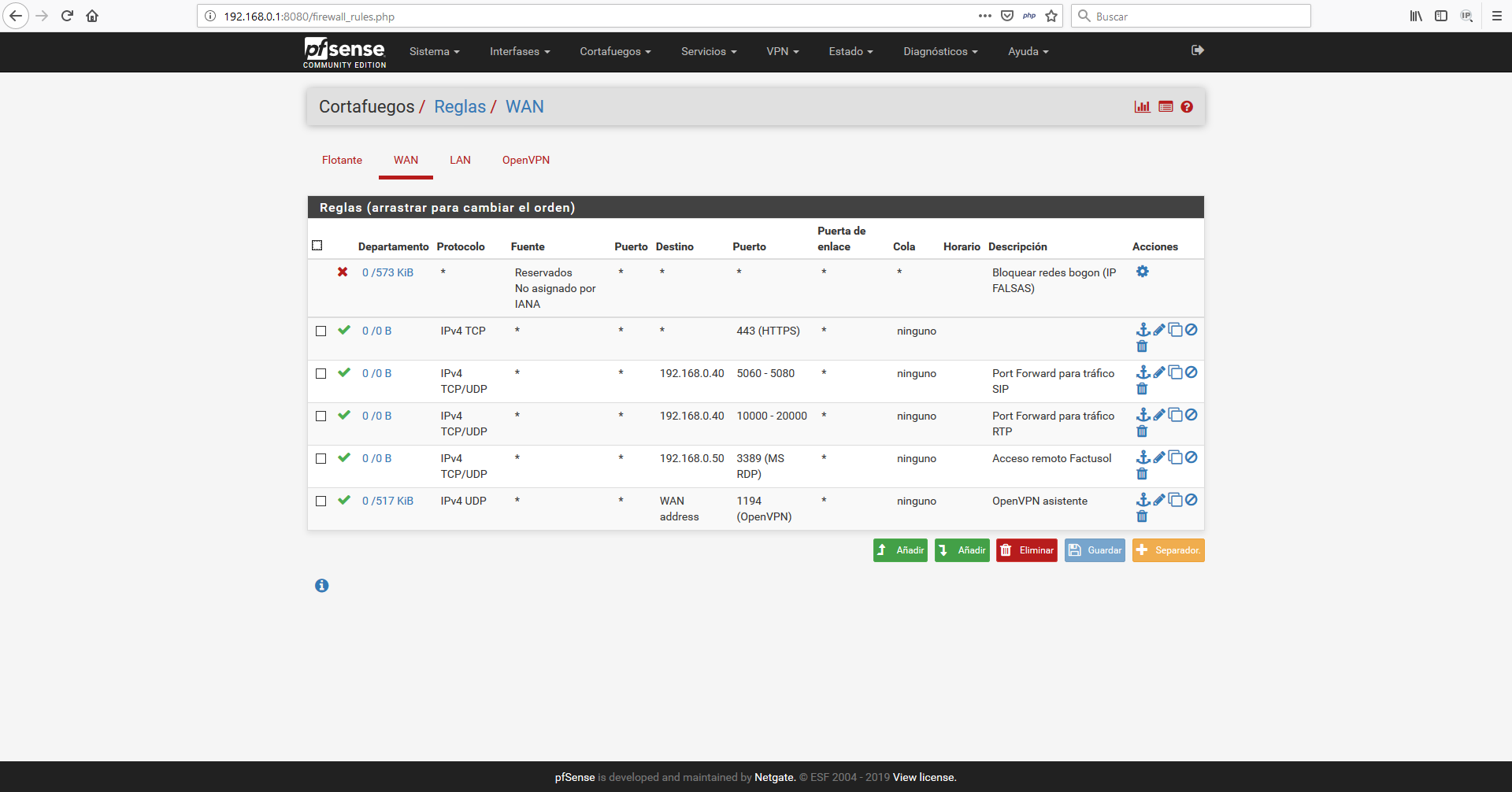

              Pfsense firewall rules: 0_1552289566133_2019-03-11.png
              I remove the NAT por forward in pfsense firewall. Now I only have WAN rules in pfsense and UDP mode in NAT ISP router.

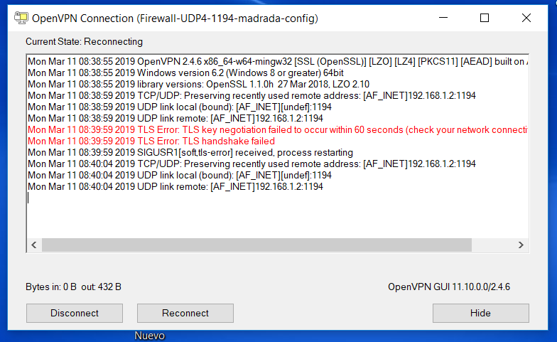

              The OpenVPN client, look likje this. I have out bytes but no in:

                You need to put your public IP in the OpenVPN client config file when testing from the Internet.
                Because your pfSense WAN is RFC1918 private network the export wizard put 192.168.1.2 in your client config which of course is not routed in the Internet.
                So open your .ovpn file with Notepad++ for example and replace
                remote 192.168.1.2 1194 udp
                with
                remote 1.2.3.4 1194 udp
                1.2.3.4 = your public IP
                -Rico
