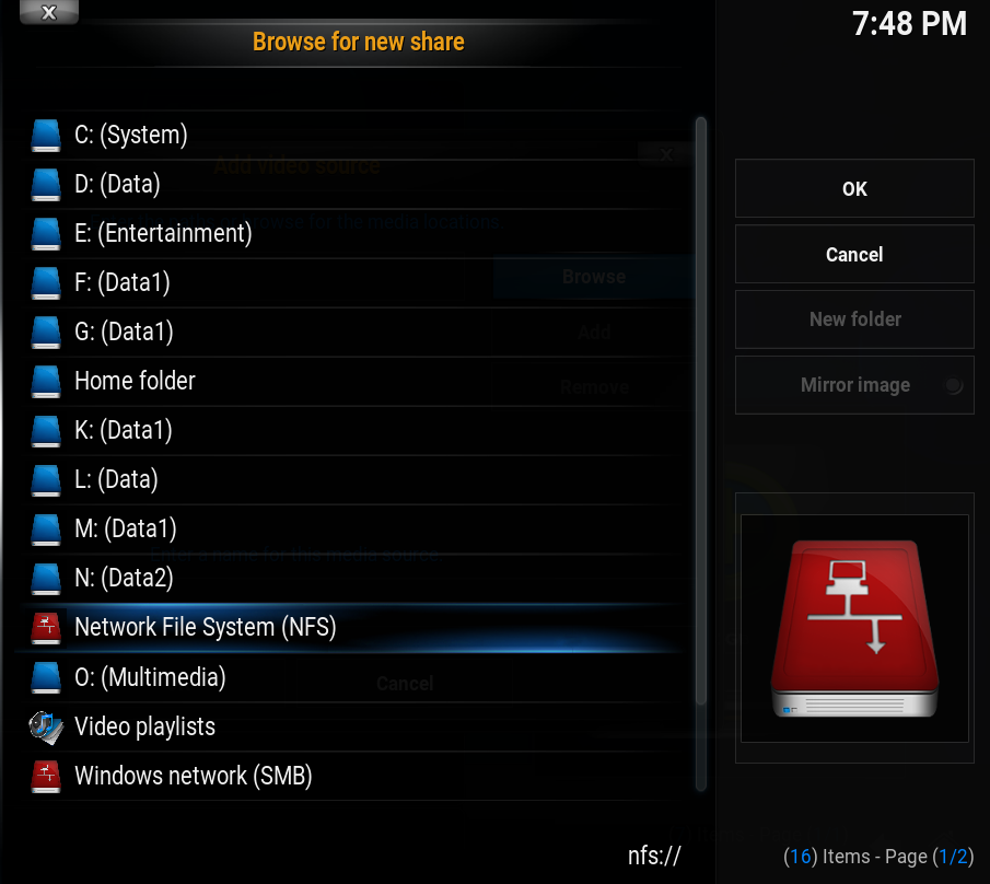

                                    Hi Guys,
                                    Thaks for all the info you providing. I will start reading and learning tomorrow and see you then same time next year 🤣
                                    On my raspberry PI's I have installed LibreElec (Just Enough OS for Kodi). I show you a screenshot how I browse for nfs shares. The screenshot is made on a Windows computer in my VLAN10. So forget the drive letters you see.
                                    I can click and click, but it won't show shares. On VLAN1 it works like a charm.

                                    • johnpozJ Online
                                      Well you should get on their forums and ask them how that works... I have no idea, don't use it - its not related to pfsense in any way at all.
                                      And has zero to do with vlans, etc.
                                      But lets be clear how did you setup the server sharing the NFS... you now moved your client to another network... its quite possible the firewall on the other server is just not allowing you..
                                      Why not just drop to a cmd line and do a showmount -e IP..

                                        • GrimsonG Offline
                                          Grimson Banned @johnpoz
                                          @johnpoz said in Browsing nfs share in other VLAN not working.:
                                          It's mainly using mDNS/DNS-SD with Avahi.
                                          • johnpozJ Online
                                            Yeah you could/might be able to get it to work across your L2 if its using that mode of discovery, if your NFS server is publishing it..
                                            That is what is broke with this software... Why don't you just directly map your nfs?
