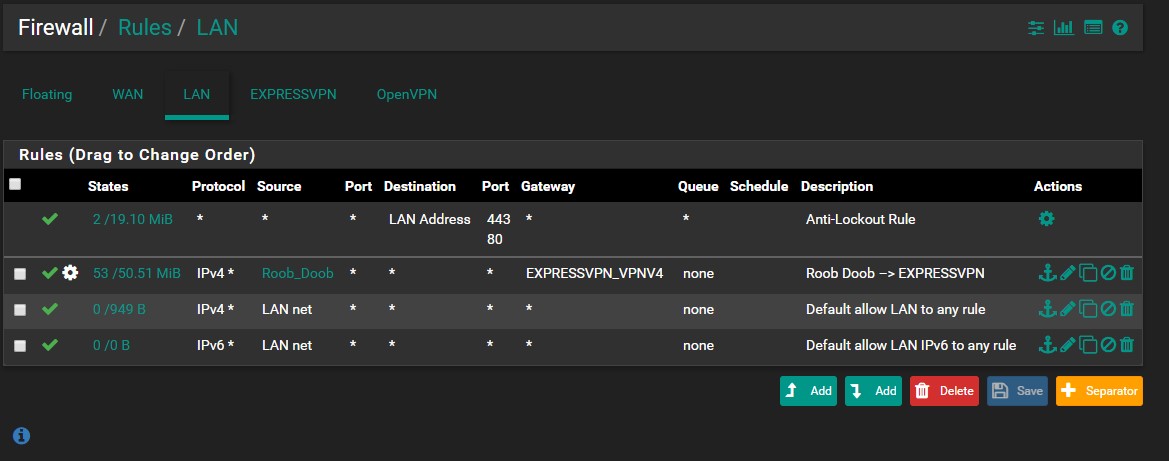

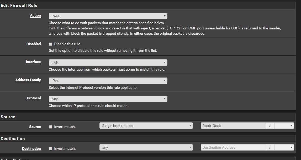

@bcruze I already contacted expressvpn and they wont give me their dns server addresses. Another question, in the 3rd picture I have posted is that where I setup the static mapping?

@nogbadthebad this is what it currently looks like.

Looks fine, I answered the post on my mobile just saw the dhcp lease page, that made me assume that you were changing the default gateway in the DHCP section.

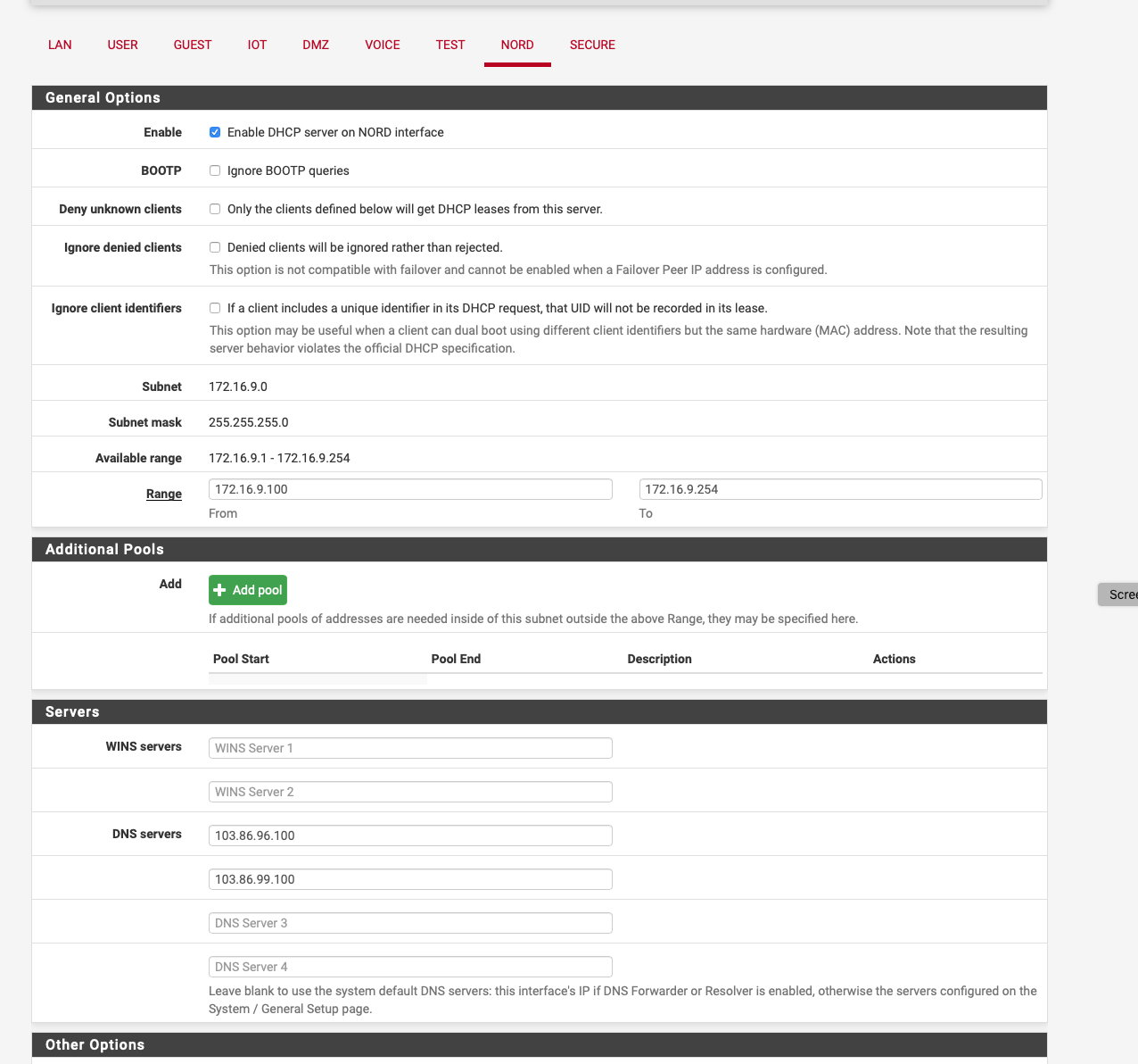

I use NordVPN and they document their DNS servers so I hard code that in my DNS settings for the NordVPN only subnet.
