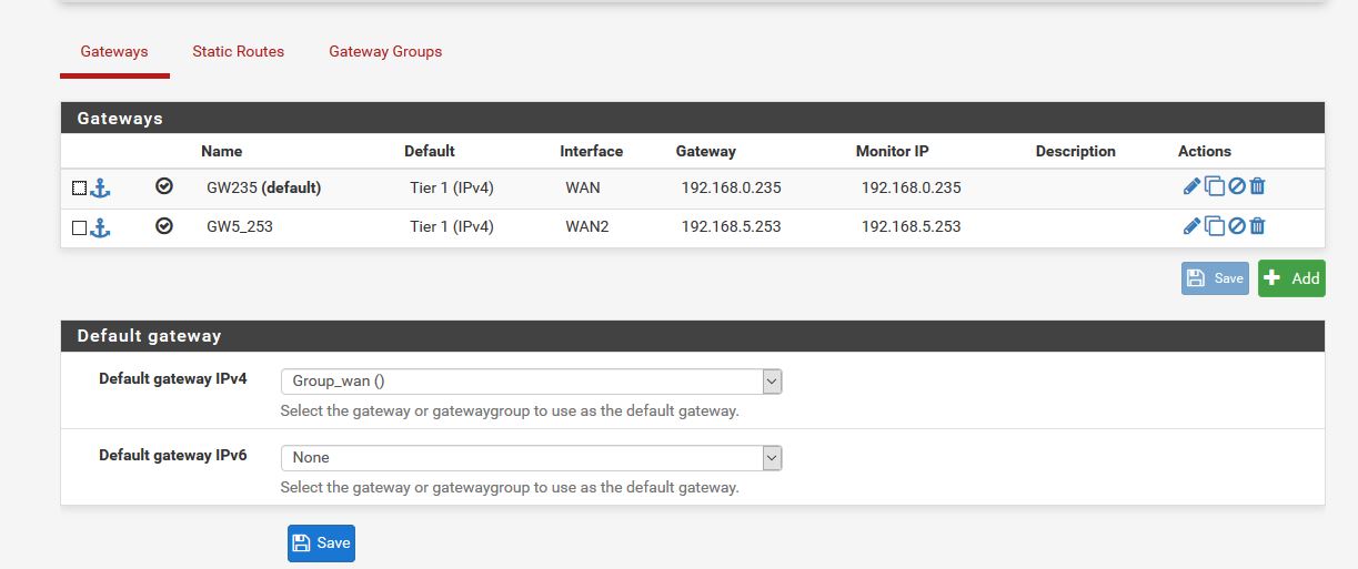

                      Do you have DNS servers on both WANs and the service in forwarding mode?:
                      https://docs.netgate.com/pfsense/en/latest/routing/multi-wan.html#dns-considerations
                      Or the failover group set as the default gateway which will allow it work in resolving mode?
                      Edit: Ok I see you have 'group_wan' set as the default gateway. Is that the load-balancing group? If so that's invalid, you can only use individual gateways or failover groups there.
