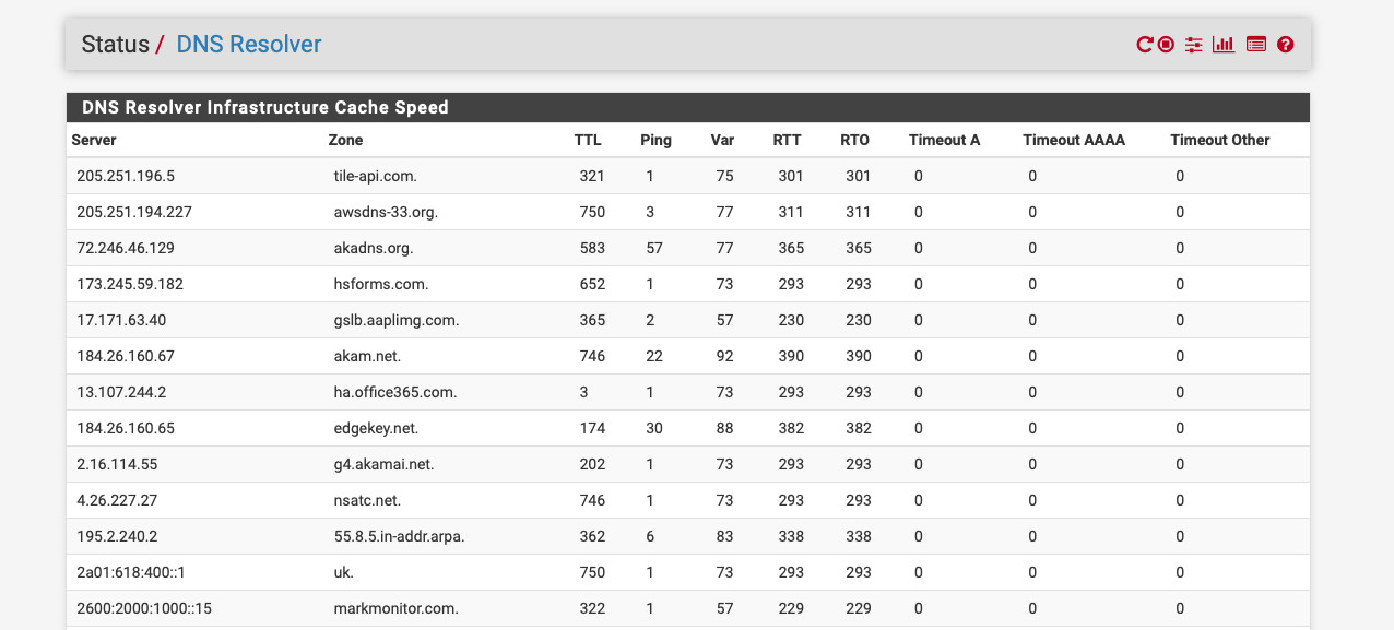

              Andy
                If your not seeing status there, then its not asking anything.. You sure your actually using the resolver - and don't have your clients asking someone else? Did you point pfsense to something other than 127.0.0.1?

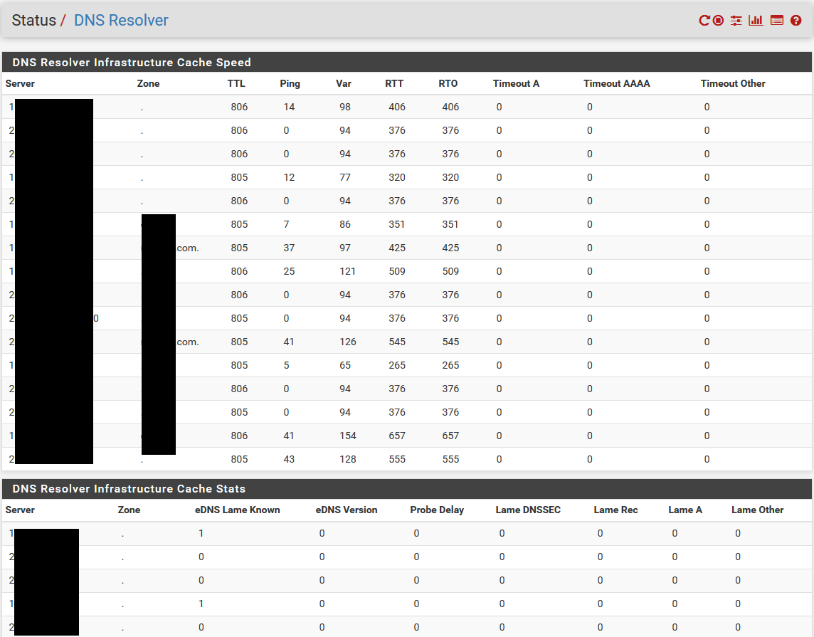

                      OK, so data is there after reboot (and then some...). Still Resolver mode.
                      Around 475 lines in each section (Speed and Stats). Both IPv4, IPv6 addresses... Running only IPv4 here. Sorry if I'm being dense.0_1552502264304_Speed-Stats.txt

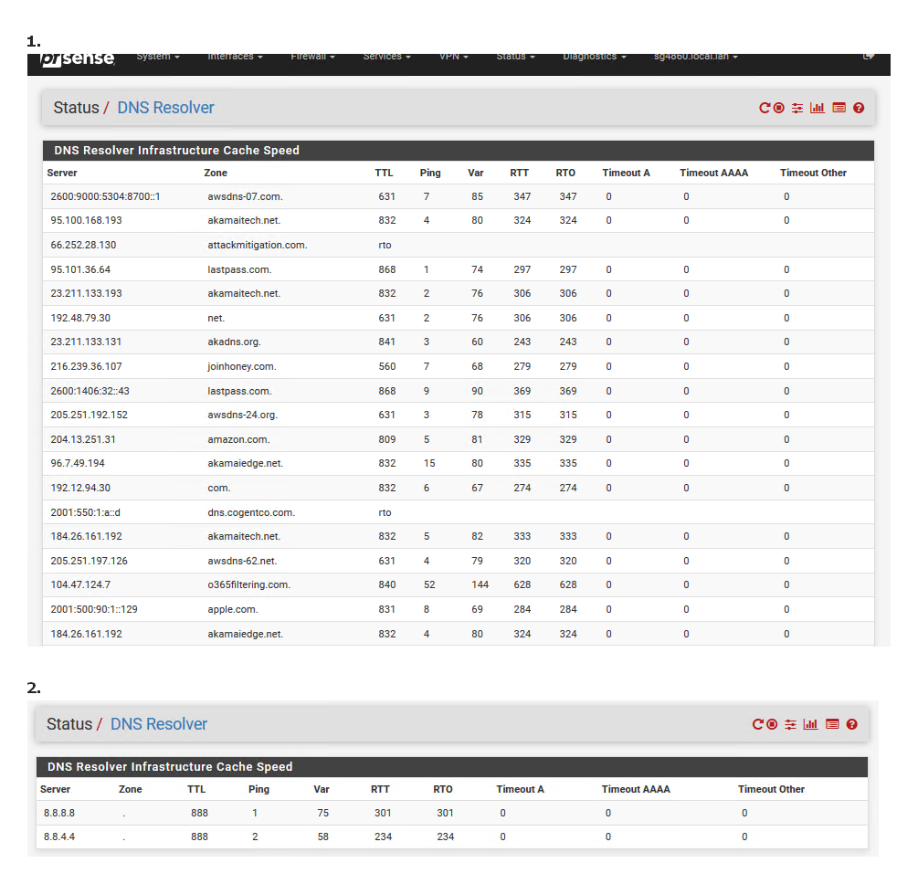

                            Here resolver mode.., changed to forward mode google, stats
                            Its not freaking rocket science here people
                            Your typical user is going to have ZERO understanding of what those stats even mean to be honest ;) Anyone that would actually want/need them would be able to pull them from the cmd line anyway..
                            Now back to resolver mode because forwarding = uuuuggghhhh!

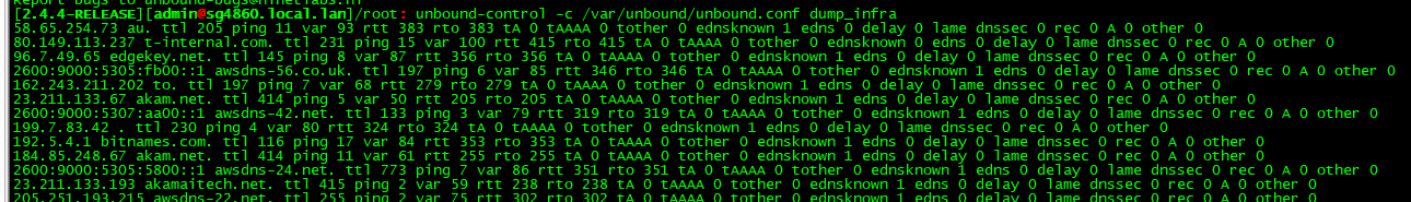

                                        Here is from cmd line
                                        All the web gui does it take the output of that and present it..
                                        No unbound is not going to wipe that data on any sort of schedule.. This the data it uses to know which NS are best to talk to, etc.
