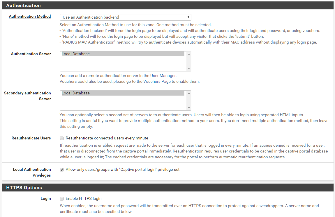

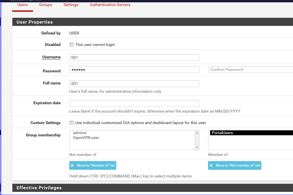

                    From scratch (just after installing pfSense) it takes a couple of clicks - add to that : add a user with portal rights (see image bellows)

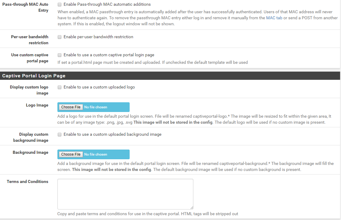

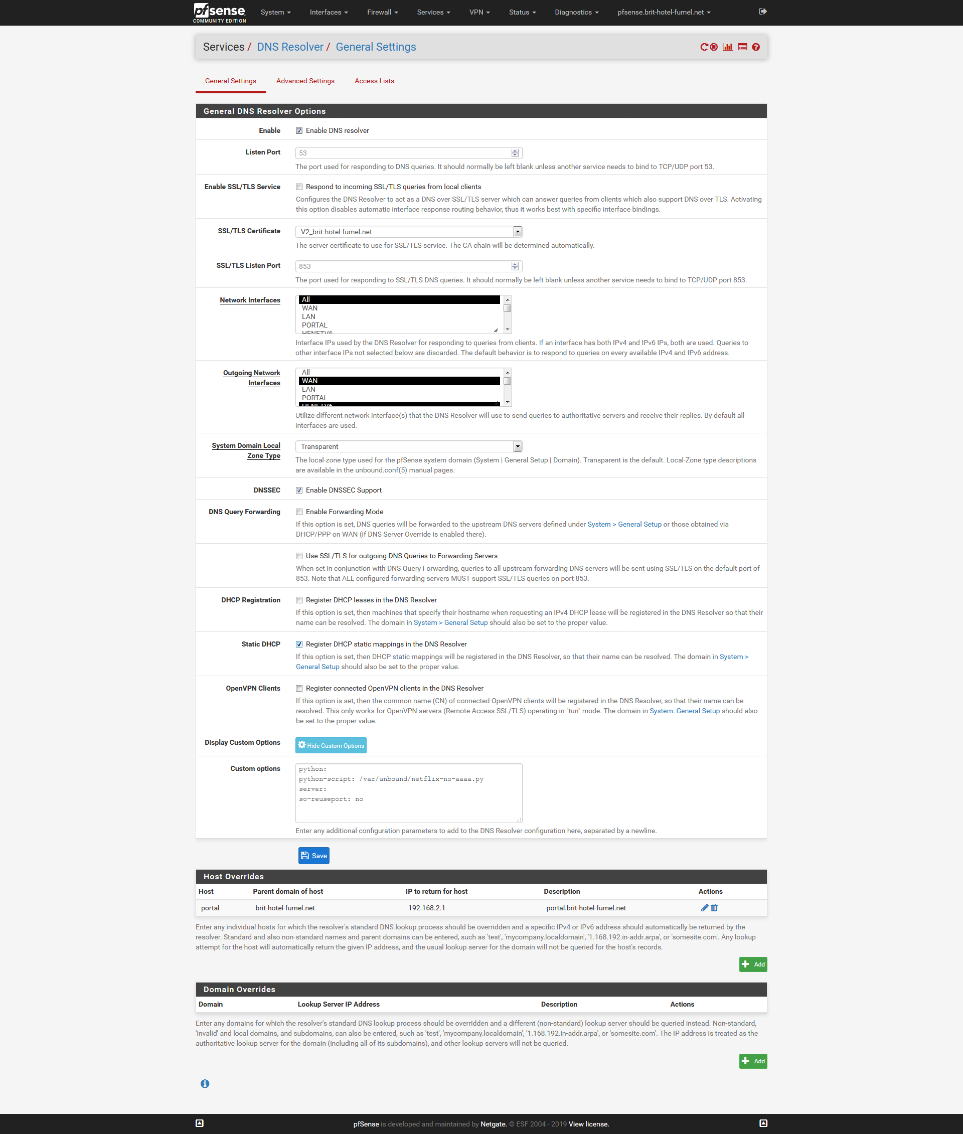

                    My captive portal settings are :
                    Please note :
                    I have use a dedicated interface called "PORTAL" for my Captive portal users. It has these IP settings : 192.168.2.1/24 - The build in pfSense DHCP server is running on this interface - IP range 192.168.2.10 -> 192.168.2.254
                    I use https login. This means I have to supply a certificate. The ACME package handles that for me. Not really need when you start, but very complicated to setup so I had to have one just for the kick of doing so.
                    I use the freeradius authentication package (with a remote SQL database somewhere on my LAN), which is just great if you really have nothing else to do with your time. In the beginning, the local, build in User manger works just fine.
                    I did upload a home made captive portal login page so I could add the company logo and other types of humour.

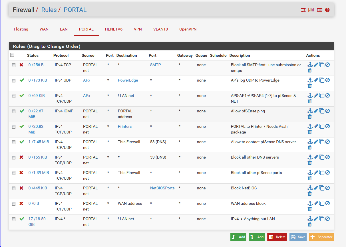

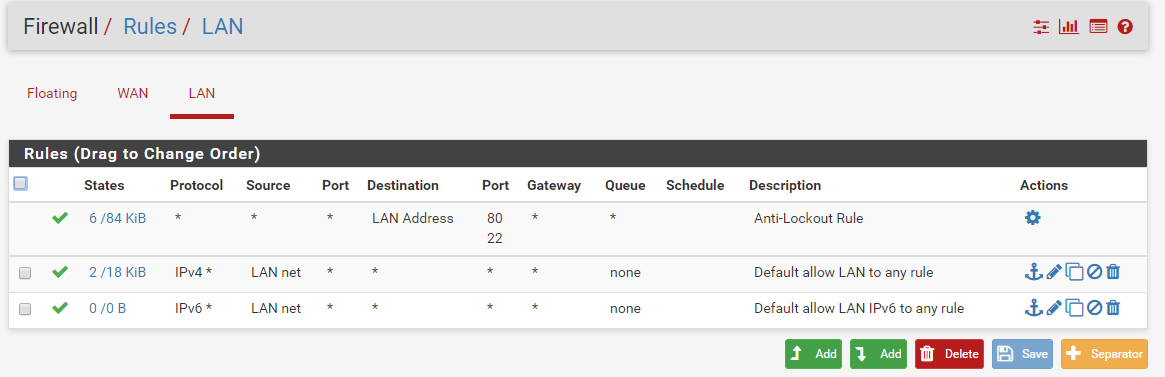

                    My firewall rules :
                    Every rule here has it's own special function.
                    You'll be fine using the default pass all rule, like this one :
                    And the most important one :

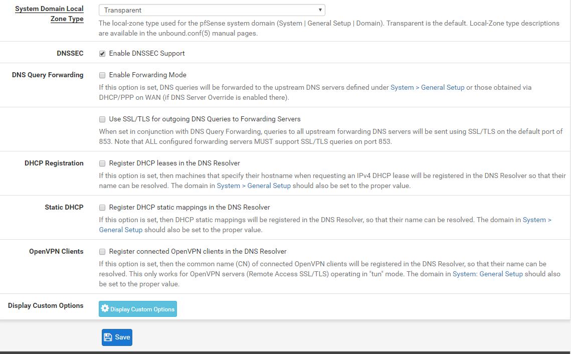

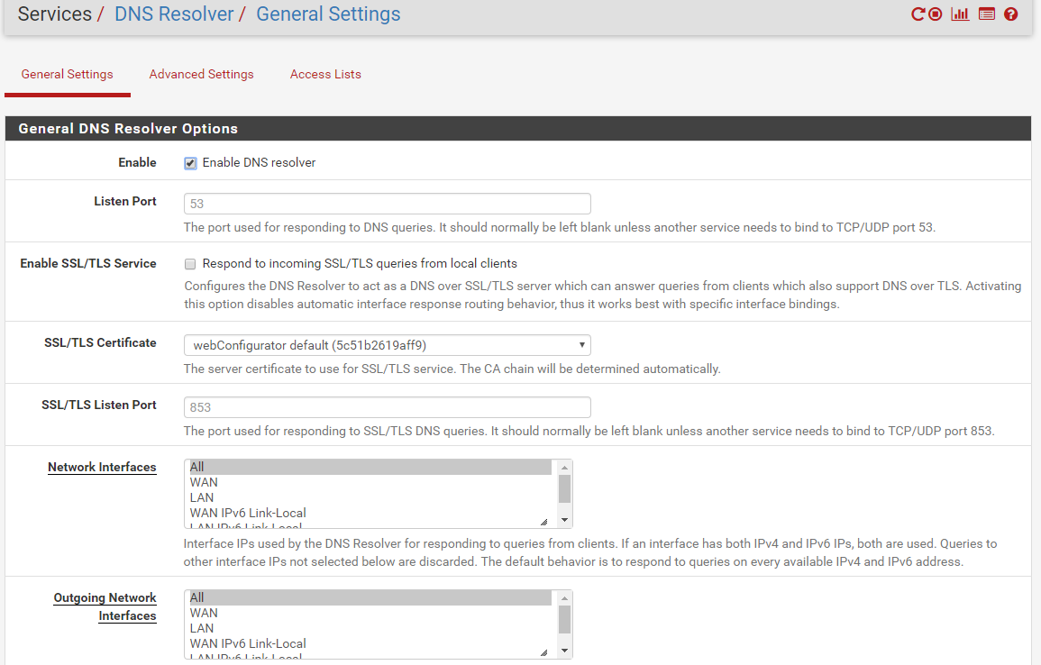

                    DNS settings :
                    I did not change anything on the ACL and Advanced tab.
                    As you can see, I use the default Resolver - and I'm Resolving - I'm not forwarding.
                    Also important :
                    Dashboard :
                    DNS Servers = 127.0.0.1 - nobody else.
                    edit : forgot about this one : I'm using some DD-WRT based AP's .... using pure AP mode, no DNS/DHCP/Router functions enabled on those ones. Just plain AP mode.

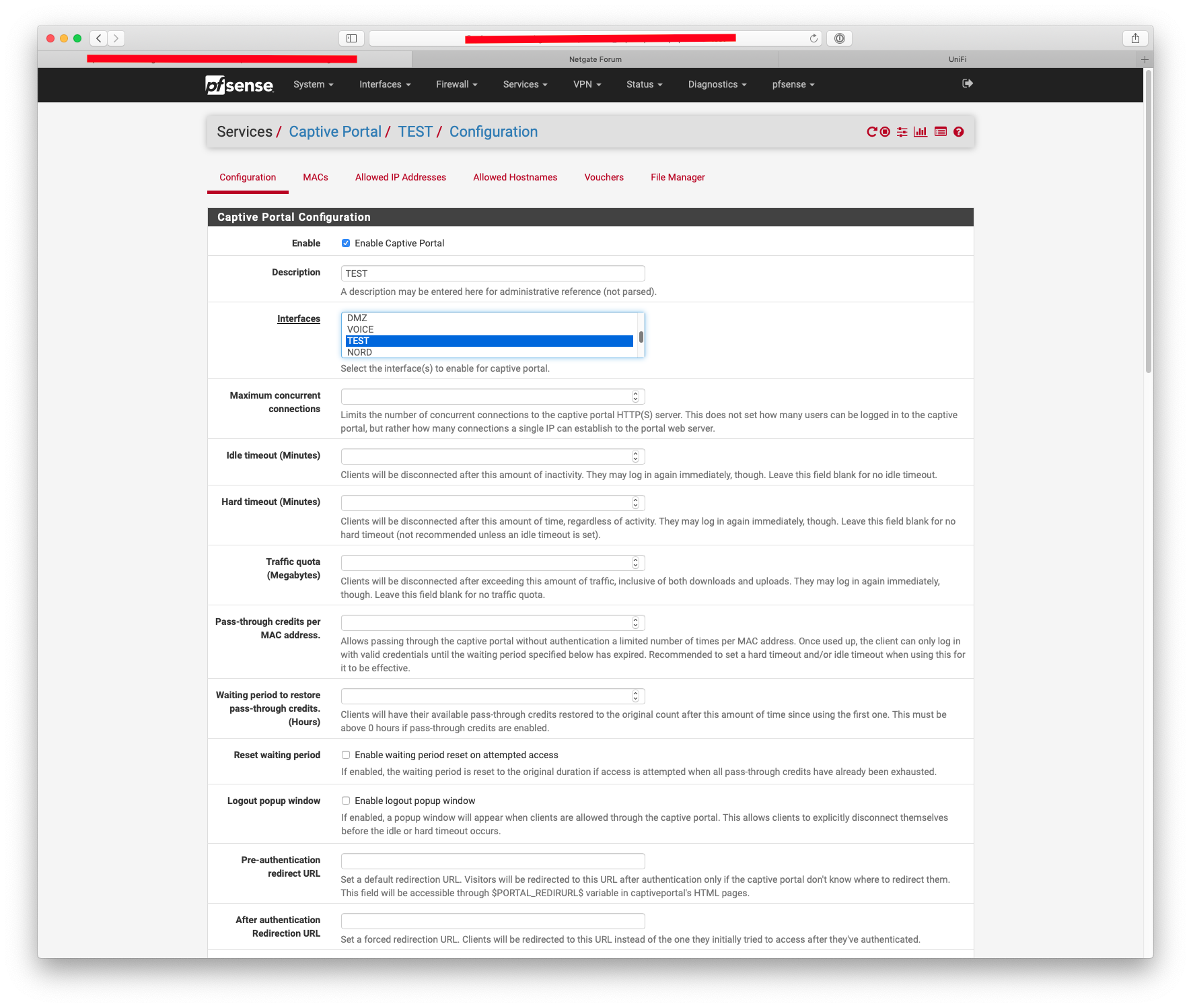

                    • NogBadTheBadN Offline
                      NogBadTheBad @curioushuman
                      @curioushuman said in pfsense does not work on mobile phones (iOs and android):
                      @nogbadthebad how did you configure? Did you configure anything on pfsense captive portal?
                      Nope just enabled it and set it to use my RADIUS credentials.
                      NB I don't use captive portal, just tried it to see if I got the login page.
                      Andy

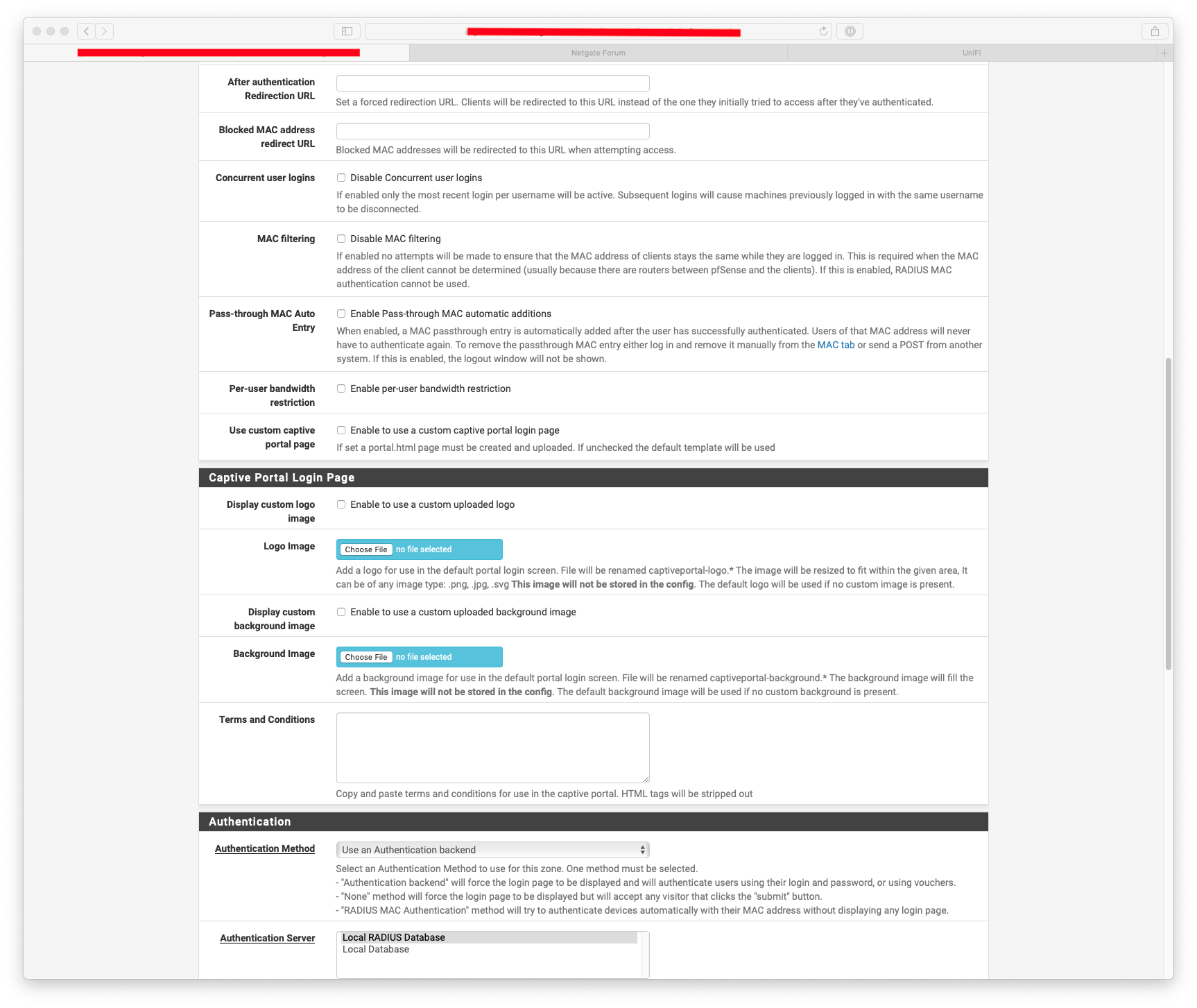

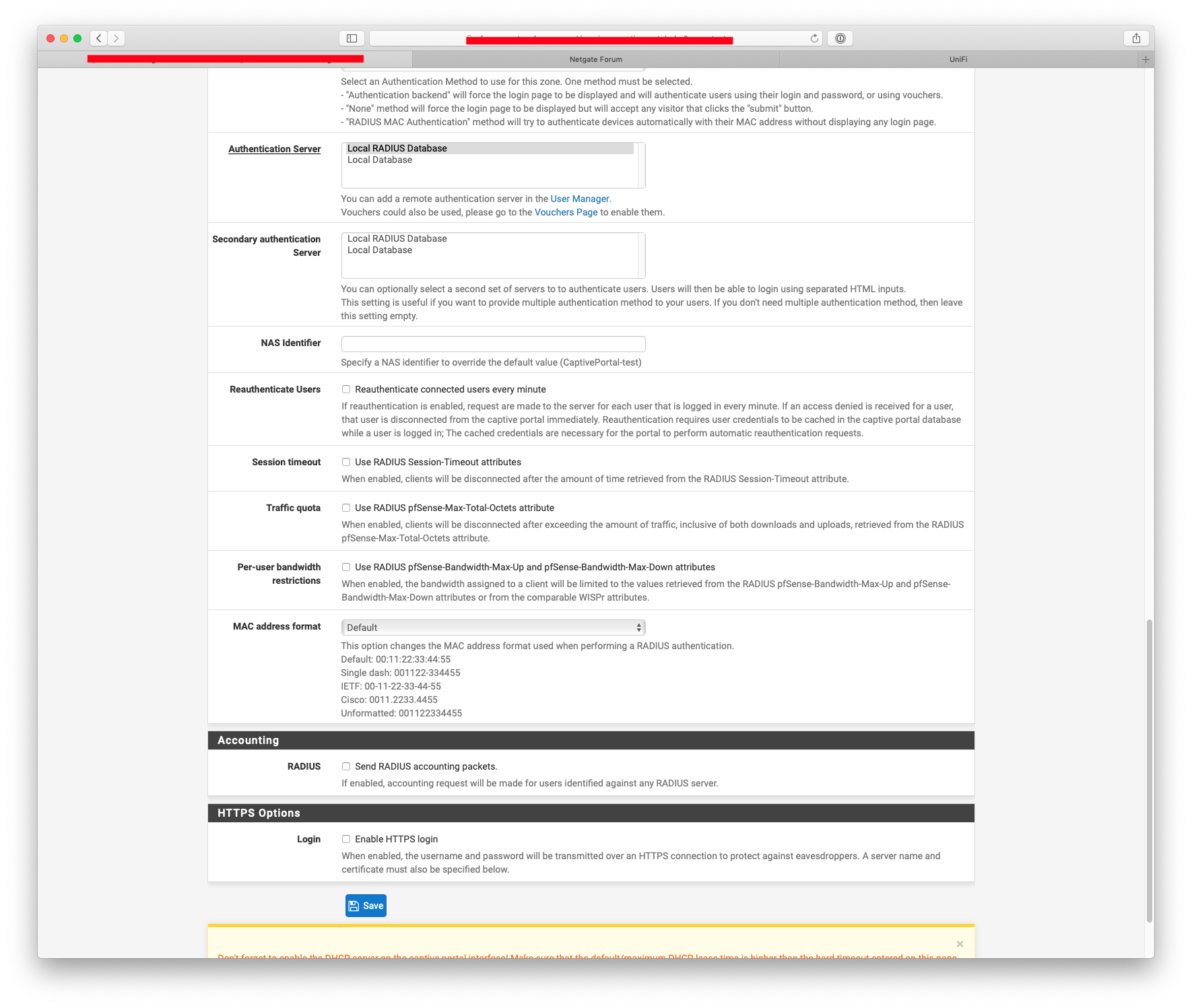

                        curioushuman @Gertjan
                        @gertjan Here''s how my configuration looks like: (see images below)
                        9_1552525574248_10.PNG 8_1552525574248_9.PNG 7_1552525574248_8.PNG 6_1552525574248_7.PNG 5_1552525574248_6.PNG 4_1552525574248_5.PNG 3_1552525574247_4.PNG 2_1552525574247_3.PNG 1_1552525574247_2.PNG 0_1552525574247_1.PNG
                        And my simple setup:
                        I am using voucher authentication. No user manager.
