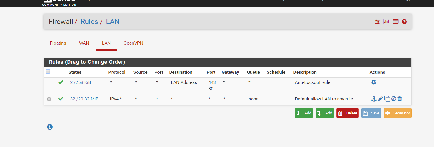

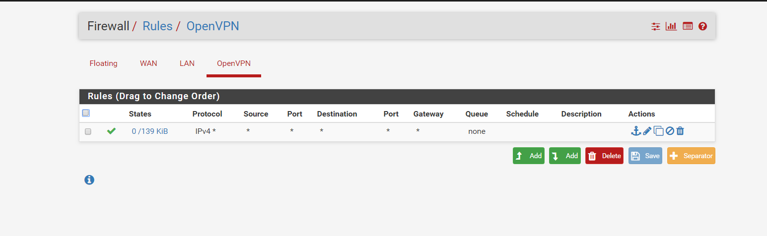

      Firewall rules Site B

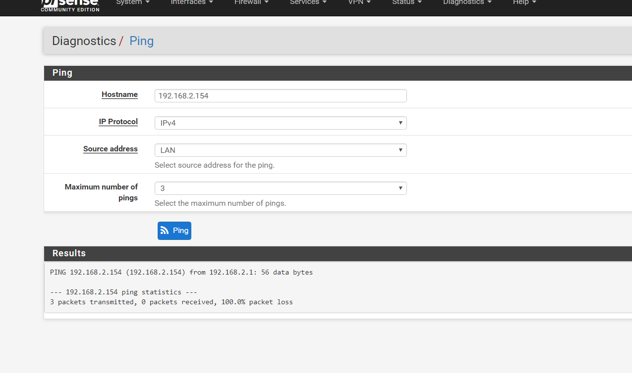

      The problem i think is with the Pfsense box B as if i try to ping a pc from pfsense B i get no ping, it looks like PFsense at b site cant see any pc on its lan network. I can ping Pfsense b from 192.168.2.154 but not the other way.
      Can it be the outbound nat so have a problem so do as Pfsense site B cant ping anything on its lan?

            Turned back to Auto outbound nat and restarted the pfsense box but i still can not ping clients on lan site from the Pfsense box site at site B (192.168.2.1) to any clients at 192.168.2.0/24. It still looks like the pfsense boc dont see clients on the lan adapter.
            From site B i can ping other clients and the pfsense box but not from the box and to the lan so i gues her the problem is.
            This is a box so was used earlier as the main firewall so was reset, can there be some old config so has not been proper reset?
            is a reinstall of the system a good idea ? as for me i cant see why the pfsens box can not ping any clients on its lan adapter.

              For testing i did reinstalled pfsense and changed lan ip to 192.168.2.1 and conencted it to a switch and one pc. And still it can not ping clinets on the lan network from the pfsens box but the pc can ping the pfsens box. when pfsens is fresh installed it shall be able to ping clinets on lan net ?
              can it be a broken network card ?
