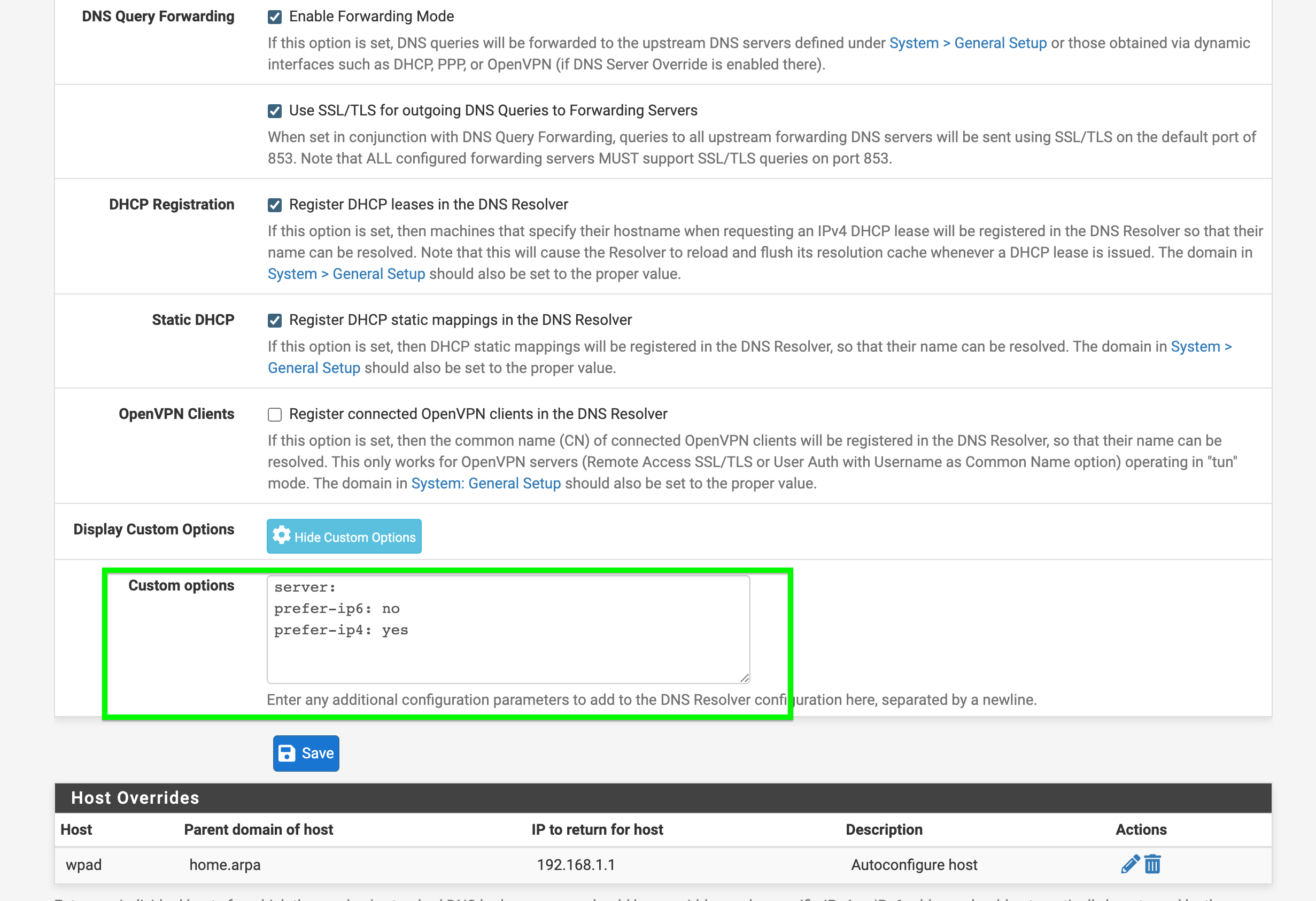

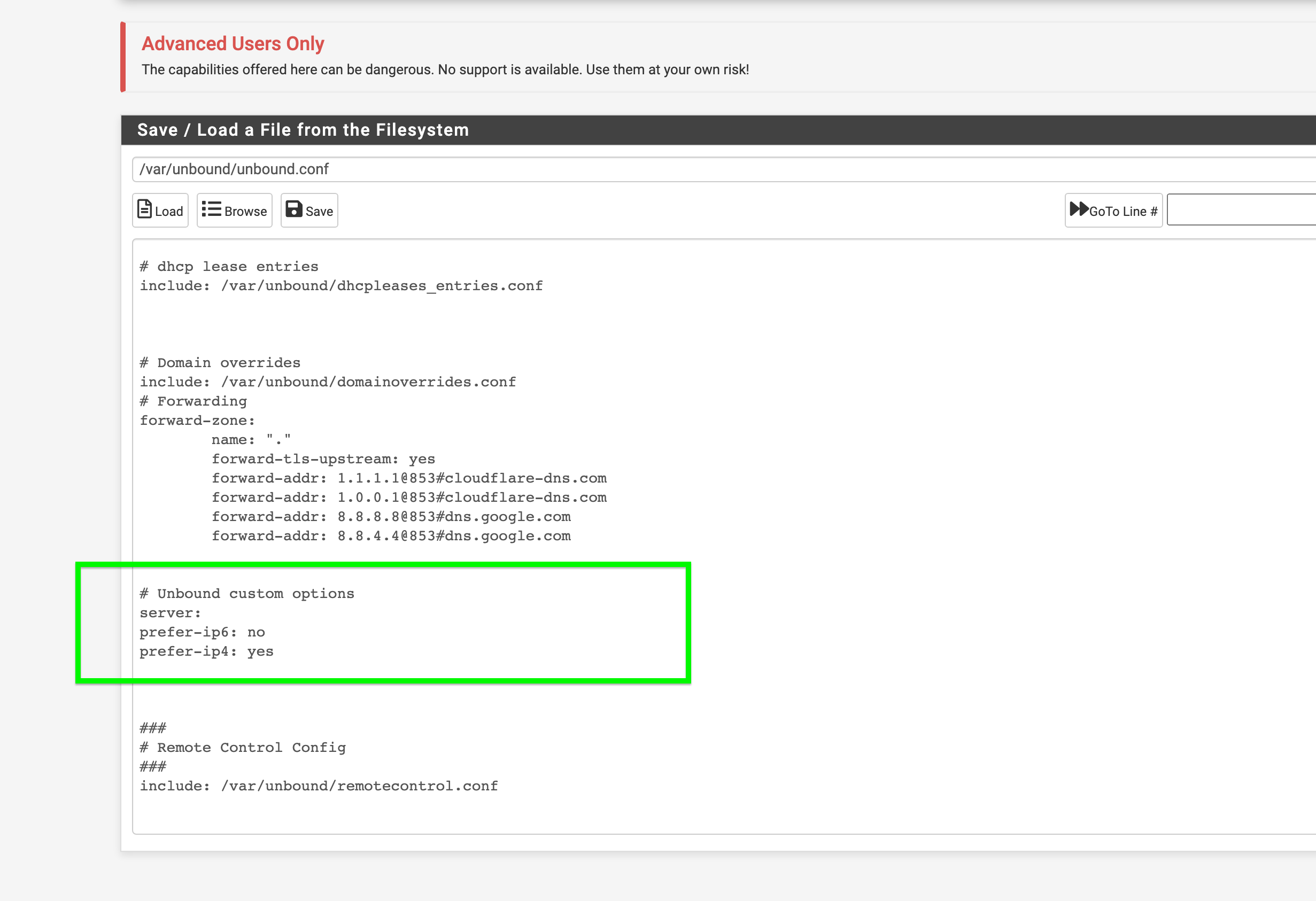

                                Have you also attempted to custom option in unbound.conf for DNS responses I have an ISP that only provides IPv4 I do not want to use HE tunnel.
                                 "*do-ip4: <yes or no>
                                          Enable or disable whether ip4 queries are  answered  or  issued.
                                          Default is yes.
                                   do-ip6: <yes or no>
                                          Enable  or  disable  whether ip6 queries are answered or issued.
                                          Default is yes.  If disabled, queries are not answered on  IPv6,
                                          and  queries  are  not sent on IPv6 to the internet nameservers.
                                          With this option you can disable the IPv6 transport for  sending
                                          DNS traffic, it does not impact the contents of the DNS traffic,
                                          which may have ip4 and ip6 addresses in it.
                                   prefer-ip4: <yes or no>
                                          If enabled, prefer IPv4 transport for sending DNS queries to in-
                                          ternet  nameservers. Default is no.  Useful if the IPv6 netblock
                                          the server has, the entire /64 of that is not owned by one oper-
                                          ator  and  the reputation of the netblock /64 is an issue, using
                                          IPv4 then uses the IPv4 filters that the upstream servers have.
                                   prefer-ip6: <yes or no>
                                          If enabled, prefer IPv6 transport for sending DNS queries to in-
                                   do-udp: <yes or no>
                                          Enable  or  disable  whether UDP queries are answered or issued.
                                          Default is yes.
                                   do-tcp: <yes or no>
                                          Enable or disable whether TCP queries are  answered  or  issued.
                                          Default is yes*" (nlnetlabs nl).
                                add server: first to let me add anymore lines after. Just like when you enable logging
                                "Logging:
                                server:
                                log-queries: yes
                                " (Docs Netgate).
                                Same needs server: first
                                "dns64-ignore-aaaa: <domain name>
                                List domain for which the AAAA records are ignored and the A record is used by DNS64 processing instead. Can be entered multiple times, list a new domain for which it applies, one per line. Applies also to names underneath the name given
                                " (unbound docs).
                                So for me ipv4 prefer and other custom options. . .
                                server:
                                do-ip4: yes
                                prefer-ip4: yes
                                do-ip6: no
                                prefer-ip6: no
                                dns64-ignore-aaaa:
                                Ref:
                                https://docs.netgate.com/pfsense/en/latest/troubleshooting/dns-queries.html
                                https://nlnetlabs.nl/documentation/unbound/unbound.conf/
                                https://unbound.docs.nlnetlabs.nl/en/latest/manpages/unbound.conf.html

                                        What is the goal here, if its just to turn off IPv6 - do that.. If pfsense has no IPv6, then clients wouldn't have IPv6. If the goal is to just prevent unbound from handing clients answers to AAAA that is a simple one line in the custom options
                                        private-address: ::/0 # filters out all AAAA !
                                        If you don't want unbound to use IPv6 to do its resolving, then just set this in the custom options box of unbound
                                        do-ip6: no
                                        Do both if you want.

                                            @johnpoz what about this custom dns resolver setting. . .
                                            server:
                                            do-ip4: yes
                                            prefer-ip4: yes
                                            do-ip6: no
                                            prefer-ip6: no
                                            dns64-ignore-aaaa: * . *
                                            do-not-query-address: ::
                                            do-not-query-address: ::1
                                            do-not-query-address: ::/0
