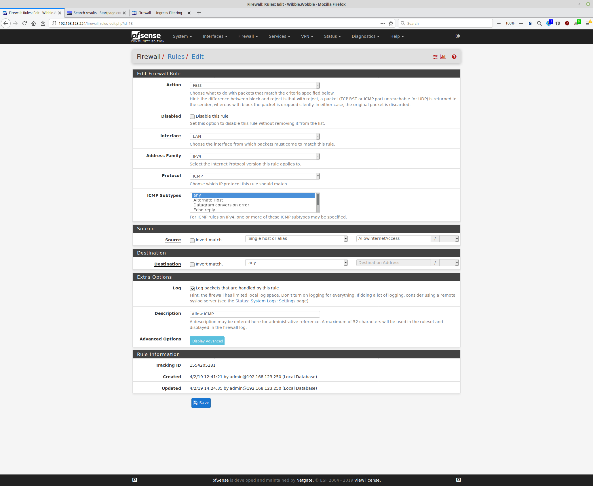

      I hope the learned brethren will forgive me if I am being “thick” (quite likely) but I am struggling to create a rule (that works) to allow outbound ICMP from my LAN to the Internet.
      For Egress Filtering purposes I have set a default deny all (as the default final rule) from my LAN and have setup specific allow outbound traffic rules e.g. allow 80/443/53 which work fine.
      I want to be able to “ping” and use “traceroute” to external sites and have created a specific rule to allow this. (see below)
      Having created and applied this rule on the LAN interface I can now successfully (as expected) “ping” external sites from a internal network client (192.168.123.250) via my pfsense firewall (192.168.123.254)

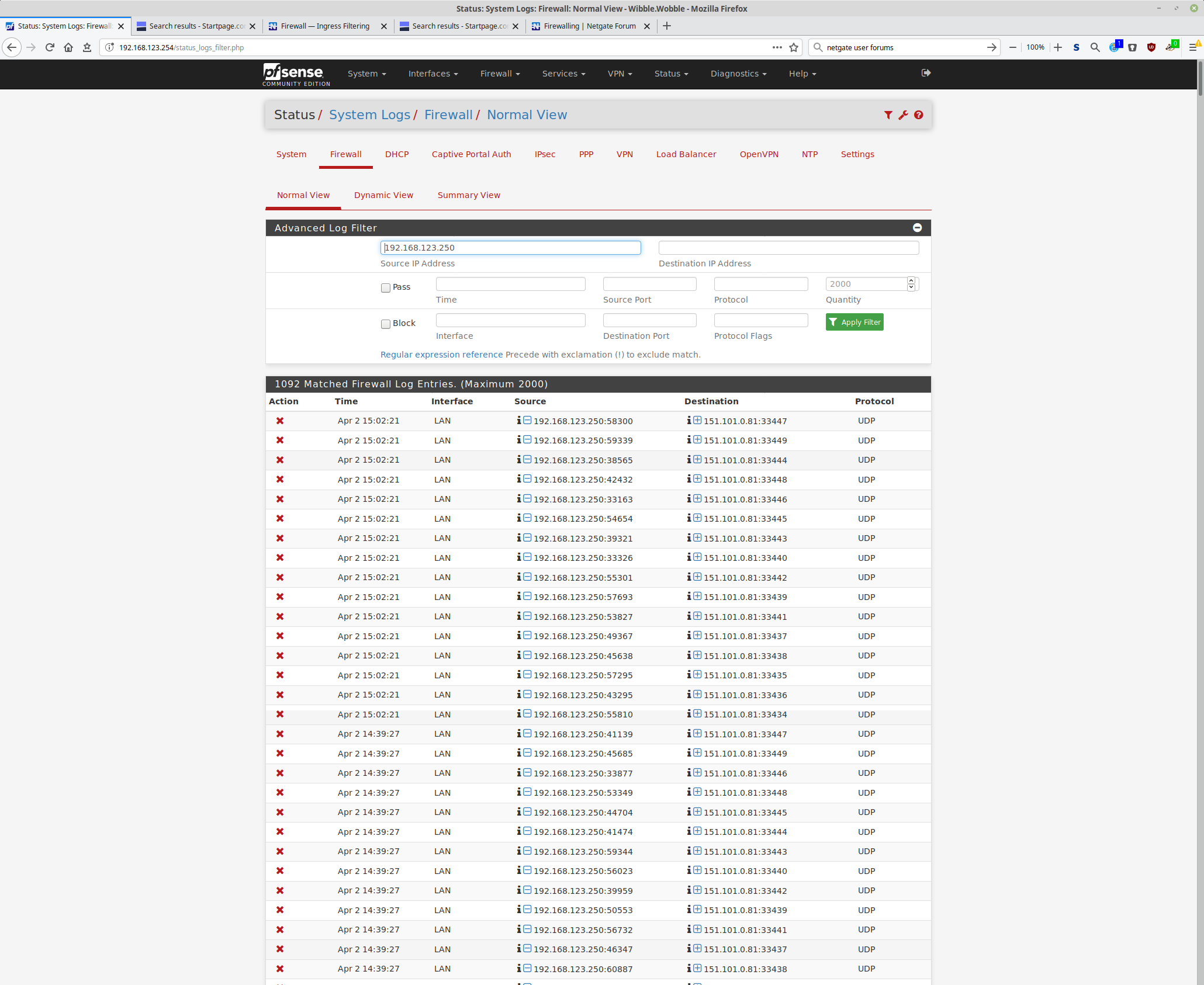

      Undertaking a simultaneous packet capture on the firewall shows multiple UDP packets blocked

      and my Firewall Logs show multiple blocked UDP packets destined for the subject traceroute target site blocked (see below).
      I have a number of firewall LAN rules configured, so to eliminate this issue being caused by a prior rule I have tried ordering this ICMP allow rule at the top of the tree but without success.
      Disabling the Allow ICMP firewall LAN rule (as expected) stops "ping" working externally, but I am at a loss as to why traceroute is not functional.
      I would be most grateful if anyone could review the above and see if they can identify what I might be doing wrong.

        @farrina said in Unable to "traceroute" externally (firewall rule has been created):
        However when I try a traceroute it appears to to pause at the firewall (I am using Linux Mint 19.1 as the client)
        Well there is your answer, the traceroute binary on your Linux distribution is using UPD instead of ICMP for the traceroute. Check it's man page to see if there is a option to use ICMP or use a different traceroute binary. Do some RTFM for Linux Mint.
