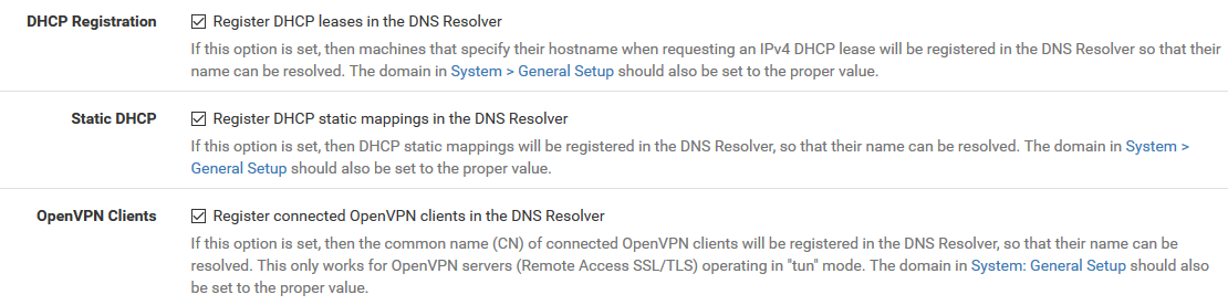

      @johnpoz said in DNS Resolve Domain Overrides do not work after pfsense restart:
      well yes register dhcp will restart unbound.
      Ok. Any ideas why the service stopped suddenly though? This is the first time, in many years, that I had unbound stopped without me doing anything.
        because there was a new dhcp lease/renew or a vpn client.. If you have it register clients (other than static) then yes unbound will be stopped and restarted now and then.
        If you don't want that to happen then don't have dhcp clients registered.. I don't really get why you need to do that - how many clients you have? Just setup reservations for those that you "need" to be able to resolve name of.
          I understand but this time it stopped indefinitely (since this morning) until I went it and saw that the service is stopped. I've had those settings since a few years ago and never had the service stopped. I understand that it restarts if you have dhcp register enabled, but it shouldn't stay stopped.
