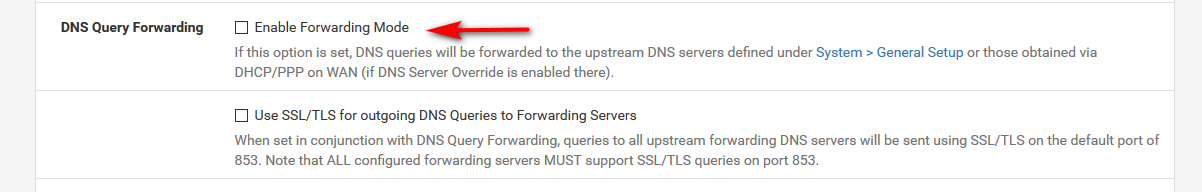

@johnpoz Hahah. Yes. I saw your previous message ;p. I understood the forwarding mode does not require me to do anything.
So... The only way to get DNS over TLS for me would be to forward all my requests to DNS servers that accept it such as Cloudflare ones?
If you want to use dns over tls, then yes you have to "forward" to a dns provider that supports it. You can not resolve over tls.

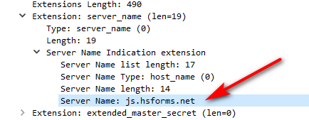

Keep in mind that if they really wanted to spy on you, they can just look to see what is in your http headers for where your going.. And even if using https, the sni is going to contain where you were going, simple enough to look in the client hello packet and see where you were going..
No need to sniff the dns ;)
If you think hiding your dns queries prevents your isp from knowing where your going.. No! All it does is make it a bit harder..

However, do you think it would be a problem to activate DNS over TLS with my current configuration (means no forwarding mode activate). It will create unnecessary traffic as you stated and will only do DNS over TLS with servers that accept it, isn't it? Will it nevertheless be working? Will it be useless though?
Thanks,
Its only a couple of clicks to get dns over tls working in pfsense and unbound...
If you want to do that you HAVE to forward!!
Its not like unbound can ask every NS it has to talk to to find what your looking for if it supports tls, and if not just query over normal udp 53..

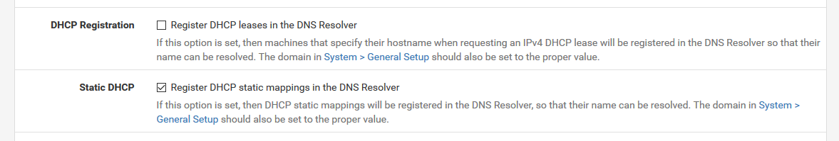

I have about 80 clients at home (Google home, smartphones, etc.) where 10 of my clients such as my Synology NAS, smart switches, and access points are on static ips. Are you talking about this or about DHCP related to DNS?When you check "DHCP Registration" in the the Resolver setup page, every new lease that comes will get inserted in the DNS cache. This way you can address that device with it's name instead of its IP.
To do this, the DHCP server process (actually, a sub program, called dhcpleases) will signal unbound the resolver. This is done by a restart, so unbound will re read all its config files again.
Unchecking DHCP Regsitratio stops the unbound restarts related to new DHCP leases. -

Bring on encrypted SNI!
@stephenw10 sorry Steve. I do not know what you are talking about hahaha
Its an up and coming protocol so that as you saw in my posted client hello you could easy see the fqdn connecting too.. With encrypted sni, you will not be able to do that ;)
https://blog.cloudflare.com/encrypted-sni/
To be honest only and when that is actually common does it make any sense to try and hide dns. Until then - hiding your dns is more like when small child closes their eyes and think you can not see them ;)

@skalyx said in Big DNS Problems *Illustrated*:
EDIT: I just looked into DNSmasq and it looks like it is enabled by default when forwarding mode is activated.

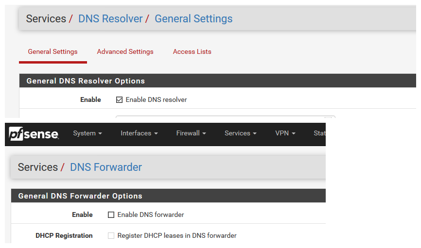

OMG no it is NOT!!! There is forwarder and there is forwarding in unbound... So your using dnsmasq as your forwarder and not unbound in forward mode.
If your using the forwarder then your NOT doing dns over tls..
UGGHHH... sorry but this thread has gone for way to long.. With zero being done other then you say it works, it doesnt' work.. Can not make heads or tails of what your actually doing, etc..
Deactivating "Register DHCP leases in the DNS Resolver" and using forwarding mode seem to have fixed my problems
And if your using the "forwarder" dnsmasq the settings in unbound have ZERO to do with anything...
Which do you have enabled? Unbound or Forwarder?
This is unbound in forward mode
